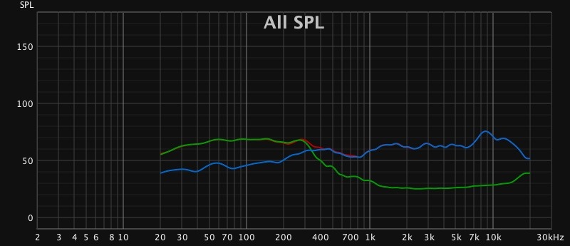

I was finally able to find the time to get my SLOBs up and running. I am using the Lii fast8 for the full range, SB bianco 150B350 woofer for the slot. I am using a MiniDSP 2x4 HD to handle crossover and eq for the time being. The fast 8s are being driven by ACAs, and the Bianco by a Emotiva A-150 75w amp. Below is the initial measurement with no eq. The UMIK was at ear height, 1 meter from the baffle.

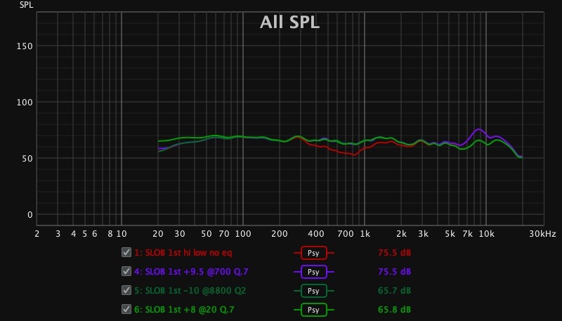

Crossover set at 80 hz low pass, 160hz high pass. Not too shabby right out of the gate, but that peak around 8k was noticeable. I pulled down the peak at 8800k and pushed up a little at 700hz and got pretty flat. I also boosted at 20hz a little because well, why not.

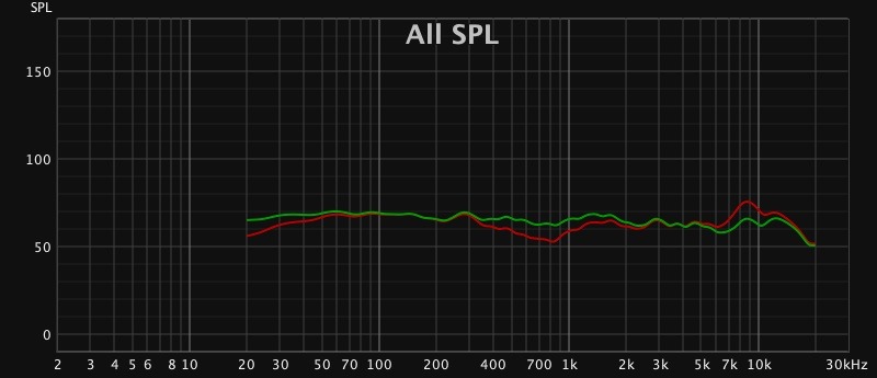

Here is the final curve versus the original. Made for a great listing session. I am really surprised at how good these sound with minimal correction. I will probably play with the eq a little, but for now I am really happy. A big thanks to Nelson for this project! This really beats my other speakers, and at a fraction of the cost.
