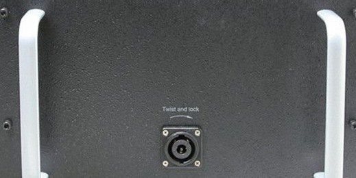

The case with the UGS6 board has no transformer, the other one does.
Power connection between the two is with 32 Amp twist-lock powercons (3-pole)
What does that tell you ?
Not the question I asked you.
He is either bringing AC into the main case(unlikely I think) or its floating, is my best guess.
Pffff.
3-pole powercon for the amplifying top case means DC.
aka the 40 power devices in the bottom case are not part of the output stage.
Don't have to be, why the bath-duck would anyone need more than 72 power MOSFETs in an 150W output stage for.
=> Power rail regulation. (Xs = X-Supply)

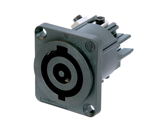

Are you sure thats not the 8 pole Speakon?
NLT8MP-BAG - Neutrik
nothing wrong with speakon range , with more contacts .......
