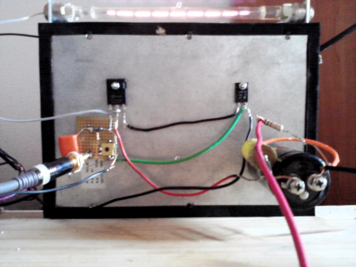

By the way this is how my JFET amp prototype looks like , this time with the light bulb .
The light bulb I believe is about 18 ohm or so .
It sound very good , probably better in my taste than the CCS version , don't know really .
The voltage now is 30 volts , and I am wondering how high it can be set .
thanks
thanks
Current through the JFet is 1.3 amps now .
Thanks Stefano. This is valuable information for me at the moment. Interesting, that you prefer the bulbs to the CCS. IMO generally less distortion is just the second step to enjoyable sound. The first step would be a "composition" of the involved amounts of particular non-linear distortion which generates a sound, that the brain is going to interpret as "approximately natural" or at least as "mostly charming". In other words: A composition, where the emergence of listening fatigue is mostly deferred.
So, why you shouldn't get "better" results with just the bulbs? The ear wants what the ear wants.

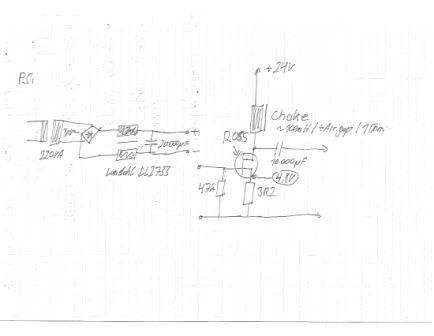

r085 question
after testing last evening the attached s circuit some questions
in this setup the r085 produces only 1,5W before clipping tried with lab supply different settings and a symmetric clipping was around 24V supply and 1,5Amps giving a output at 8 Ohms with 25Vss making some 8W
a first mono test sounded not so nice ( a lot of distortions when asking for higher levels without distortions maybe 0,5 W was possible)because the source was a emu dac with transformer output and with too high output impedance.
question-did anyone build the fig 7 in the delite articel-cant´t believe that this works with the 1Ohm source resistor-maybe papa can explain-any ideas to lower input capacitance?
the same setup but with a LL2733 in the source and drain to +24V gave no gain but my dac could drive it easily and it sounded very sweet on my altec 605
