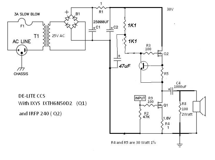

I built something quite similar using the IRFP240 throughout. Still playing nice, being fed by a surplus 24VDC/10A linear power supply. I am planning to add a 'soft start' in my next build to eliminate 'thumps' at start-up. Forum member Geek shows how to do it here, and I see no reason why it shouldn't work for schem posted in post 605. Or am I am missing something?
Something similar with all IRFP240 would be close to the original zen, wouldn't it?
Stefano, no reason it shouldn't work with IRFP044... if I recall correctly, the only difference there is lower max voltage. But we shouldn't be exceeding that limit here.
Infact it works. Last night I fired an IRFP240 in my P2P setup ; so I changed both with IRFP044 ...have a lot of them .They probably have slightly different Rds I guess ....
I thought you were replacing only the CCS FET with 044. You replaced both and it still works?
Doesn't the 044 need 4V of Vgs to get going? It would need a different bias arrangement that the 6N50D2.
O sorry for that: when I said both , it was the " stereo " set . To have 2 channels with the same current source . Same bias arrangement , same D fet in the lower part .

And it works . Thanks a lot . So I set R5 1,47 for now , if it is correct probably we can also rise the rail Voltage to 40 volts or so

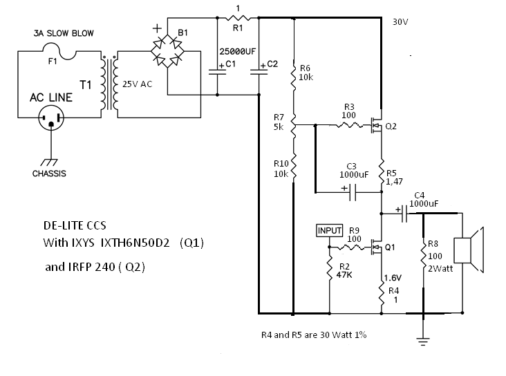

I finally got to building this amp with the CCS. It is working but the top end is coming out distorted. The bass and mid-bass sound wonderful, but the presence region (2k-5k) sounds awful and the absolute top is almost non-existent. I'm thinking this is because of the non-linear gate capacitance of the FETs.
The circuit is attached. Q2 is IRFP240 and Q1 is IXTH6N50D2. Supply at 30V, drain on Q1 is at 20V. I'm driving it straight from the CD player.
There is certainly more power, but the top end distortion is just too high right now. Any ideas?

I=Ube/R
in this case 3A=0V65/0R22
you can also try to reference speaker return to positive rail , and hear what's difference to your hearing apparatus

You may try to verify the polarity of C3 , and set the output dc at 15 volt of course with different values of the pot R7 .

I think your current source is probably fine, but you want to probably set
the Drain at 1/2 the supply.
The problem is very likely the input capacitance of the Mosfet - it wants
to see a low source impedance, and perhaps your CD player has a high
output impedance. You could consider a Jfet for a buffer.
Hi ra7,
what are you using to control the volume? I don't see a potentiometer in your schematic, but you probably have one? If that is the case, what is the value? I can be wrong, but a high valued pot (like 250k or higher) will have a relatively high output impedance that can't drive the mosfets input capacitance. Use a lower value pot, or alternatively, try to play your amp from the (adjustable) headphone output (which is low impedance output) to see if distortion is still frequency dependent.
