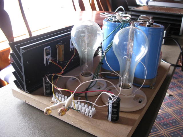

I just opened an unexpected arrival from Jon this morning....
After seeing this, who can resist?

. After hearing his simple power J-fet SE amp at Burning Amp, I feel even stronger that this deserves to be explored.
Hopefully, my F2 will receive a transplant, and I will report back later.
John, you mean this beast?
This was a depletion mode mostfet amp, not JFET, which I thought sounded lively and promising. I wonder if an F2 like charging cap would help here with turn on thump. He also ran the J2 into the feastrex as well.
I hope Nelsons doesn't black list me for posting the chalk board lesson schematic. I assume the article will be worth waiting for, since he had only spent a few hours with it. May not be a final version.

Correct on all counts. I think we're going to have some
DIY fun with this one, as it sounds far better than it has
any right to.
I chose the Ixys depletion mode Mosfet because you guys
can buy it from Digikey for $6 (plus I wanted to play with
it). I also have several types of depletion mode JFETs, but
none of them are available and/or practical.
This will change, even if I have to get them made and
sell them myself.
:cool:

Yeah I get it now. In the past I've used my toaster for testing high-power sound reinforcement amps.
I meant as load for sole active mosfet in amp , not dummy load on output of amp .
look in Zen article ...... or even better - Zen Lite
regarding metal Dale resistors on htsnk , I presume they're 1R source resistors ...
not that's of any importance ..... looking at school board - it really can't be simpler
