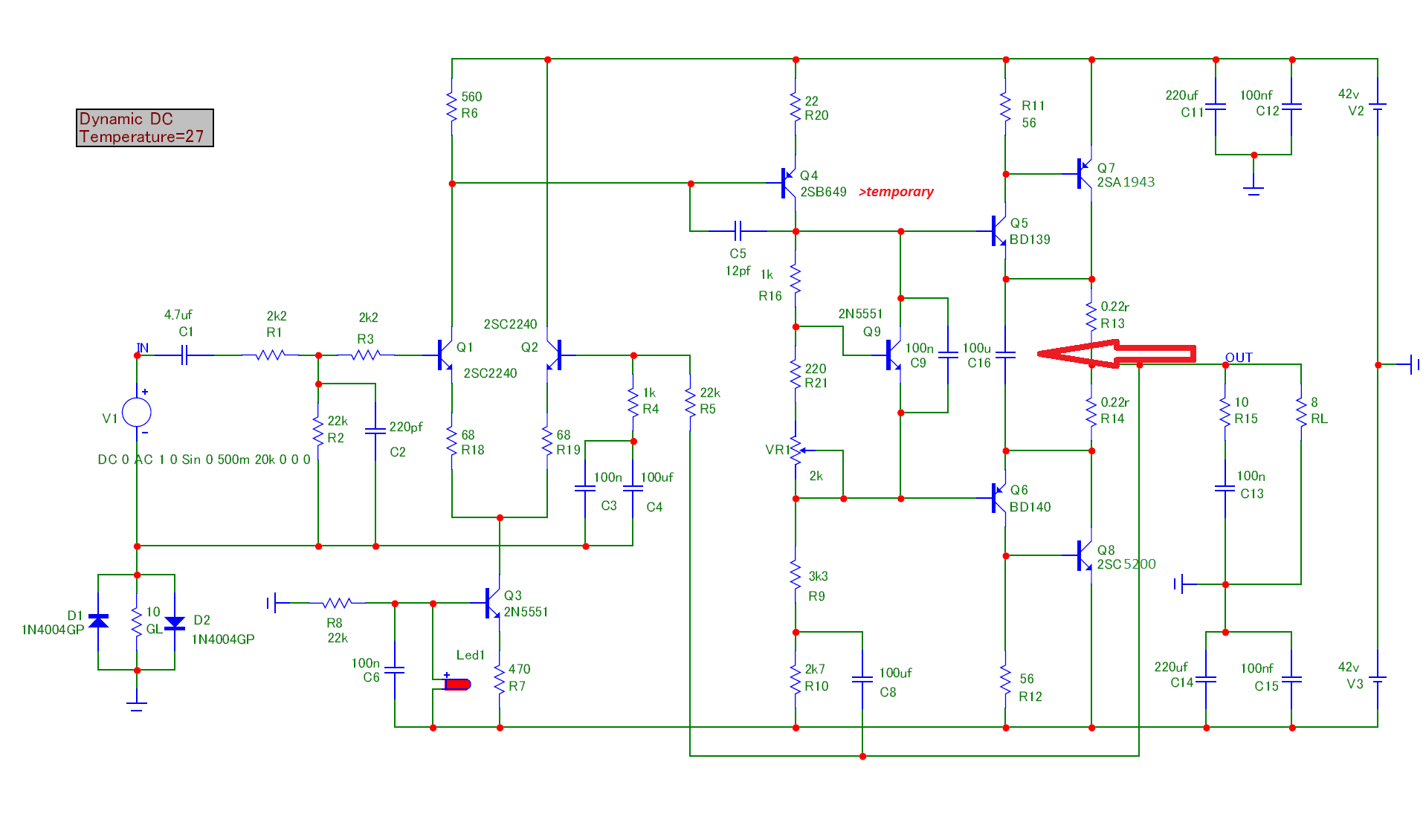

..but the thing is in my actual build DC offset is way too high ( measured at 112mv) I find it odd...

without input ltp emitter degeneration resistors, you are obliged to match the input ltp trannies for equal Vbe and hFE at the desired collector current....
leach showed how to do it....The Leach Amp - Part 2

I've added some of Andrew T's suggestion, run it in sim and transient spikes at 30khz was gone. It is quite surprising the key is in the ltp degenerators. In the actual test dc offset is now measured a low 3mv. Amp is still dead silent and still sounds P3A like.

that cap is a bypass cap, at dc the emitter resistors stabilises bias,
at ac output stage transconductance is higher because of it...

Is this good and something beneficial to the design? I cannot confirm if it shows an effect in sonic quality, it is fairly large though. In sim a small value will not work in eliminating transient spikes at higher freq. EF type II output has it too but in a smaller value in parallel with a resistor.

After a few more simulation run and actual testing, it seemed the basic circuit is still the better one. The design is one hard to crack and patch a few parts addition and still get nice results. Maybe it could be done by going into complexities by redesigning each stages which means going out of P3A bounds.
Anyhow, I came up with this circuit still keeping the basic with a few basic parts addition...I'm not so good with interpreting the simulated results, Is this good or something went bad?

input ltp degeneration resistors decreases the transconductance of the input ltp, but linearizes it.....
If you don't want to change the open loop gain (which would be another departure from P3A original ?) then the usual approach when adding emitter degeneration to the LTP is also to increase the tail current to bring the transconductance back up to where it was before degeneration. IIRC you need an extra 1mA for every 25Ohms ?
The improvement in linearity is still there - and most important is the improvement in linearity for peaks in the signal as it flattens out the whole LTP curve.
Strange choice for Q9 (Vbe), it's a high voltage TO-92 part. You'd be better off with a TO-126 part for bolting to a driver device for thermal management. And ideally the Vbe device would be a high-beta device that's happy to operate with a low voltage across it. What's wrong with the BD139/140 family ?...Anyhow, I came up with this circuit
all a matter of operating points choice, degeneration decreases gain but increases bandwidth.....
can't increase tail current very much higher for noise considerations.....here, simulations helps...

I was thinking, a to-126 device for the vbe multiplier seemed to be larger for use in this circuit.
Its the larger size that makes it easier to handle - its the most common size for Vbe as far as I know.

I never thought about noise before, at least the issue with higher tail current instead seems to me to be related to having use a smaller collector load which reduces OLG.
Could also try a collector load on Q2 to balance Vc at both ltp devices - neve tried it myslf but SandyK of years past said it kept the Early Effect matched when he was tweaking the AKSA amplifier.
