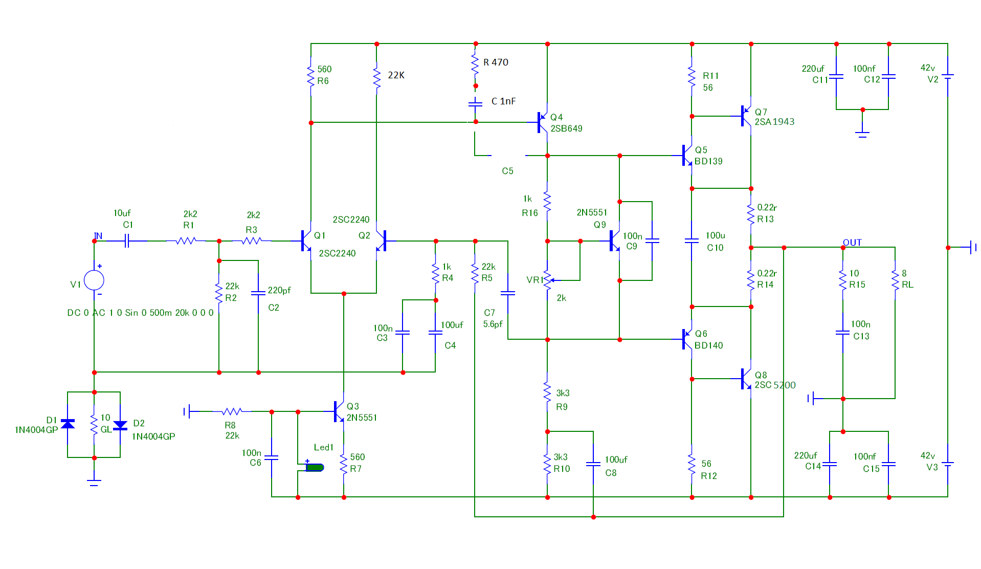

What do you think about this modification in your schematic.
a) LTP: the 22K collector resistor for Q2 (like NAP140), Nigel Pearson says "It raises the second harmonic to give warmth and give correct harmonic balance".
b) No miller cap in the VAS, use a RC filter in the input VAS (like Arcam A60).

the R+C across R6 is a stability correction for the collector load of the Input LTP.
It is not an RC filter to the VAS input.
Many British power amplifier Designers did not use Cdom (Miller comp) and used stability components in other locations.
Why would anyone corrupt the performance of the power amplifier? Make the power amplifier work properly.
If the user requires EQ, then apply that in a dedicated EQ contraption that the user can insert, or throw in the bin.

used in many tube designs, the mullard 5-20 comes to mind, a British design....the R+C across R6 is a stability correction for the collector load of the Input LTP.
i use that trick in my tube amp builds....
R 22k in the collector unbalances the Vce of the LTP.AndrewT
That thing is corrupt? R22K in the LTP or RC shuntcomp in the VAS?
Balance the LTP.

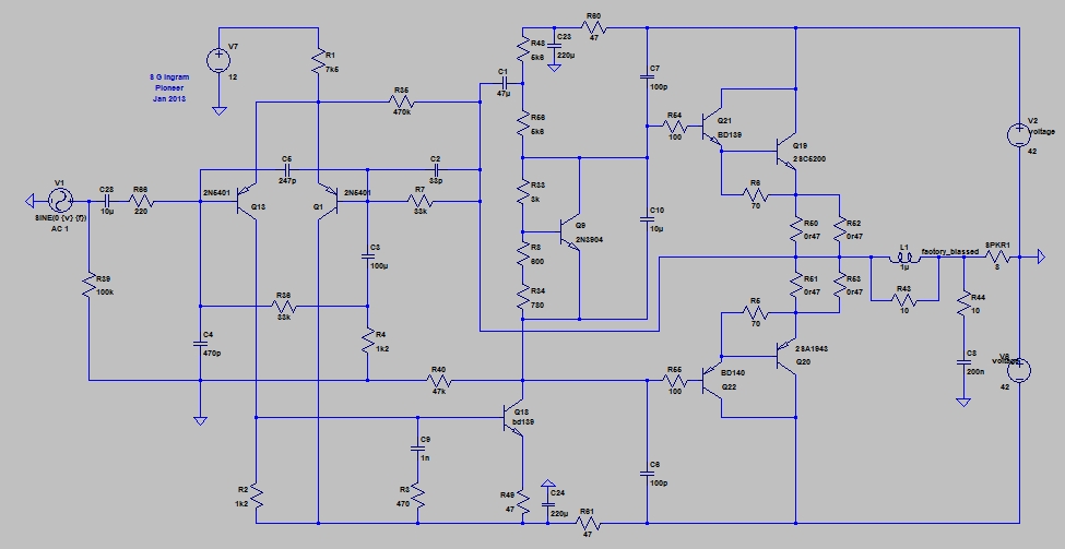

TGM6 schematic (Bigun). LTP input, no miller cap in the VAS (with R+C shuntcomp), EF output.
Conclusion: TGM6 with CFP output.
What are your opinions?

Hi Geirin,
Hi haven't played with harmonics in sim. I thought this is some sort of a preference. I am currently working with intermodulation because this is where the controversial 100pf at the output , evident. Some analyst dislike it and labelled it as "sonic killer". Rod mentioned it as a compensation to kill the occuring parasitic oscillation at the negative rail.
This is how I see it parasitic oscillation will likely to occur at higher freq. in the negative rail, simulated transient response shows it.The culprit is in the riding frequencies. I came across the idea of converting the Vas trannie into an NPN one so that VAs cdom will be in line with the base of the negative rail driver but a small degenerator at VAS emitter is needed to prevent rail sticking ( a possible problem).
It is curious how this nice circuit resist to any tentative to "upgrade" it, every enhancement trick that is effective on a blameless type amp, here is non influent, or worse, the circuit reacts badly. Only thing that seems to work is reversing the sexes of LTP and VAS, it works Ok but not better than the original; and at this point it is no more a P3a, but another thing ... fortunately I amorously saved an original Rod Elliot board, that I will populate when I finally get tired of playing with LTSpice

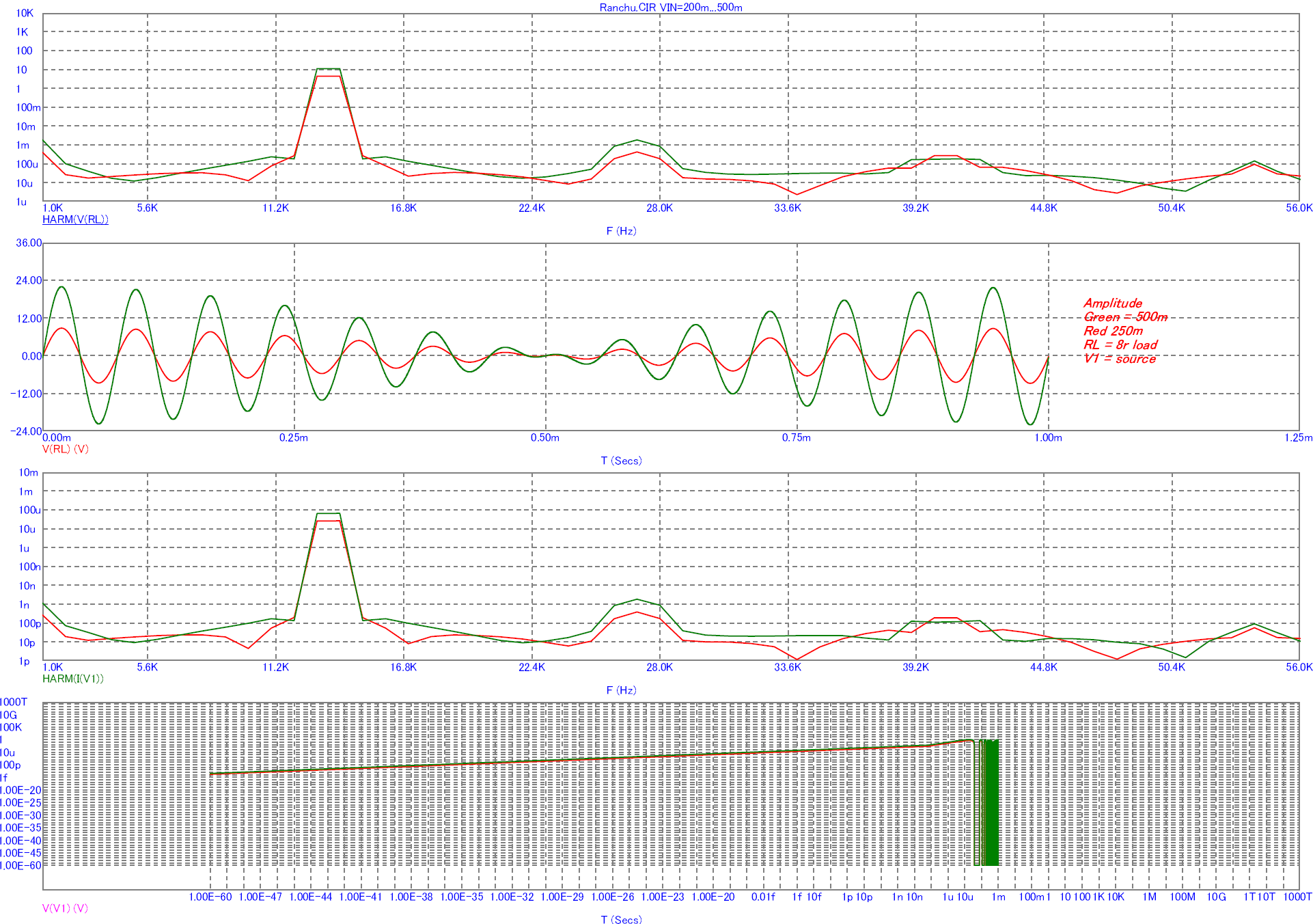

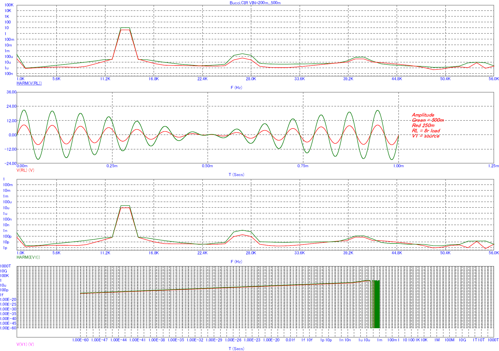

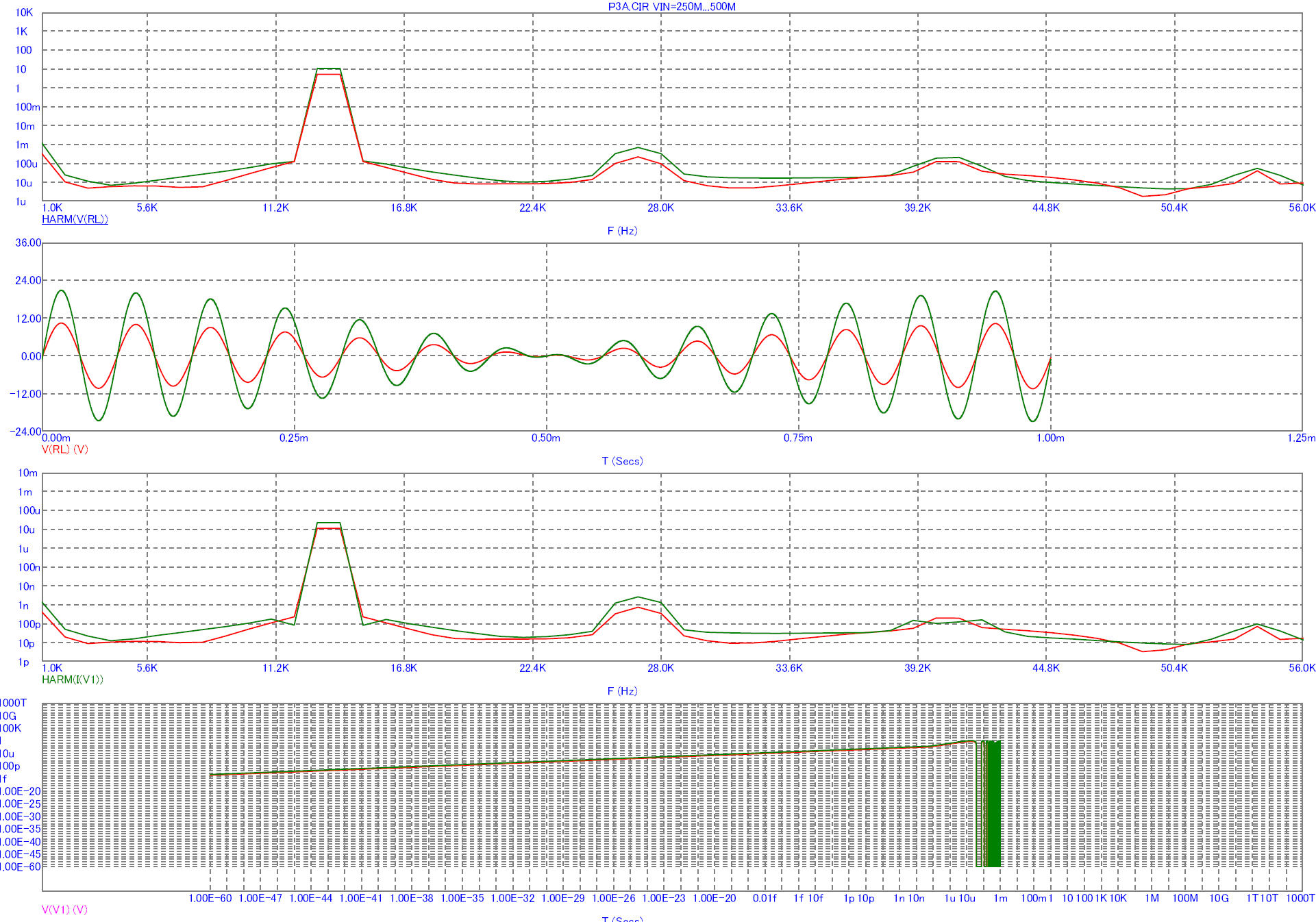

....was trying to upload the IMD results of the plain P3A, Ranchu's mod and David Bucci's mod but i am being abruptly disconnected from the net...slow access here
That's very interesting , please upload it.
Simulated results is made using the same device models (BD/BC) on all circuits with the same quiescent current condition.(30ma) Slone's IMD is for reference only.
