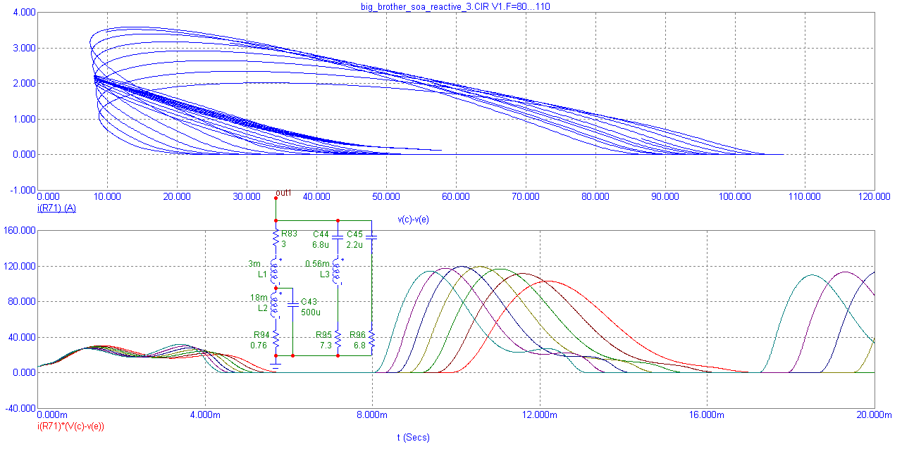

You want to know how to calculate Safe Operating Area? OK, this is what you do. First determine the minimum load impedance. Now multiply the output power desired by the load. Let’s say 100 watts at 2 ohms =200, now take the square root of 200 you get 14.14 volts. Now multiply the output voltage 14.14 times 1.414 to get the peak output voltage of 20V, next determine the losses from the power supply sagging and the voltage dropped across the output devices to determine your rail voltage. Let’s say +/- 28v. Now take 100 watts and divide it by 2 ohms = 50, now take the square root of that and you now have your output current, which is 7.07A.
Here is the formula: Vcc – Vpk = Vce @ A x -30 degree (I am using -30 degrees as the phase shift angle, purely resistive would be 0 degrees and purely inductive is -90 degrees phase shift. I have found 30 degrees is a good approximation of the actual load. 90 degrees = 60 degrees, calculate this by 60 sin x A ‘the output current’), 60 sin x 7.07A = 6.123A. I normally do this at V @ 90degrees, 120 degrees, 150 degrees and 180 degrees, with current calculated at 60 degrees, 90 degrees, 120 degrees and 150 degrees.
We have: Vcc = 28V
Vo pk = 20V
Ao = 7.07A
Load = 2 ohms
Vcc – Vo pk = V ce @ -30 degrees x A
90 degrees: 28v – 20v = 8v @ 60 sin 7,07 = 6.123A
120 degrees: 28v – 17.32v = 10.68v @ 90 sin x 7.07 = 7.07A
150 degrees: 28v - 10v = 18v @ 120 sin x 7.07 = 6.123A
180 degrees: 28v - 0v = 28v @ 150 sin x 7.07 = 3.535A

You want to know how to calculate Safe Operating Area? [snip to save bandwidth]
Spreadsheets are good at this, for instance:
http://www.linearaudio.nl/paXdocs/paX prot calc master reworked.xls
jan didden
David Eather discusses this in detail for both output and driver devices.
He goes on to show a hand calculation method that takes account of load phase angle and shows how to plot the results to compare to the manufacturer's datasheet SOA Lines.
Bensen did a spreadsheet for us that automates all the arithmetic and plotting to make it very easy to "see" how the proposed amplifier will "stress" the devices cf. the datasheet.
I have modified Bensen's spreadsheet to also include BJT output devices and BJT driver devices and de-rate devices for operational Tc. For some output devices I have included protection locus using Jens' modified version of the Leach protection circuit.
If anyone wants any or all 3 sets of excel spreadsheets then Email me.

AndrewT,I don't understand the parts where you are considering the load phase angle.
Can you explain more?
Have you read David Eather?
I have not read anything by David Eather, but I would like to. Can you tell me where I can find his articles. Is his explanation different than mine? I have been designing Home Audio amplifiers, Car Audio amplifiers, Guitar amplifiers and Professional Audio amplifiers for 30 years. The formula I published is the same I used for designing all of them.
Now, as far as the phase shift goes, a purely resistive load voltage and currant are both in phase, 0 degrees of phase shift. A pure inductor the voltage is at 0 degrees phase but the current is shifted 90 degrees. A typical voice coil has both resistive and inductive qualities. -45 degrees would be the center point of phase shift but in most voice coils are slightly more resistive than inductive, which gives you a phase shift angle of -30 degrees. If you have any other questions please feel free to contact me.
Thanks, Ace956
David Eather's SOA paper
here's copies from quite a while ago.
BTW,
I use 45degrees of load phase for moderate speaker reactance and 60degrees of load phase for severe speaker reactance.

AndrewT,
I looked over the work of David Esther's and he is basicly saying the exact same thing as I did in m formula just stated a little deifferently. Either formula will work. I was working on the heat sink slection process but I see that he has already addressed that.
thanks, Wade
thanks, Wade
AndrewT,
One more thing about David's papers is the phase shift. I have always used -30* phase shift. I have designed and manufactured thousands of amplifiers using this phase angle. David on the other hand suggests using -45* to _60*. this will work fine but it will require that you use more transistors for the same output power. Like I said -30* has always worked for me.
Thanke, Wade
