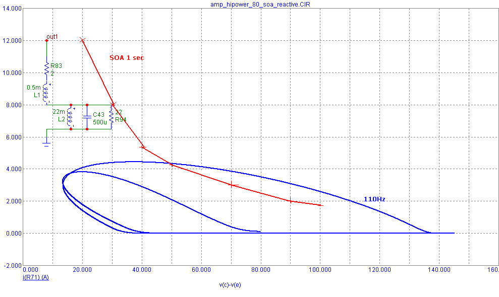

AndrewT,
I tried to go back and look at his articles again but I can't find them. As I said before I believe that the major difference between my formula and his is phase shift angle. I believe that the phase shift is mostly resistive with the inductive component being much smaller. If you use 45* or 60* phase shift you will need more devices. My experience tells me that 30* works fine with both active and passive speaker loads. At my company we designed and manufactured thousands of Soundstream car and home audio and Stewart Electronics pro audio power amplifiers all designed around the 30* phase shift. Our line of pro audio amplifiers actually won a TEC award at the 1994 AES convention. I would like to see the articles by David again. How much difference have you noted.

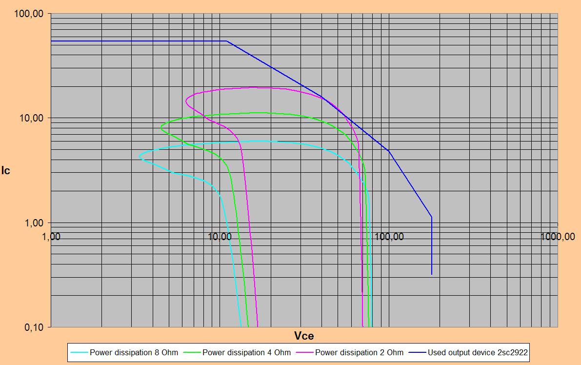

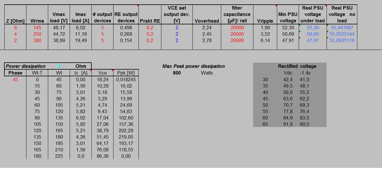

What do you guys think of this?
I attached some pictures from mine spreadsheet.
Input:
145W/8Ohm
250W/4Ohm
==> transfo of 40V 0 40V
Phase of load 45°
Temperature output devices 50°C.
Output:

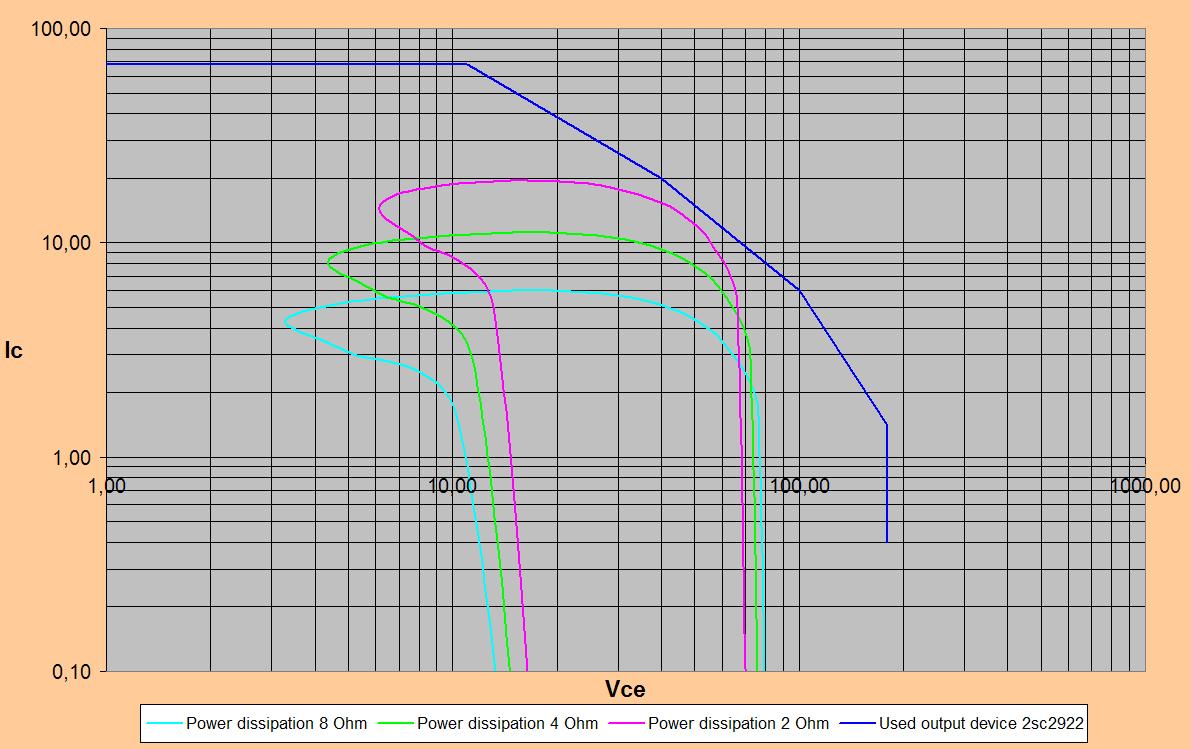

SOA curve with 4 devices
SOA curve with 5 devices
It seems that 4 devices will fail.
Am I to conservative. I know that a speaker at certain frequencies can have a real low impedance and a big phase shift.

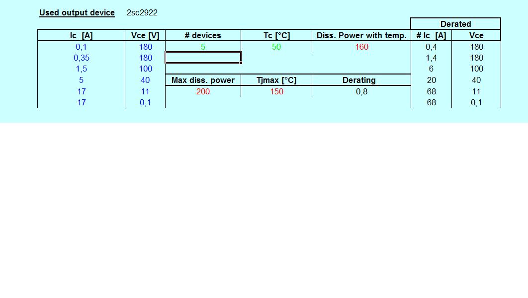

I have laying around 16x 2SC2922Y and 16x 2SA1216Y, but its not my intention to use to much of them if not really needed.

I reckon designing for a 4ohm 60 degree load accomodates at least 99% of loudspeakers on the market.
