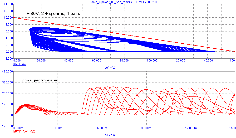

Analysis similar like this is needed. One may be surprised.
Hi Pavel,
Nice plots. One of the things that's interesting about such overlapped SOA excursion plots is that the composite boundary turns out to be a straight line. This approach makes recognition of the fact that, for a fixed resistive series element (like voice coil R), those load impedances that have a significant phase angle also must have a higher impedance magnitude. In other words, if you are simulating into a woofer with 2 ohms Re, it would be pessimistic to assume an impedance magnitude of 2 ohms with a phase angle of 45 degrees.
I think this sort of thing was explained pretty well by Keith Howard in his Stereophile article awhile back.
Bob
One of the things that's interesting about such overlapped SOA excursion plots is that the composite boundary turns out to be a straight line. ...

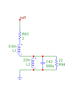

Hi Bob,
of course, for a resistive load we get a straight line.
Regarding 2 ohms Re, yes, it is a 'pesismistic' value, but in case of multiway speakers with 2 woofer drivers connected in parallel, you may get quite difficult load, depending on woofers used.

Hi Pavel,
Let me see if I can explain my point better. If you have a reactive load with a minimum resistive impedance in series, as Re of a woofer is in series with a reactive tank circuit, in order to get a phase angle of the resulting net impedance you have to add reactive impedance in series with that initial resistance. If you add j2 ohms to 2 ohms, you get an impedance with a magnitude of 2.8 ohms and a phase angle of 45 degrees. If you add j100 ohms in series with 2 ohms, you get a phase angle of nearly 90 degrees, but the magnitude of that impedance is over 100 ohms.
The straight line that is formed by the overlapped boundaries of all of the reactive impedance loci is the equivalent of a resistive load line that extends from 0V to twice the rail voltage, as is easily seen from your nice set of overlapped plots. The resistance value of this resistive load line is twice the resistance of Re, where Re is the real resistance effectively in series with the reactive component of the load impedance.
If you have a loudspeaker whose impedance dips to 2 ohms, then what I am calling Re is 2 ohms. Clearly, the phase angle is zero at the point of the minima, so this is the real component. The maximum V-T boundary of the overlapped loci of all possible reactive combinations for this loudspeaker will form a resistive "load line" with a slope of 4 ohms, and which extends to 100V if the rails are +/- 50V. This observation is extremely useful because all we care about is the VI excursion boundary for all impedance combinations as a function of frequency, regardless of how those impedances originated (e.g., woofer resonance, crossover impedance peaks and dips, etc.).
This is a very convenient observation, but it is NOT the same as saying that the amplifier need only support a 4 ohm load, since a 4 ohm load only extends to Vrail, NOT 2 * Vrail. This is a very important distinction.
Bob
Hi Bob,
my parallel woofer model under simulation was as attached, which is IMO not so far from reality.

Here is an example of the line Bob wrote about. Is it correct that there are 4 pairs of devices on +-80V and that the same load circuit with Re = 2 ohms was used to generate these ellipses? This does not take into account that there is still some voltage drop (15V??) when the amplifier clips so this is why the ellipses do not quite reach the red line.
However, if more than one frequency is present then the load line can go outside even this line. The time spent outside (and even near it at high Vce:s) is short though for sensible signals.

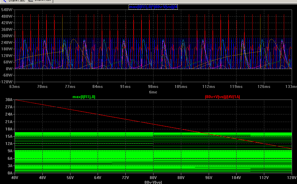

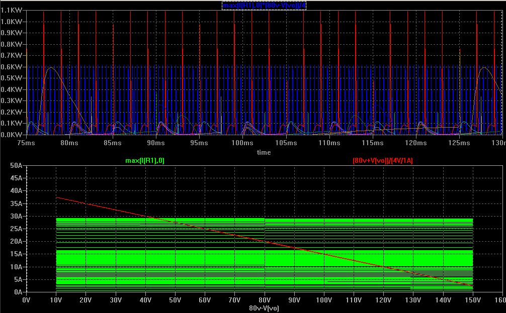

Here's +-70V and +-40V fast rise time square waves at a couple of different frequencies with PMA's load circuit :D 4 pairs of devices on +-80V. The upper diagram shows dissipation. In the lower diagram the red line is the one Bob wrote about while the green mess is the load lines.
The rise time of the square wave matters. If it is slow then it won't be nearly this bad. Countering the inductive rise in impedance toward high frequencies with a zobel also makes it much better. Also, one has to wonder whether or not a full power fast rise time square wave really is a valid signal.
These large dissipation peaks that can be seen are very short. It's really more of a problem of protection circuit design than transistor SOA.
And the 1-millisecond SOA can be many times the DC capability. At 100us, the FB SOA of a bipolar transistor is darn near square. A response time for the protection circuit on that order of magnitude is quite sufficient. You usually end up needing to slow it down to allow those 100us peaks to exceed the "low frequency" limit.
Hi Bob,
Hi Pavel,
I agree, this is a quite reasonable woofer model. It represents what would be agressively rated as a 4 ohm speaker. It would represent an "honestly" rated speaker, by conventional standards, of a little less than 3 ohms.

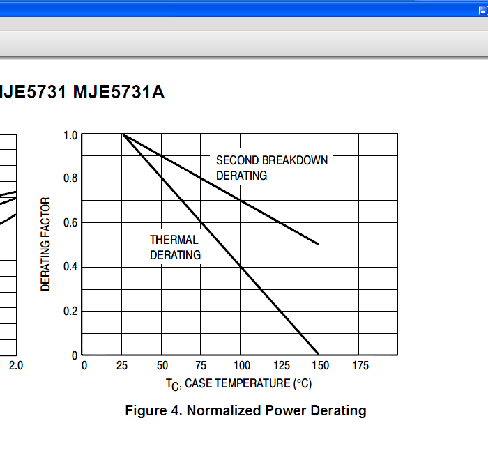

Which approach to second-breakdown de-rating do you guys think is appropriate?
None of this long-winded post is meant to imply that you should not adhere to the manufacturer’s SOA curves, but rather to provide some understanding and to show that there is a bit of safety margin under some conditions. The amount of safety margin in the important second-breakdown region as a result of the long-term reliability vs. destruct threshold junction tempertures is less clear.

The linear derating factor. If you look at Moto/On's s/b ratings, especially for switching transistors, they publish two derating curves. One for thermal, and another for s/b. The s/b derating curve is actually even less conservative - it does not derate all the way to zero at 200C.
Thank you! This is a very nice find. The result is very encouraging.
