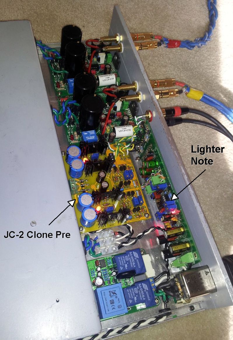

Thanks Daniel for your detailed reply. I have used the 50k pot solution on the input of one my recent builds (LJM class D amp). I kept the cables very short (< 2") from the amp inputs. This worked very nicely and it sounds very good. It addresses the issue with my 'over-bearing' pre. I may explore mods that I could easily make to my new Doug Self pre without necessarily affecting its fine specs. It sounds great and is essentially noise free. At some point it will find a permanent home in my preferred stereo rig, but that hasn't happened yet.
I do like the idea of the Lightspeed Attenuator and in the future may build a portable one with RCA in and out. But it sounds like it 'okay' (maybe not ideal) to use a 50k pot in a power amp as long as it's close to the input.
I'm somewhat of a newbie with building amps and have therefore limited my selection to full kits, or assembled modules so far. I haven't ventured into buffers and some of the other external circuitry that may be required between amps and pre's. Could you point to any threads, or links that provide details on building and using a buffer circuitry? I need to study up on buffers! :)
Rick

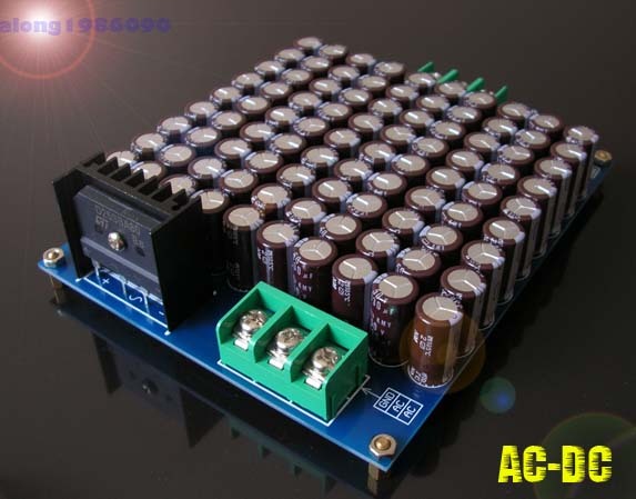

Hi Klaus, -
Not exactly sure what type of array you're trying to proto for the 7294, but I was wondering if something like this is what you're after? Maybe not as large of an array. :) I have not used this particular board, but have thought about getting one just to have around for a future project.
That board sure is nice for the price but using an obsoleted capacitor type (Nippon Chemicon KMY), also it's not low impedance as does not use solid copper planes.
However, as a first filter/reservoir bank it might do well (with enough series resistance with the diode bridge).
In using surface mount caps, one can make a vertical daughtercard with the caps on both sides. It reduces the board size dramatically. I still wouldn't put any caps at the "corners" of a square shape board. The 4 (or 8 if double sided) caps at corners would be the "most different" so I would omit them. I'm not sure how a vertically mounted double-sided approach affects your board layout, but assuming it has vias anyway, might as well mount caps to both sides of them. The surface mount computer caps are designed to tolerate "sideways" (any "mini-tower" computer), are available in tighter tolerances and generally have low ESR spec.
