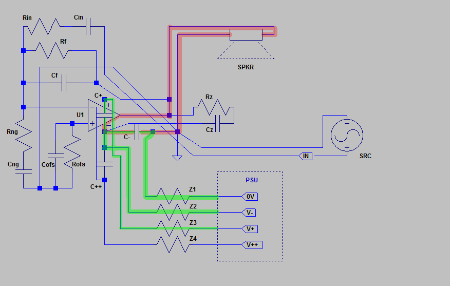

Alternate Local Decoupling.
Instead of using two caps from either rail to GND one can also use two caps differently, one rail-to-rail (C+ below) and one from the neg rail to GND (C-) -- this also has been proposed by other DIYA members in the past. The common point of the caps is the negative supply, and all three feeds to the supply sport series elements (Z1 etc) shown as resistors here for simplicity.
Let's have a look of the current loop for a negative output current in the load :
attachment.php
Shown by the red loop, current flows into the output pin of the opamp and it leaves the chip at the neg supply pin. Then it returns back to the output though cap C-, GND attach and the load in counter-clockwise direction, the cap acting as a level shifter.
The green traces show current paths when the local caps become ineffective at LF down to DC, the slim green trace sees no DC, though.
Key points are that the caps (which are composite/arrayed caps) are close to chip (to benefit from their low ESR and ESL) and that the loops have low area for low inductance to neither emit nor reveice magnetic fields. Finally, nodes are located such that any I*R drop along the wires/traces have no consequences.
Assumed that Z1 can be made rather large (as we will see) as well as C-, there is almost signal current alone and very little AC supply recharge/balancing current. The rail-to-rail cap C+ is out of the picture mostly.

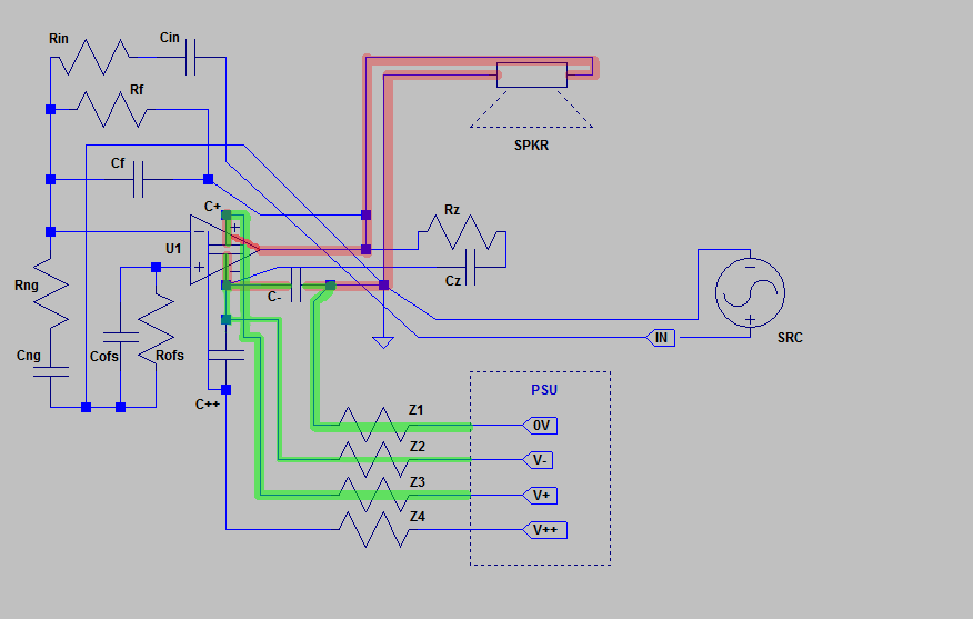

Now going to the postive load current :
attachment.php
The current leaves the chip via the output pin along the red path, goes through the load back to GND. From there the return path to the V+ supply pin is first through C- in opposite shifting level to V-, clockwise direction and then through C+, level-shifting voltage again to V+.
Again, the green paths show current at LF and LF/DC (thick green only).
The important thing now is the notion that cap C-, the GND-to-V- cap, is always in the loop, plain series to the load and will effectively see no balancing current to/from the supply at MF/HF. This means the V- pin (subtrate) is tightly bonded to GND and any variation of its voltage is small and basically linear, fully correlated to the signal output current (but with a different freq response). This leads to the lowest possible impact of supply rejection issues of the chip including nonlinear distortion.
C+, the rail-to-rail decoupler, feels only the half-rectified positive load current and therefore is a most delicate point where lowest loop area is paramount.

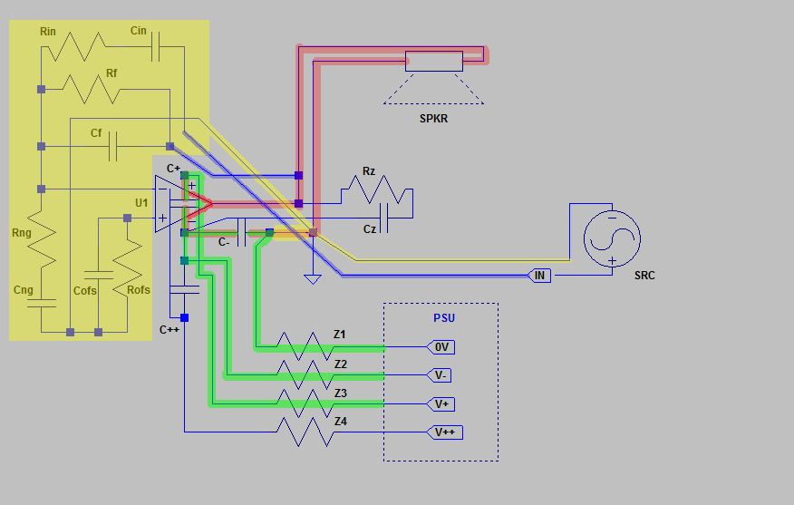

Finally looking at the feedback/input scheme :
attachment.php
Other than bias currents and some capacitive stray currents no currents flow in the opamp input pins IN+ and IN-. The arrangement is inverting, Rf/Ri determining the gain. Ci block DC (optional), Cf, Rng, Cng provide means for stability. Rofs minimizes input bias current offsets and Cofs shorts it for low noise. Rz and Cz is the output snubber.
Blue is the input current from the source and gets routed to the ouput pin while the signal current in the yellow GND line is basically zero until it meets star GND from where the return current finds its path back to the source. The yellow GND plane (or better, a shielded cage) must find a short and low inductance path back to the V- pin (and GND). This is not fully reflected in the drawing, also the exposed node area of the IN- network should be physically smaller than shown.
When several amp get connected (on the same PCB or elsewhere), a solid GND buss bar is going though the big yellow trace left of the star GND, and supplies lines would be fed with their own series elements, at least in parts of.

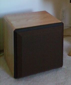

I built a sub (rather two subs - both sealed and reflex) using a Hi-Vi driver with a 68 pound magnet and a 500W bash sub amp. I haven't even turned it on once the improvements to the MyRefs were completed. I'm sure the "gurus" here will be able to tune in the bottom of the TDA7294 to everyone's satisfaction. It's my personal view that a woofer surface area equaling at least 8" is necessary to produce what high quality chip base amp is fully capable of.
I have never experiences anything like you describe as a standby shutdown. There have been some strange noises, but in my case are due to hiccups in the JRiver player. Maybe what you heard was the Zune going to sleep. Hope you have some junk speakers around for the next power-up.
Thanks again for the review.

Really interesting, similar to AN-202 regarding feed forward decoupling.
Actually, there is almost no similarity to a stacked film cap.
A stacked film cap is a single cap with some known "bad" issues for audio, and more inductance than the entire 100000uF array. How could there even be a comparison?
A stacked film cap in practice is a parallel of hundreds of plain caps.

Dario,
That AN-202 is a classic and my oldest reference to that idea.
TDAs did well in some standard "current pumps" and mixed output impedance amplifiers I designed. Howland type is critical because common mode voltage is high (67% of the output voltage in the MyRefs) and could exceed chip limits, which are unknown for the TDAs other than that the input stage cuts off when pulled to V-. True usable input CM range is something I want to find out in detail sometime, in comparison to the LMs. Both have not specified this parameter in their datasheets so we can only assume a guaranteed range of no more than about 1/10th of the ouput voltage plus some unknown headroom, depending on supply voltages and their balance.
