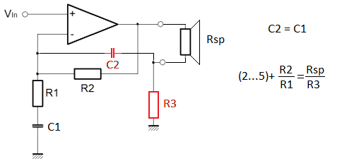

Finally hybrid FB. Finally real output optimization.
tnvijay, thank you!
However, i have even simpler plan. First, i didn't discover anything new. I am convinced such design exist for long time, but is not discussed publicly.
I do not like inverting amplifiers, that is why i go this way.
So:
Pick whatever kit you can/wish, with non inverting amp. Any chip, or even discrete, depending on your knowledge. Get it working as is. Optionally replace input and FB shunt caps to get better low end response. In my case with TDA7293 i throw 4.7u at input and 220u at FB shunt. Don't bother with other parts in FB.
When it works stable, pick some low value resistor and put it between speaker and ground. My speakers happen to be 6-7 ohm effective, so i paralleled 2x0.47ohm/2w. Idea is to achieve just a little bigger current FB amplification (calculated) compared to existing voltage FB. Say, +1, +2 more. For real 8ohm speakers this resistor should be something like 2x0.47 in parallel, with one more 0.47 in series to them. Some experimenting is needed, because no one knows real impedance of the speakers.
Pick a cap, say, equal to voltage shunt FB cap and place it between speaker/resistor junction and - input of your amplifier.
That is all! Magic is here! You have non-inverting hybrid FB.
If you wish, you can calculate and further optimize this design. I will not put calculations here because they are pretty complex and will not give a lot to mass users.
How it sound? Different! I like it. No, to be more correct: because of this hybrid now i hate my multi-thousand euro sound system, built and optimized over the years. For me it sounds better even compared to valve amps.
How it measures? Most likely very bad! O-scope 'audiophiles' definitely will not like it. But i use my ears for listening and scope for other things.
With this simple addition almost any amp can be 'fixed', virtually for free.

Thanks . I am a self taught electronic hobbyist.To Understand your design principle,can you post a schematic, for ex with a TDA2050 ?
Hi DanielThanks! And, then we have these (attached).
We're not likely to see any "in the wild" because this is DIY and they're likely to get modded (no matter how nice they are if not modded). Therefore, the normal usage for these is the solid place to start that was not provided by the datasheet.
The under-volted 45W example will image better (used along with 20-0-20 and 22+22 transformers). At the expected voltage (printed on the schematic) and with the assumption of excellent compact (I mean tiny!) layout and route the gain divider's resistors most directly (rather than most decoratively), then the cermet trimmer is set to 780R but can be fiddled to support different applications, including different voltages and other modding. Of the two schematics presented below, the lower voltage example has higher resolution. Sounds like a hi-fi.
However, the #1 most popular mod for amplifiers is a push for power build. So, I generated a second schematic showing the higher rails and different gain setting involved (used along with 25-0-25 and 28+28 transformers). Note the cheap little 680R film resistor has not performed optimally as a base stopper; however, if you replace that with a cermet trimmer, you can dial it to 730R. Also, the series elements are high efficiency MBR1645 schottkies, which have smallest voltage drop but still work just barely well enough to secure the excellent power decoupling necessary for clear audio.
Some of the imaging/3d/realism quality of the undervolted 45W example isn't accomplished by the higher power 65W example, and that's the cost of 20 more watts, which won't boost the speaker output by so much as 1.5db--certainly not worth the compromise, except for people who equate watts with quality. That is actually popular. The higher power version (with higher voltage rails), has a pretty tone and will certainly work well enough to rock the house for a party and for woofer amplifiers as well. Sounds like a party amp.
