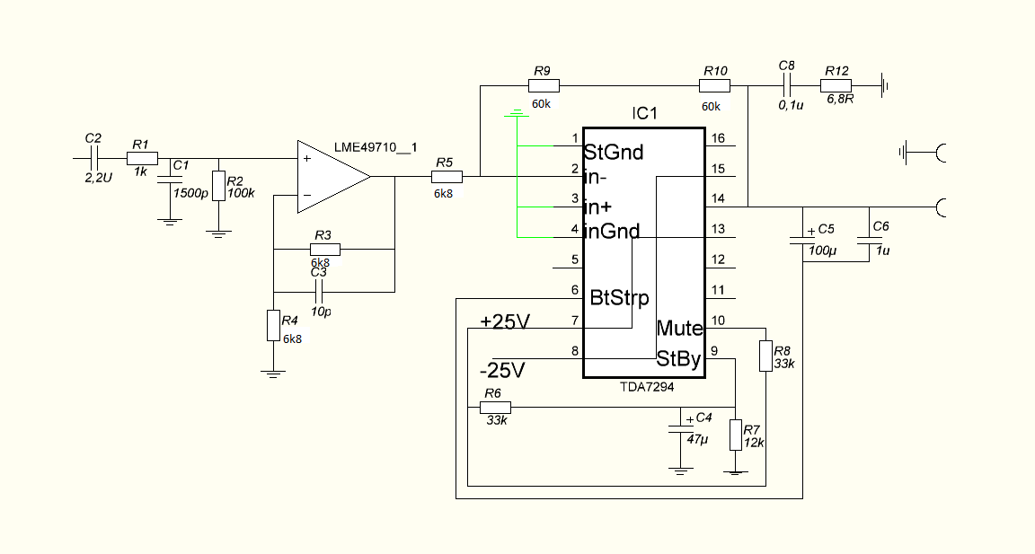

To get proof, put antiparallel bat86 diodes clipper in parallel with your FB cap (just for test) and use enough capacitance so that the diodes cannot switch on, ever. Measure to proof. Remove 0.3v clipper afterwards. FB cap rc frequency higher than 1hz can make 'warm sound' distortion effect (that you don't want). It takes some labor to get the right size, not too big and especially not too small. The 16v 'computer type' low esr, low inductance caps, work well for signal. Parallel two 330u will do hf more cleanly than one 680u. Doing it right is less labor and less distortion than a DC tracker. The DC tracker is better in just one way--tracker is easier to explain....higher FB cap...
Mute circuit breakage:...Mute circuit...
Although screw terminals /w intermittent v- contact and tab-heatsink shorts are common causes of chip breakage, there's another cause: Broken chip and broken mute diode go together too often for coincidence. Perhaps the flimsy little signal diode should be replaced with 1n4004?
Mute circuit alternative:
I think that resistor series to zener (no cap) could accomplish the mute circuit. For example, resistor series to 24v zener, 32v rail, uses the power supply reservoir as the 'timer' cap. That idea needs adapted to suit; but, you could run the mute circuit at voltage low enough to mute quickly at shut off. I'm not saying that is the best option--what I'm saying is that the option exists.

Input cap, in tandem with input load, defines low end of amp bandwidth. Simple RC high pass filter. It does not affect mid-range. It affect only low end. BUT, by cutting too early, you block low freq, promoting mid-range. You LOST this low range bass! You can not restore it later! Datasheet proposed filter here has -3 at ~15Hz, which even for me is way too high. At this position i prefer 4.7u, getting -3 at ~1.5. Too low? Actually yes, with ~-0.1 at 10Hz. Still far bellow more reasonable 20Hz limit. But phase shift at 20Hz is ...
Why i didn't change the resistance here, as you did and admit? Because this way i will make unequal DC path for amp inputs, resulting in (amplified) DC at output. So, change cap here, but not resistance, Resistance must be roughly equal to FB resistance. Here i have some reserve for resistance changes.
FB cap. It forms another RC high pass filter, which is recommended to be placed at least 1.4 bellow input one. This filter actually passes its pass-band to ground, allowing the resistive divider to do its duty. Stop-band if transferred in full to -in, resulting in gain of 1. Here i prefer 220u, which will give -3 at ~1Hz with provided 680 ohms. Higher cap values here are asking for troubles. They form bigger time constants. Those caps need to be charged fast during startup, or bad thumbs will be put on speakers. Increasing either cap and/or resistor value here -> longer time constant -> bigger thumb.
FB divider. Datasheet 22k/680 provide ~33 voltage gain. Table bellow it recommends gain ~30. With higher gain, out-of-gain will happen at much lower freqs. As I already mentioned, at ~38 gain rollof will start at ~8kHz. My personal preference is ~28 gain. With it i get flat 20kHz and rollof start after that. Chip is rock solid stable.
Current thru this divider must be high enough to allow FB control of low level signals, but not so high to overload anything. With proposed divider, 1Wpp over 8 ohms results in 0.12mA, or 0.06mA per half wave. Chip input bias per datasheet is 1uA, which is not too far and impossible if amp is used at 1W for audio signal, even if it seems as such.
The same divider is widely used for other amps because it is not implementation (chip) specific, but provides kind of well accepted/known gain setting. It is not error in any chipamp datasheet.
Zobel network. Because out-of-gain happen too early, i do not see any benefit of it. However, i do not see any negative effect too, so i leave it as is. The same apply for any other HF filtering.
Bootstrap cap. ST says it can NOT go bellow some value. They provide kind of min value, but do not specify what can happen with far bigger. I can speculate here that far bigger one will not be charged because of its bigger time constant. It can stay 22u, or if you feel more comfortably, increase it to 33u and test it (with oscilloscope). If my memory is not wrong, i have 47u here, still need to measure its effect. Pay attention to its voltage ratting! ST are not writing special paragraph regarding this ratting without reason!
Mute/Stand by. Actually only indirectly related to power supply setting. During boot it is intended to turn off everything inside the chip during PSU caps get charged to some reasonable level. Depending on time line diagram in datasheet, first Stand by must be turned off. That means FB cap (and others) will start to be charged, without signal to be applied, but only after PSU is up to some level. If you unmute the chip, you will mask this moment and any related and danger DC thumb. After this cap charge period expire, they turn off Mute. Tweaks here are related to time constants of caps. Those shown on datasheet seems to be very small.
Never turn of Mute before Stand by! internal circuit will start to amplify what it see at +in, but without FB, because output is off! Situation is open loop! FB cap is not charged. Thankfully, those chips have only 80 open loop gain. I repeat, NEVER do that!
All above is strictly technical (i hope), calculated, measured, audited, and still simplified. I do not use "Super caps", "Magic wires", snake oil or anything unusual. My caps usually are Fujicon, or what else i have on hand. I do not use over-complicated things to compensate for errors i introduced earlier. No black magic.

Currently i am using conventional voltage feedback with described above parts as "service mode", and for further output performance i use transconductance.
Because of too low cut-ofs, i plan to put dedicated active high pass with much-much strong slope in front of my amp, to prevent some ultra low freq things to happen. That filter can be used also to connect DC servo if i desire to remove my FB cap.
My primary target is first 1-3 watts for everyday use, ~20 watts for short times and why not 70-80 watts for some demos.

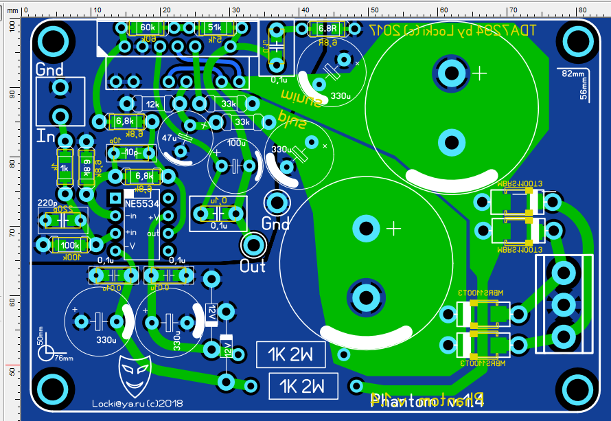

my universal (SMD or through-hole ) soldering Board.
post the schema too
Stand-by must become "high" BEFORE Mute.
Min Gv=26Db, or ~20. Your is 17, or 24Db. That is for TDA only, buffer is not included or interested here.
1u to bootstrap is almost useles waste. This cap is power reservior, not a filter. But if you feel better with it, keep it.
