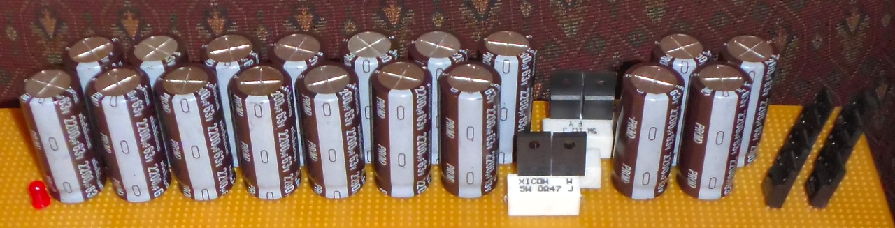

Did you use more than 7 caps parallel?
Sorry I'm a bit slow to join the party here, but your mention of 7 caps makes me want to share a pic with you guys. I wire up 7 caps in a hexagonal arrangement. This works best with caps which are the tall, thin kind in terms of optimizing ESR and ESL.

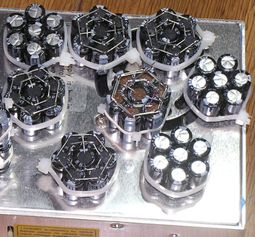

The hexagonal cap bank is interesting. In this orientation the magnetic fields are aligned circularly like a toroid except for the center cap. I don't know whether this will improve magnetic interference but if the space around the cap has any effect on ESL than the effect here would be to increase it. I would orient the pins circularly instead of radially and connect the caps with twisted wires. This would minimize wiring inductance and the magnetic fields of the caps would cancel with them all facing inward (except again for the center cap).

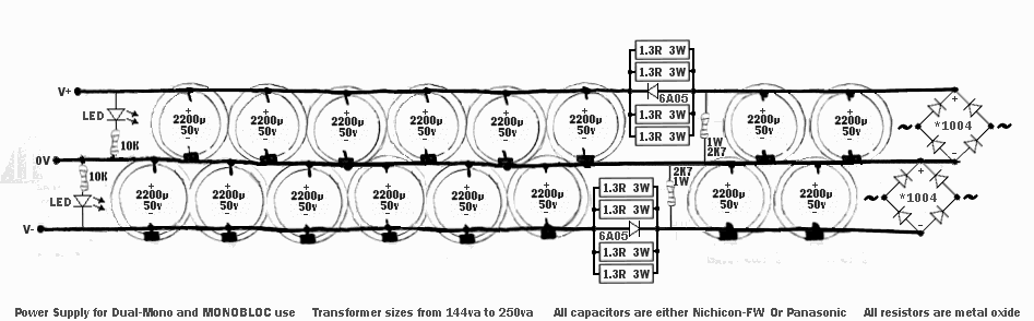

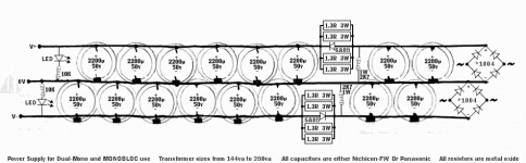

I needed a power supply with a bit higher voltage tolerance (for a discrete amp), so I'm making one too.I'm still planing to build the "reliable old gal" next week as I need the experience of doing so and want to determine hands-on what the audible differences are.
Those are the Fairchild Stealth II 16A 600V soft/fast schottky in the bridge rectifier. Almost slightly confusing to hook up. I'm glad the schematic has clearly marked KBPC1004's!
I'll probably redo the "CRC resistor" section. But it has 0.31R and that series pair of 16a fast silicon diodes has 0.9V forward voltage drop (and half the diode capacitance). Some more significant wattage non-inductive resistors is planned for an upgrade later; however, I'm using on-hand materials at the moment.
Anyway, you're looking at a rather fast 19,800uF per rail, in a monobloc's power supply.
