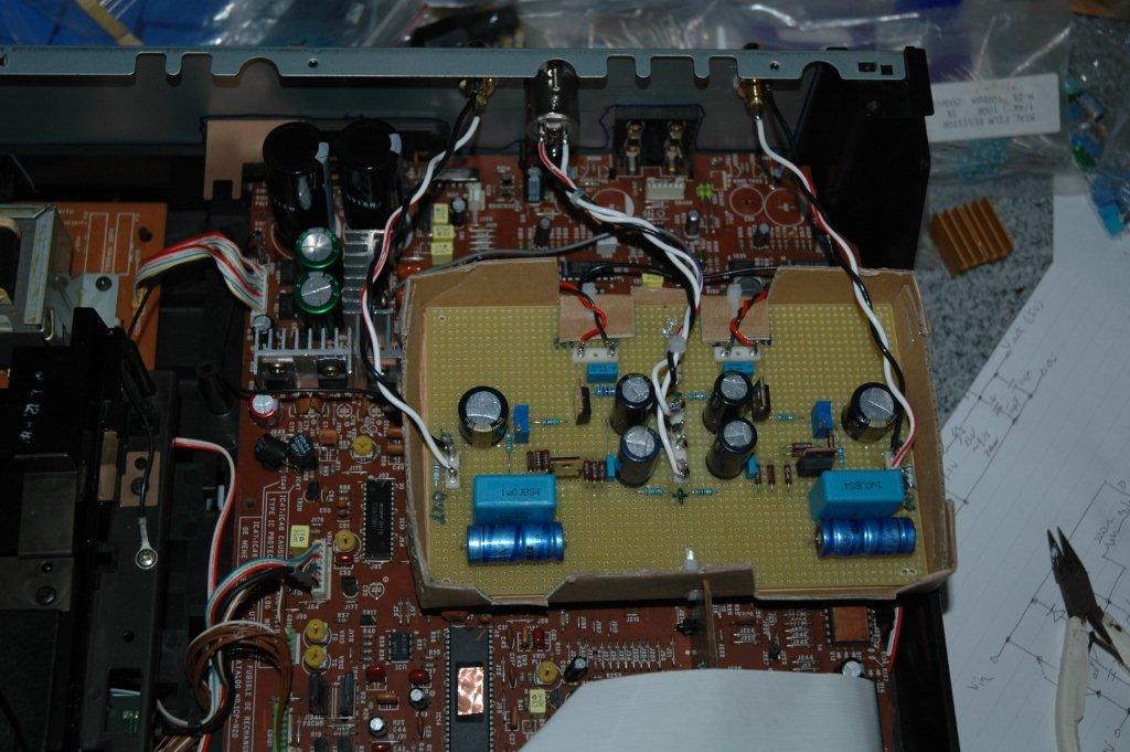

This picture show I have tried the original D1 IV in a CD player.
I think the first K170 jfet IV is a bit better but after I use the K369 in parallel, it is a step forward due to double gain of the jfets - 40mS.
The bias is about 8 to 10mA for the final jfet IV and thus I need to use two in parallel due to heat issue. Lower supply voltage is to ensure not over heat the jfets.
I do not use any reclocking in my design yet. I think a ASRC chip will do all the job of reclocking.
