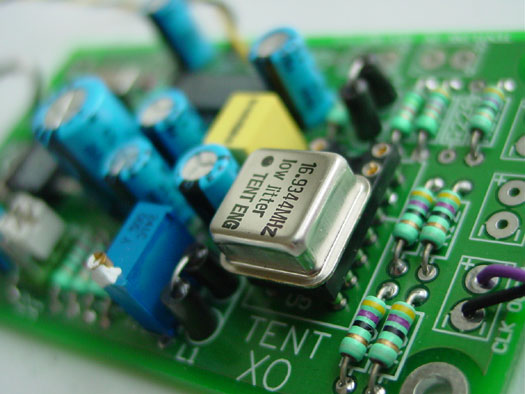

A photo of eurocircuits boards is attached, not many traces but good impression.
best

What program did you use to draw the lay-out? Or maybe other suggestions?
And how is the grounding on this lay-out: (not mine but I got it here)
Guido Tent said:
One remark about the decoupling of the filt pin (20) of the 8412. The grounds of this decoupling network should go directly to the ground pin (21) and shouldn't be part of the groundplane.
Hi Guido,
Why directly to the pin? In my case (I don't use a groundplane), isn't it better to connect it to where the ground comes in? Short signalpad... Or does it HAVE to be pin 21? In that case, again: why?
And does anyone have any experience with connecting the regulator directly to VA+ vs. VD+? Which is better?

1) It MUST be pin 21 directly. All other configurations lead to induced distortion in the PLL. Go and find the current loops......
2) Seperate the regulators, use decent ones for the analogue part and apply decoupling the right way around
http://www.tentlabs.com/Info/Articles/Supply_decoupling.pdf

Another question then. Should the place where I introduce the ground on the receiver, be the same place as where the regulator is located?
Or can I for example place the regulator on VA and the ground on VD? Would it matter that much? Off course, those two are connected.

Hi
Read my article. Try to understand it. Once only DC flows through the grounds, it doesn't matter at all where to connect.....
best
