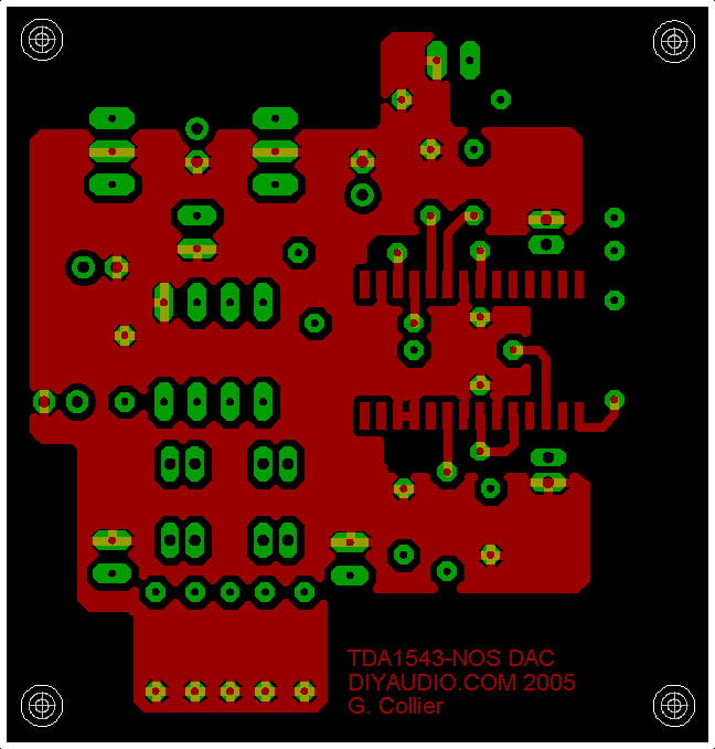

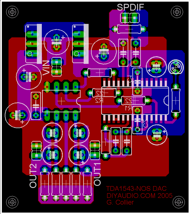

In looking at this new PCB, I miss the decoupling caps close to both supply pins of the 8414, where are these located ?
Actually, I didn't move the decoupling caps any closer to the supply pins. There is definately space to do it. I could rotate the MKT caps that are to the left of the electrolytics on the right hand side of the board by 90 degrees. Then put them pretty much on top os the supply pins. Then all I have to do is bend the grounplane a bit. I might need to move the LED resistor but that is really inconsequential.
Once I get these little chages made I will probably etch and build this little devil and see how it sounds. Wish me luck!
Also if anyone would like the files or PDF's please let me know.
Thanks Again.
G.

Hi
The decoupling should be as close as possible to the IC pins.......
best
Guido Tent said:
Hi
best
Actually..I am going to leave the MKT caps where they are and add a couple of SMD ceramics for decoupling.
G.

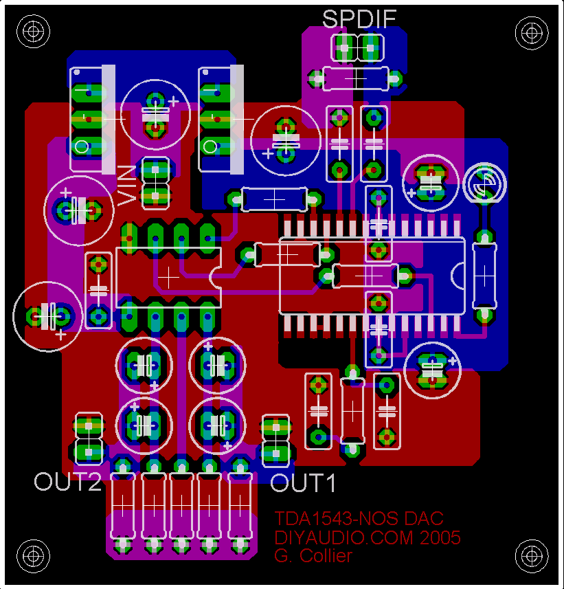

I made some more changes to the board. Basically I moved the resistors a bit, and also moved the decoupling caps to the bottom of the board, as close to the supply pins as possible. In this configuration I can use any kind of cap that I want. It also helped straighten out the groundplane below the CS8414.
Well take a look and let me know what you think
G.
G, I know this isn't your actual question, but if you are building a USB DAC and are going to use a 2706, why use S/PDIF at all? The 2706 has an I2S interface that can directly drive a 1543 (I've built several of these), it has much lower jitter and better sound than any version taking the S/PDIF out and going through a receiver. Its a very simple circuit, much easier than working with an S/PDIF receiver.
BTW I like your last layout much better than the first, it does a much better job on the return currents on the digital signals.

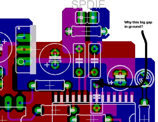

hagtech said:Why the big gap in ground plane? Aren't some of those caps on top decoupling for the CS841x power supply? You removed one of the most important pieces of ground.
jh

Hagtech,
Yup some of those caps on top are for decoupling, and the gap in the groundplane was initially to keep the power ground as seperate as possible from the rest until it all met at the central ground. Now when working on the layout I found that I had to break the grounplane here and at the other side of the receiver chip or I would get some lovely loops around all the NC pins. I'm pretty sure this layout will work well. Consider those small electrolytics as resevoir caps and the MKT's beneath the reciever as the decoupling caps. The ground path on the decoupling caps is very short, while the "resevoir" caps have another cm or so to travel. Even by extending the groundplane out the tolerances around the traces do not allow gor a complete groundplane in that area. In the end I have just a big RF reciever.
John,
That is indeed a good question and the answer is simple, this is actually intended to be a seperate DAC that will go into a preamp with a USB Dac as well. The USB DAC will likely have it's own TDA chip, I haven't decided. Actually the the built in DAC in the PCM29XX 27XX series chips is not so bad.
G.
It is terminology like this and "star ground" that are misleading. Forget you ever heard the terms. They are throwing you off in the wrong direction.
Pretend there is no such holy place as a central ground.
Look at current paths. Which paths cross? Are you making the AC current paths as short as possible?
jh

As short as possible to where????
Here is a picture of just the groundplane. Anybody got any suggestions on what to do with this? The board is only 2"x2"
G
Exactly! That's the point I'm trying to make. We're not trying to go anywhere. Keep currents here.
BTW - layout now looks pretty good. Thanks for closing the gap.
jh

Hi
It is getting cooler every day !
One remark about the decoupling of the filt pin (20) of the 8412. The grounds of this decoupling network should go directly to the ground pin (21) and shouldn't be part of the groundplane.
In addition, a cheap but worthwile upgrade is the optimisation of that network. A 10nF cap directly to ground, and the RC (initially 1 k-ohm / 47nF) can be changed to for example 220 ohm / 820nF.
best

Hi GCollier,
nice work on the PCB! I have some suggestions for you:
- I don't use the resistors in series with the I2s signals anymore. For short distances I believe that no resistors is better. Still, you can leave the PCB like this so you have the option to try (otherwise use wires).
- I would leave a bit more space for the cap before the regulators. If you use a high quality cap (eg. Silmic II) it might get too big. Also, then you can try larger values like 470 uF or 1000 uF. Also, I'd use 250 mA variants of the regulator, they might stay cooler. (not good if the caps get hot, but it is important to have they very near the regulator I have noticed).
- Personally I would prefer the have the regulator of the DAC a bit closer to the DAC chip. And then provide the option for one electrolytic cap. (though also bigger and smaller ones, eg. till 220 uF).
- I would add some holes below the resistor holes so you can use bigger and longer resistors like riken ohm. Maybe they don't fit next to eachother, but then you can put half of them on the topside and the other half to the bottom. The PCB will get a few mm higher this way.
Good luck with your project,
Fedde

Hey thanks for all of the excellent help so far on this project, I have been learning a lot!
Here are the latest changes to the board which follows Guido's suggestion and attaches the filter directly to the AGND pin.
I have read Fedde's suggestions as well, but have not had a chance to digest or incorporate any of them yet. I should note that I am following his schematic for the NONOZ-III for this design.
Keep the suggestions coming!
