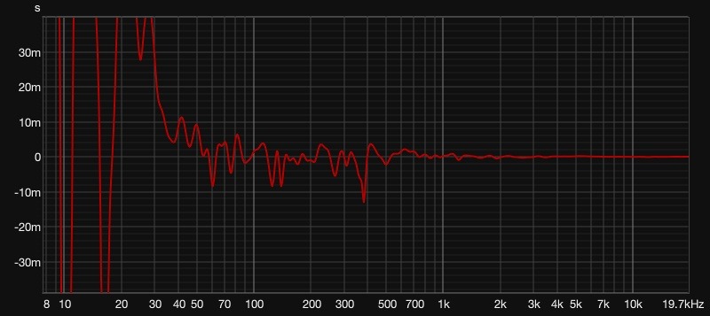

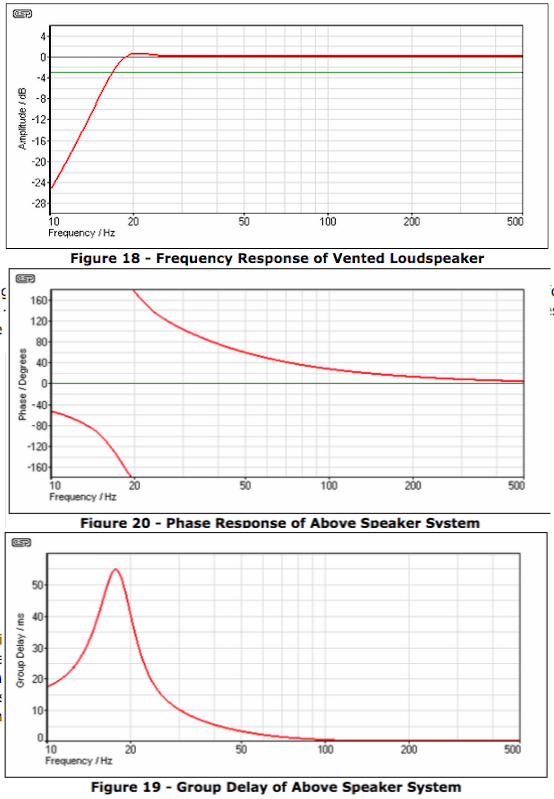

I'm somewhat baffled by the group delay in the bass bin, I suppose I can attribute it to the passive radiator? The spike at 58Hz is presumably where the oem Lascala runs out of steam and where the sealed upper enclosure and passive radiator takes over.
The phase of the La Scala folded horn shifts rapidly at its Fc, (horn cutoff frequency) of ~58Hz.
I don't recall you mentioning how the subwoofer is combined with the La Scala, but if they are in driven in parallel, you will probably be stuck with the phase cancellation in the acoustical overlap range.
The passive radiator output behaves like a port in a bass reflex cabinet (AKA phase inversion cabinet) and it's output at Fb (box tuning frequency) lags ~180 degrees behind the driver output.
The group delay reflects the phase inversion.
http://sound-au.com/ptd.htm

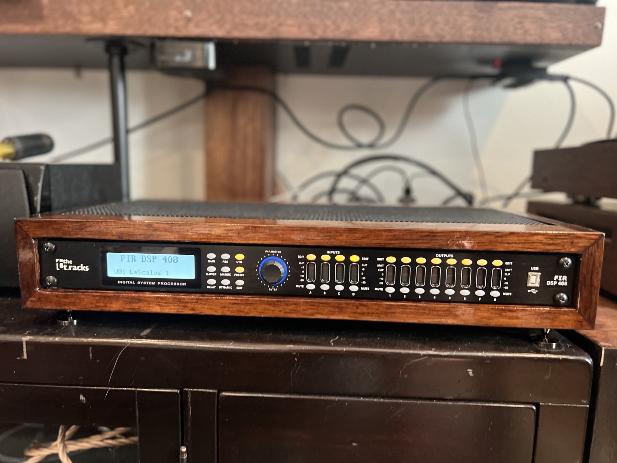

Regarding the fan noise in your FIR DSP 408, you might find draping it with some breathable fabric (cotton tee shirts or similar) will knock the noise down to an acceptable level while still allowing adequate air flow.
Worked for me on amplifiers..
You wrote the noise floor of your inner city Philly home is 37dBA, the fan 44 dBA at .5 meter, which should be ~38dBA at one meter, so it shouldn't take too much fabric to bring it down to ambient.
At any rate, the fabric will make it sound more like pink noise than white noise ;)

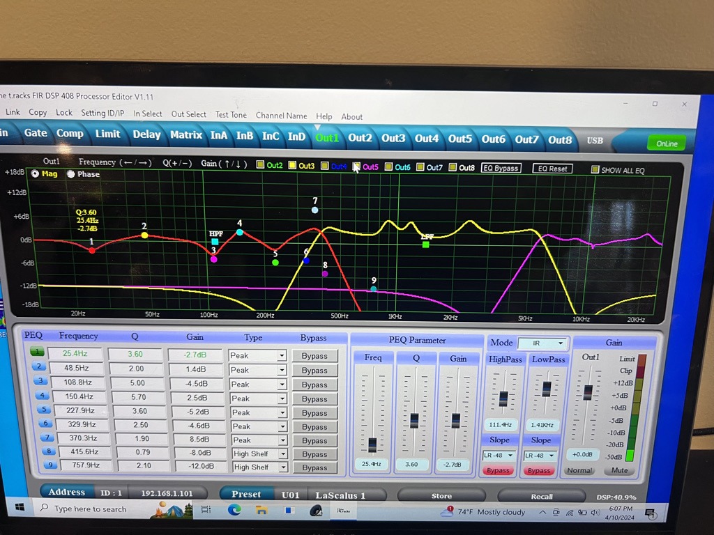

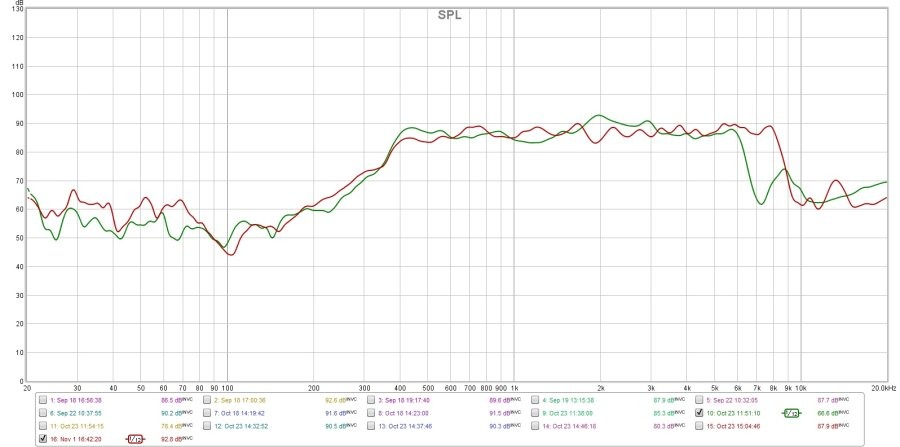

t’s getting close. There’s still some phase issues at the crossover points, at 400 Hz and 5kHz, but it’s much better than previously.
alignment is within .05ms or less through most of the range, but it gets whacky in the bass bin. I suspect that's partly due to the passive radiator and partly due to reflections, I did't bother to cover the floor when I did my measurements tonight. Next season, I'll see if that makes a difference.
Naturally, group delay in the bass bin is not great.
next up is to do the same to the left channel. The right side is in a corner and there's a substantial gain disparity between the two, about 6 db judging by ear. Next session, I'll flatten the eq on the left side and generate a separate PEQ curve for that side. It's already better sounding than I imagined possible. Thank you for your generosity, @Cask05 !
I'll also look into replacing the fan with a quieter model this week; If I can get the fan quiet, the Thomann will be a keeper, with Xilica level features at a fraction of the cost.

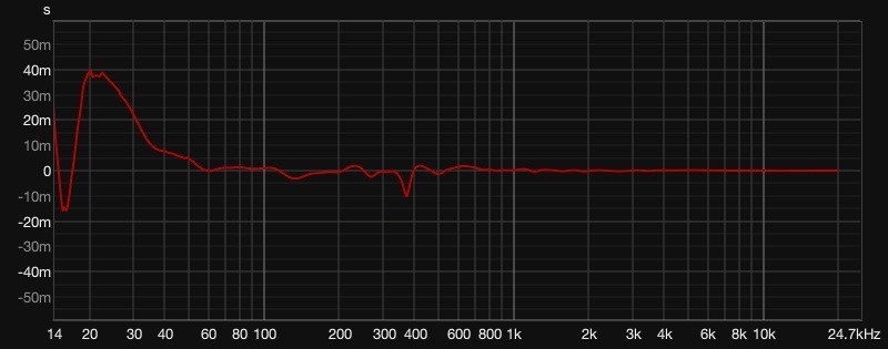

It’s getting close. There’s still some phase issues at the crossover points, at 400 Hz and 5kHz, but it’s much better than previously.

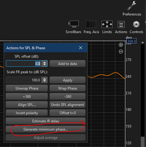

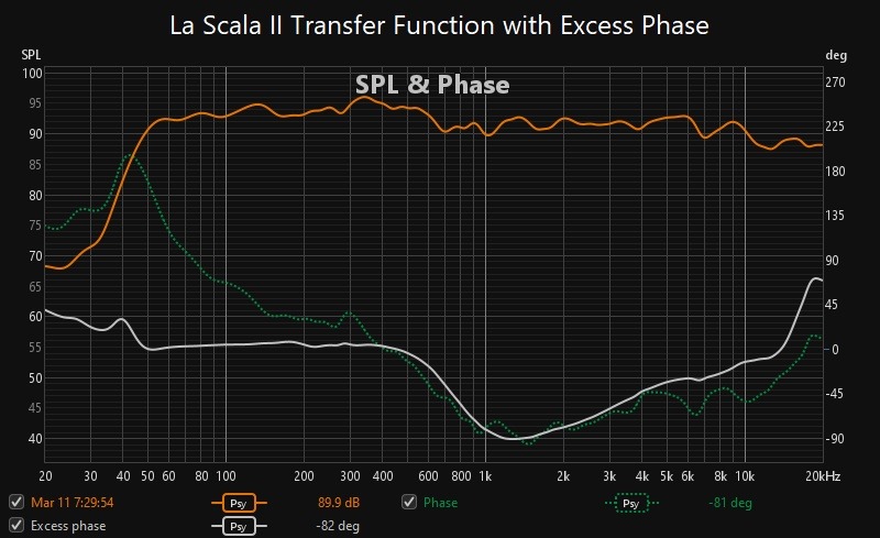

One thing that you'll find within REW is the "Generate minimum phase..." button under the Actions menu on the upper right side of the SPL/phase plot:
When you select that option, REW will calculate the Hilbert transform of the amplitude (SPL) response, then compare that (minimum phase) curve with the total phase curve that was measured (i.e., "excess phase"). The excess phase curve shows you the all-pass contributions of the crossover filters and any movement toward or away from the microphone of the effective acoustic centers of the drivers themselves vs. frequency. For instance:
When using IIR filters only, you can't really do better than a zero excess phase curve as shown by the white line plotted above for a stock La Scala II (tri-amped).
The same thing is true for the numeric first derivative of the excess phase curve--i.e., excess group delay (also generated by pressing the "Generate minimum phase..." button within the group delay plot window, then selecting the excess group delay curve plot button below the plot):
Since numeric derivatives are noisy processes (as compared to numeric integration - like step response from time-based impulse response), you have to take some care during in-room measurement to minimize early reflections, and use curve smoothing to average out the resulting calculated group delay curve to sweep away generated numeric noise.

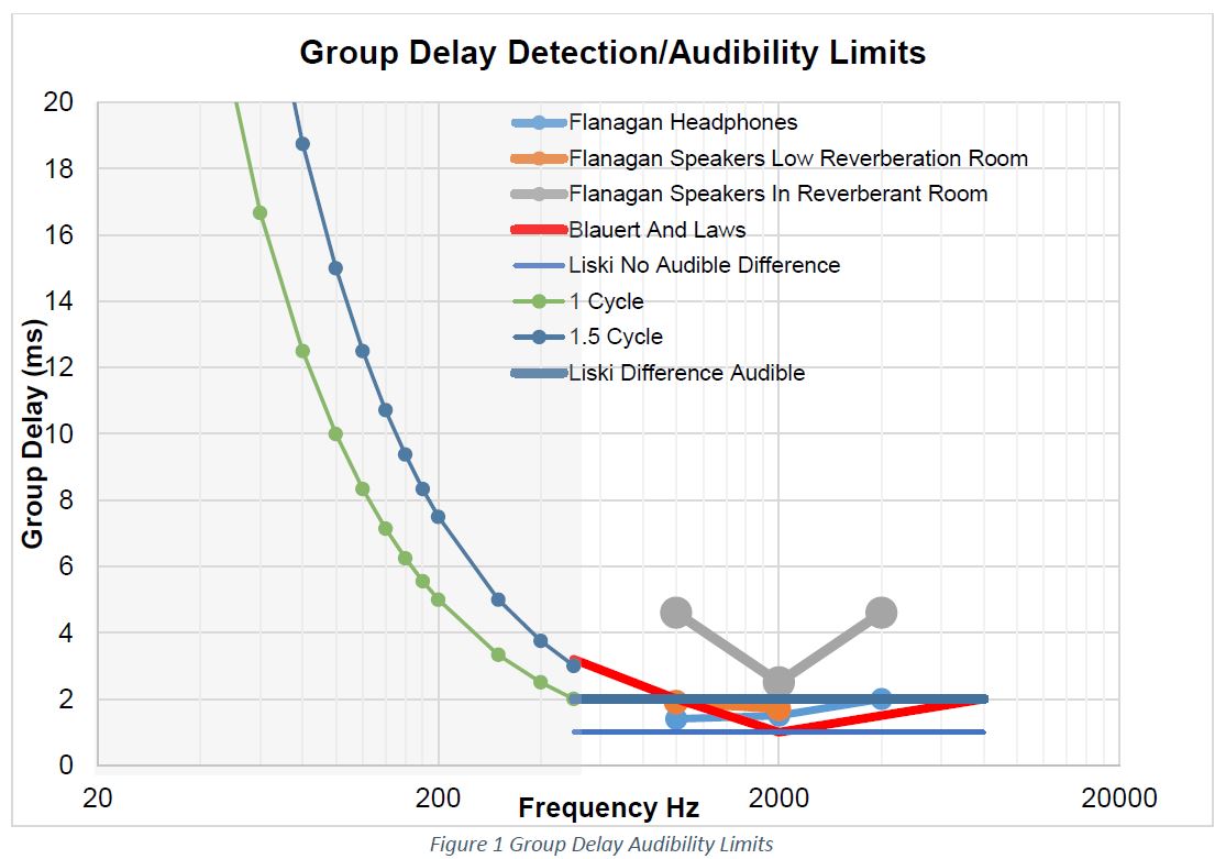

In the plot above, excess group delay curve tells you how well the dialing-in process was accomplished. Note that group delay audibility is sensitive to frequency, so at midrange frequencies (~300 to ~2 kHz), group delay audibility threshold is on the order of 1 millisecond. For lower frequencies, the audibility threshold is something like a function of a wavelength period:

Always good to recall that audibility limits are estimates of an average for a population. IOW, they are an estimate of the center of a bell curve. What they are not, is they are not hard limits.
Therefore it might be good to aim for a couple of standard deviations below the limit. That way you cover well more than the limit for only 50% of the population.

So for bass frequencies well below 100 Hz, as long as the group delay is below something like ~50 ms, you're probably not going to hear the effects of it. That's a key insight. Excess group delay tells you how much time misalignment you have between drivers in a multiway loudspeaker. You can read this misalignment in milliseconds as a non-zero group values (as I've discussed and illustrated before, on this forum and on the K-forum).

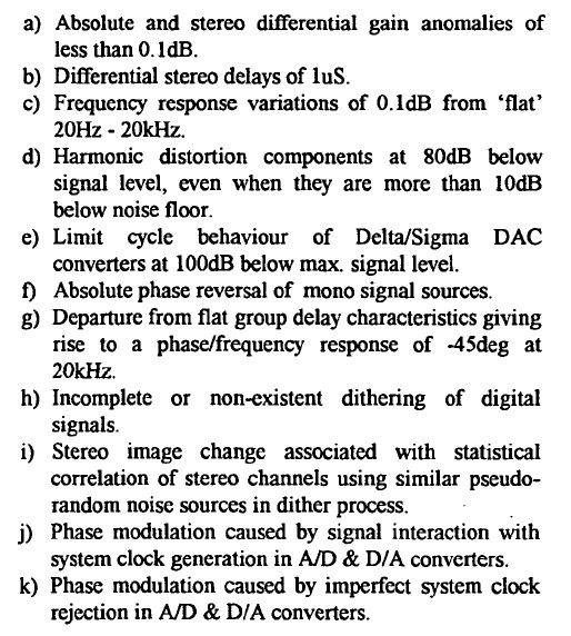

For example, here are some things found to audibly affect the sound of a professional digital mixing console:

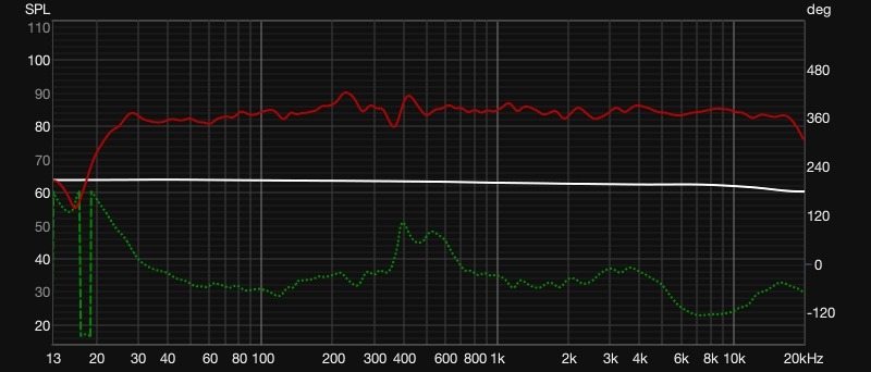

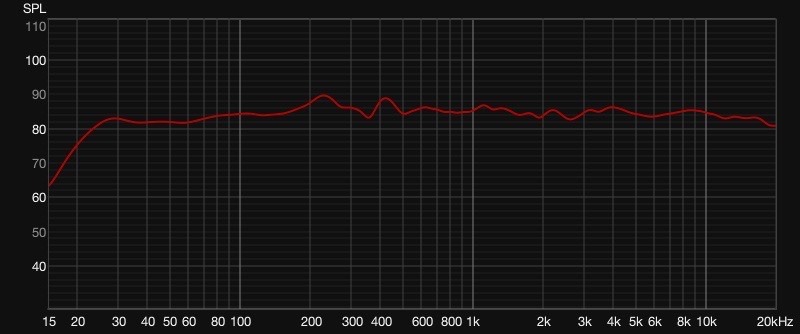

Chris,

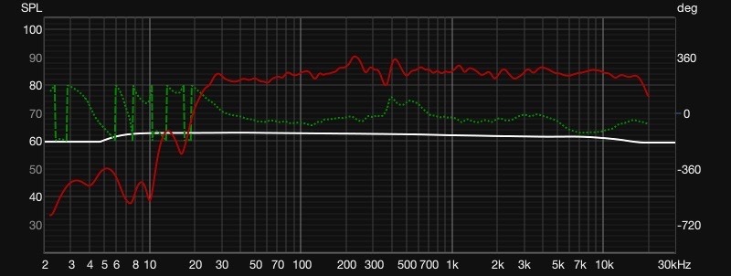

I've got it sounding really, really good now, but following the rubric, "perfect is good enough," there are still measurable phase/alignment anomalies at roughly the woofer/mid crossover point:
SPL+Phase
SPL:
group delay:

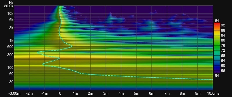

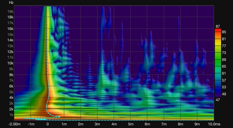

Spectrogram:

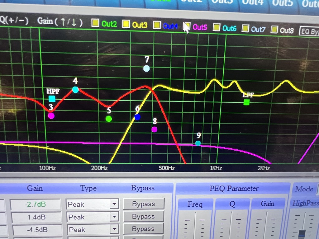

this is what my crossover looks like:

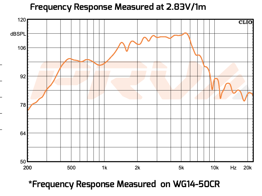

and lastly, mid response with PRV WG45-50 18"w x 10"horn, in red, courtesy of @THD+N :
@Cask05 , what can I do to reduce the anomaly between 375 Hz and 600Hz? is it worth trying and will I be able to hear the difference? presumably, this is caused by driver overlap? :scratch:
The spectrogram shows that the woofer channel could be a little too advanced in time alignment...by perhaps something like 2 ms.
The minimum phase curve should be somewhat growing from high frequency to low. You will also find that the excess group delay curve, when zoomed-in to no more than 1 ms minor subdivisions vertically, will tell you the same thing--only with a bit more fidelity than the spectrogram view.
I would recommend trying reduced midrange and tweeter channel delay settings, by equal increments, to push the bass bin time alignment back by ~2 ms.
When attempting to flatten the phase response across all channels in a loudspeaker using DSP, it's not always clear how far one can go to reduce the lower frequency driver phase and excess group delay growth. If you go a little too far, it starts to show up in the step response plot, with the low frequency drivers leading the higher frequency drivers slightly. Usually when this occurs, there are also disturbances in the SPL response curve smoothness at the crossover transition band.
To find out if this is occurring, just reduce the effective advancement of the lower frequency drivers a bit, then look to see if the SPL, phase, and group delay responses smooth out a bit.
Also, you can try flopping the woofer channel polarity (thus bringing the woofer and midrange channels 180 degrees closer together) and then readjusting the fine-tuning on the upper frequency channel delays to match the SPL, phase and group delay values through the crossover transition band.
You can also move the microphone position slightly to see if there is a better location to measure the combined output of the loudspeaker.

Chris, @Cask05, thanks. 2ms was a bit much, but 1ms made the sound somewhat more coherent, but threw off the eq and driver gain. More measurements with flat eq will be required to tune it in before I move to the left channel, but boosting the non-corner loaded left side by 6 db has put it in the ballpark. Incidentally, I googled after the fact and found that corner loading adds about 6dB of gain, so my intuition was not misplaced. More measurements this weekend and hopefully I’ll be a bit closer.

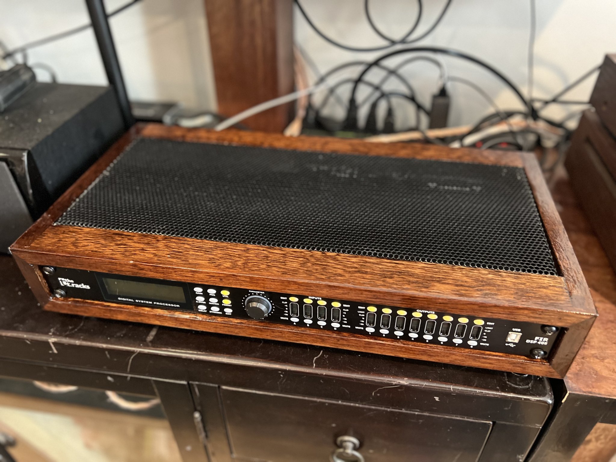

And it’s a wrap! While I don’t find it necessary to increase the ventilation, I made a new, 1U enclosure that leaves that possibly open. I have a small pile of mahogany scraps from work that I’ve been saving for just this occasion and a pair of rack ears that I trimmed to fit. Up top, I made a new grille out of material I had laying around from a Klipsch KP-362 that I’d parted out. I also added some speaker spikes on the bottom to pull duty until I get some proper feet.
My next project will be to make the wires disappear
