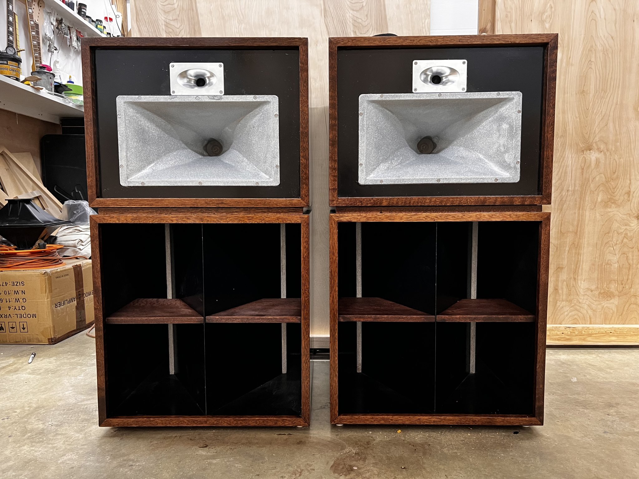

I'm currently multi-amping my LaScala clones, using a Dayton Audio DSP-408 active crossover. There is a lot to like about it in terms off functionality: 4 channel in, 8 out; 10 bands of parametric eq per out, up to 24db Linkwitz-Riley/Butterworth/Bessel filters and a 20hz-20kHz response. It had a decent UI, with bluetooth/iOS connectivity and a windoze interface, as well. However, I would like to improve the noise floor, is has a slightly perceptible hum that is present when music isn't playing. It's entirely single-ended, but I would prefer balanced, at least as an option. Finally and this is the biggest issue for me: the DAC is limited to 48Hz, 28-/56 Bit processing, which regardless of whether it's audible or not, effectively nullifies my Schiit Audio Bifrost 2's 192Hz, 24 bit capabilities for hi-res audio file playback.
What options are available to maintain the functionality aspects that I like about the Dayton Audio DSP 408 (ins, outs, 10 band PEQ, filters & frequency response, ui and relative affordability) with better processing, at least 96Hz/24 bit, but preferably 192Hz, 24 bit, balanced inputs and outputs? I know there are pro options from companies like Ashly that are more expensive than I'd prefer and more affordable pro options from dBX, Behringer and others skimp on PEQ, or ins/outs and/or have poor UI functionality... I'd prefer to keep in the $500 ballpark (I'm ok with used components) and this is a big ask, have either iOS or Mac OS UI.
can this be done?

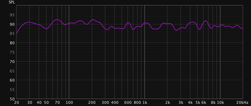

I have managed +/- 3dB the the Dayton, from 23Hz to 20kHz
I've also got my time alignment fairly well sorted
while $500 is my platonic ideal, I'll accept that I may have to spend more, but my diy Lascala notwithstanding, my most expensive components list between $1100-$1350, so I suppose that's a psychological price barrier for what I'm willing to spend for a crossover.
in a perfect world, I'd love a solution that would allow me to use, say, an 8-channel digital audio interface, such as a Zoom TAC-8 (which I already have in my recording studio) or a Focusrite Scarlet 18i20 which are readily available for around $500 and a Mac-based DSP software solution, since I'm already using the MacBook Pro for a streamer. It should be possible to use the hardware in this manner, provided there is suitable software available.
I have managed +/- 3dB the the Dayton, from 23Hz to 20kHz...

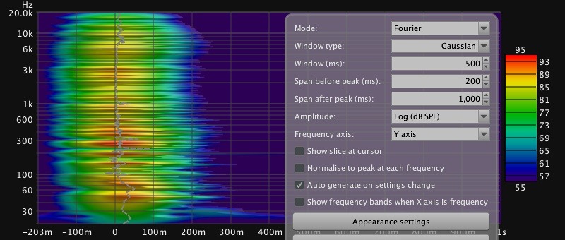

Here's what I've learned about displaying plots in REW:
1) show SPL/phase plots with vertical resolution in increments of no greater than 1 dB (minor scale) and 2 dB major scales. Then you can actually see what you've got.
2) The spectrogram view should have no more than 10 ms displayed horizontally when looking for the degree of time alignment of drivers/horns.
3) show an excess group delay plot within the "GD" (group delay) plot, which is available after selecting "generate minimum phase" from the "Controls" menu on the upper right on the plot, then checking the "excess group delay" check mark below the plot. Make sure that the vertical scale on this plot is no larger than 10 ms full scale.

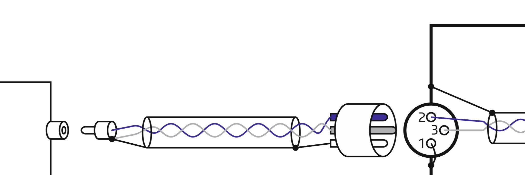

Before you buy something else, have you tried using balanced conductors?
Even though your DSP has single ended outputs, I have had to do this because all my amps require XLR inputs.
I find them quite effective at rejecting noise. I don’t have horns but my midrange is 100+ dB/2.83V.
These easiest way to do this is to buy pre-made long XLR cables, snip then in half, and attach RCA connectors of your choice to each end.
See attached wiring scheme.
