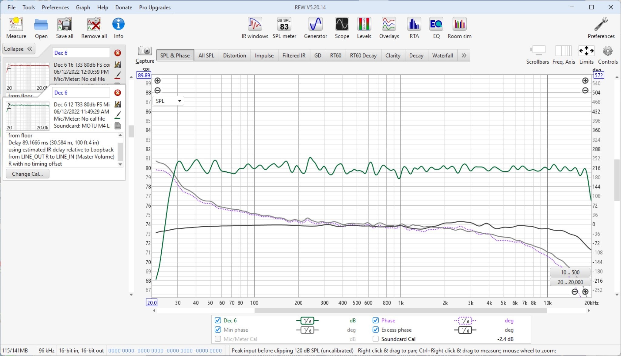

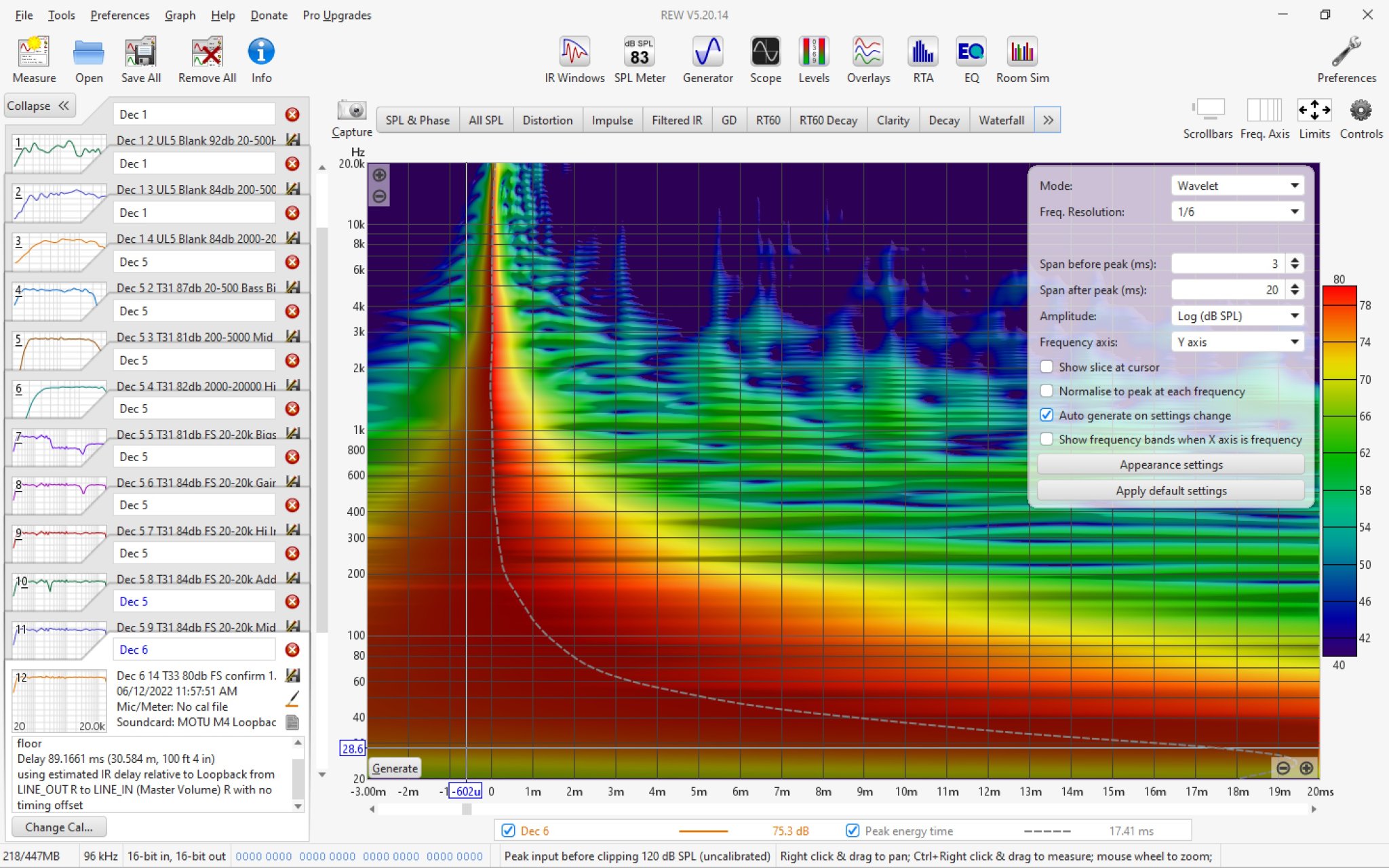

CamillaDSP on a RaspberryPi 4 and a Motu Ultralite Mk5 USB Audio Interface. For around $US700 and an hour setting up the RPi you have a full featured web controlled DSP - FIR, PEQ, Gains, Mixers etc and the Motu UL5 will give you all in I/O you need. .I'll add that I'm more interested in a solution that is mostly plug and play. I'm open to adapting software and hardware that is usually used for other purposes, but I really don't want to build hardware or write my own code.
https://www.audiosciencereview.com/forum/index.php?threads/rpi4-camilladsp-tutorial.29656/
I can put a zipped SD card image up on Dropbox for the RPi that is working and would save you time.
I tri-amped my modified K-Horns and detailed the process here
https://www.diyaudio.com/community/...overs-room-correction-etc.349818/post-7213813
The CamillaDSP selects the source and is controlled by a remote
https://audiosciencereview.com/forum/index.php?threads/rpi4-camilladsp-tutorial.29656/post-1579025
Compared to miniDSP 2X4HD the CamillsDSP / Motu UL5 is silent and far more flexible.
Since these measurements were made I have experimented with "room curves" to give a bit more life to music.

View attachment 1268101 View attachment 1268103

How do you do you EQ tuning work in Camilla? IIR, FIR, or combo?
Great results, however you're doing it
It has a GUI, it is pre-compiled, just need to download and unzip it. If you can copy / paste you can get this running. Once you have it up and running you can use the GUI to manage everything from any device with a web browser that is on the same network as the computer running CamillaDSP.
