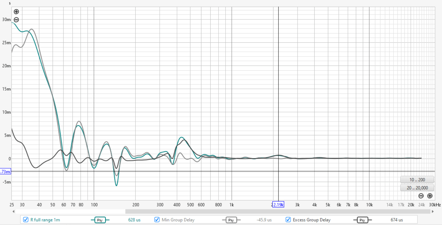

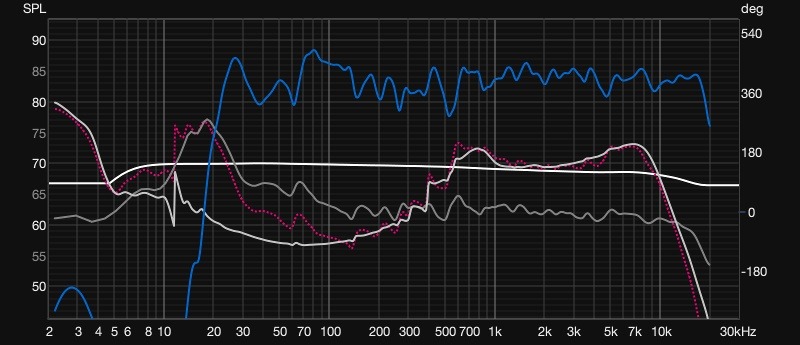

Chris, thank you for your patience, I've attempted to adjust based on your parameters and I feel like I've made some progress, but I also feel like I've been chasing my tail for the last hour or so, trying to get the quasi flat phase alignment you've alluded to. I'm far from a dummy, but I've got an artist's brain, not an engineer's and this is making me feel more than a little dense, like I'm only groking about 25% of what you're putting out. I'm feeling a little in the weeds.That phase looks like you need to zero the "IR delay" from the actions menu on the upper right, then select "shift IR". If you have prior versions of REW than the last couple of months, that menu item can be found on the "Controls" menu instead.
Additionally, I'd recommend putting a lot of absorption on the floor between the microphone and the loudspeaker (and I hope you're taking measurements from 1m in front of the loudspeaker--no farther away), with the width of the absorption about 6 feet wide. Point the microphone at the loudspeaker--not at the ceiling, and make sure you're using the correct microphone calibration file for pointing at the loudspeaker if you're using a UMIK-1.
All these things will clean up the phase response within REW considerably.
Additionally, I'll again ask for you to zoom in on your vertical scale to minor divisions of 1 dB and phase divisions more like 180 degrees (full scale). The group delay minor divisions should be no larger than 1 ms.
Chris

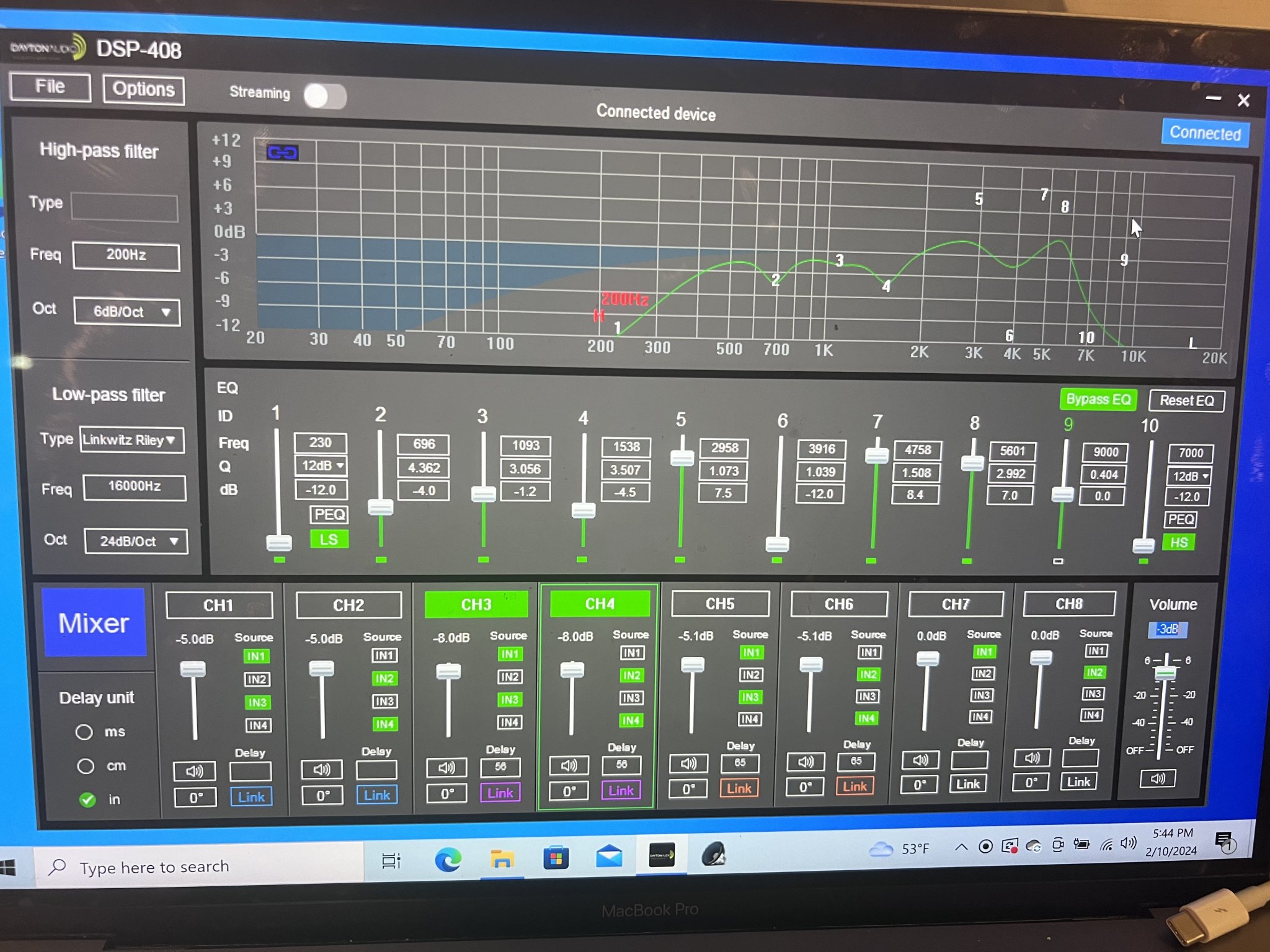

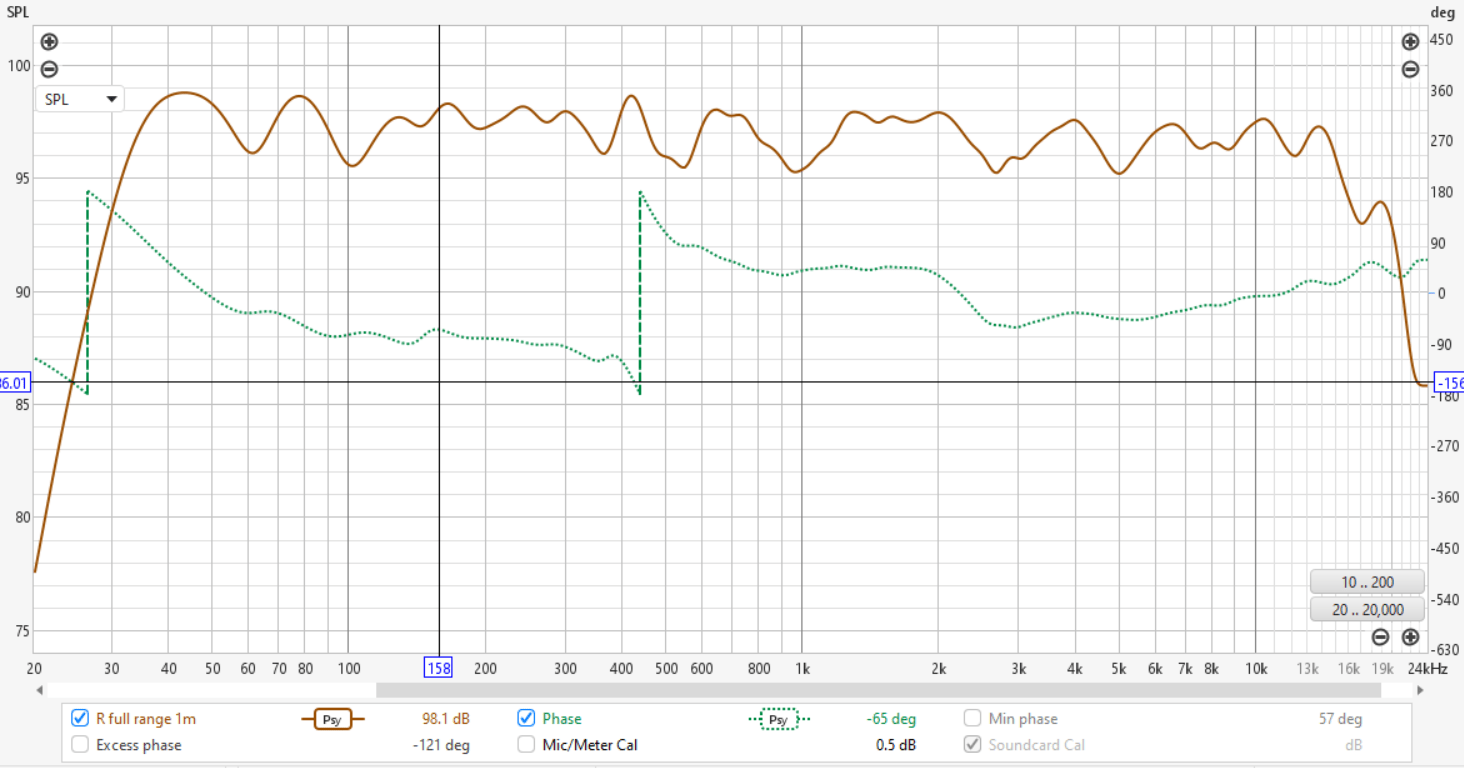

here is my SPL and Phase measurements after zeroing out the IR:

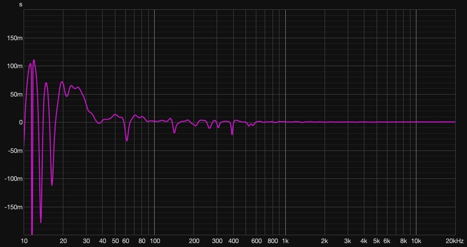

here's the group delay:

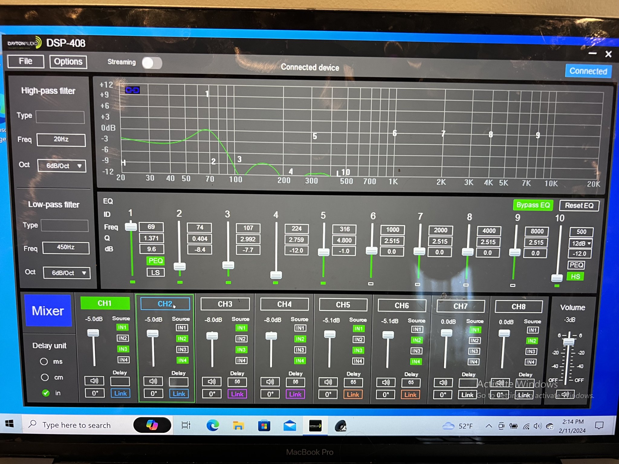

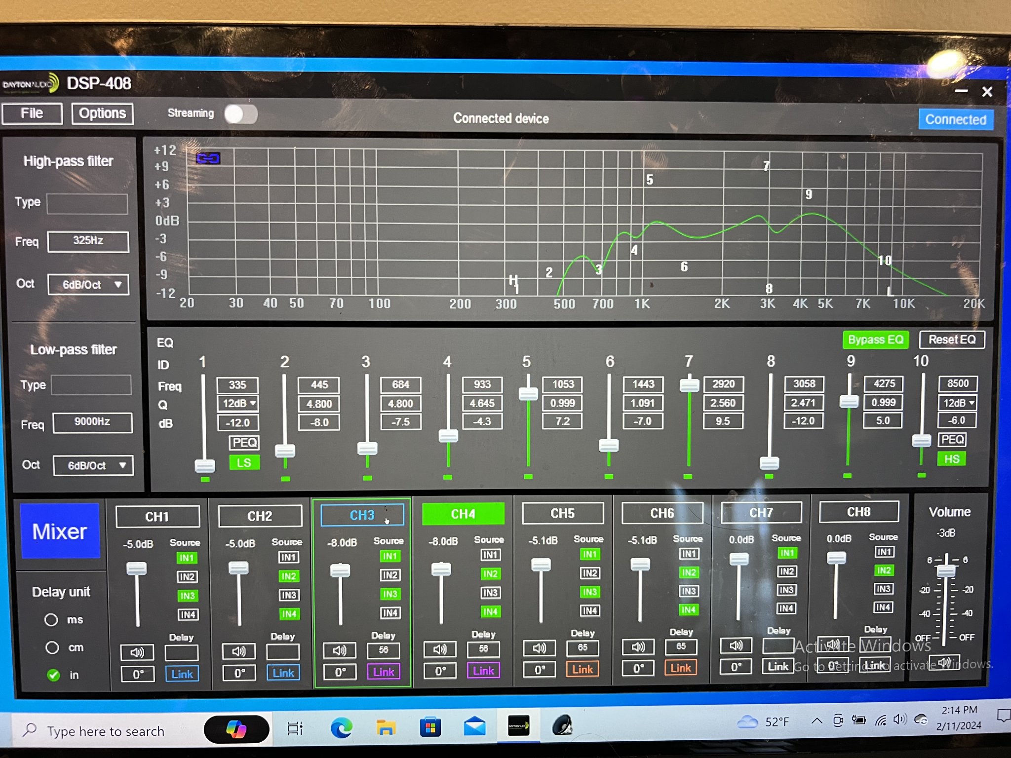

crossover points are at 400Hz and 6kHz, these are my settings for the shelf and PEQ filters, I think I may be a little ham-fisted with the application:
again, thank you for your patience and please accept my apologies for being thick-headed.

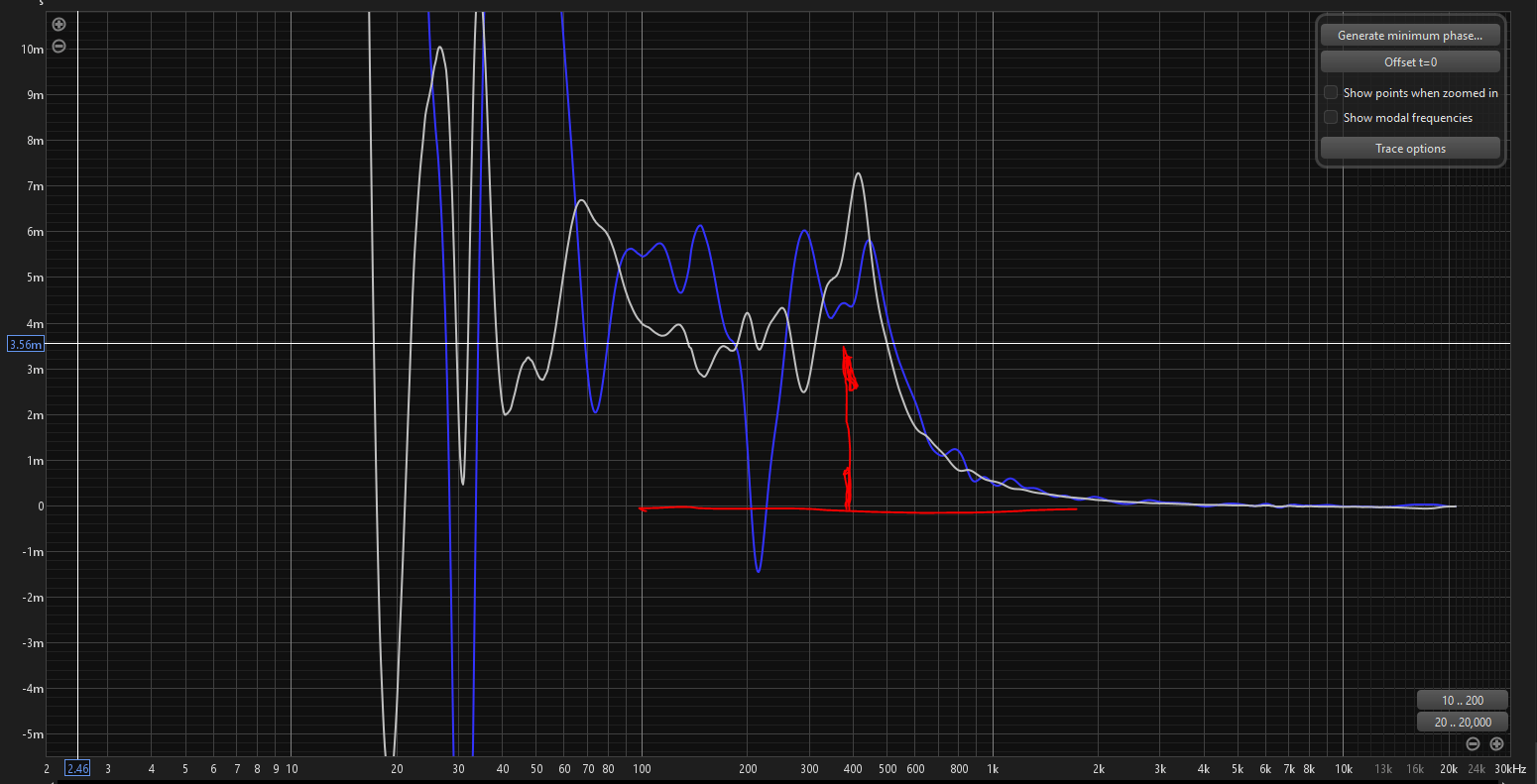

That phase curve below 600 Hz shows that you've likely added a bit too much delay to the higher frequency channels, since the phase line is going negative below that frequency.Chris, thank you for your patience, I've attempted to adjust based on your parameters and I feel like I've made some progress, but I also feel like I've been chasing my tail for the last hour or so, trying to get the quasi flat phase alignment you've alluded to. I'm far from a dummy, but I've got an artist's brain, not an engineer's and this is making me feel more than a little dense, like I'm only groking about 25% of what you're putting out. I'm feeling a little in the weeds.

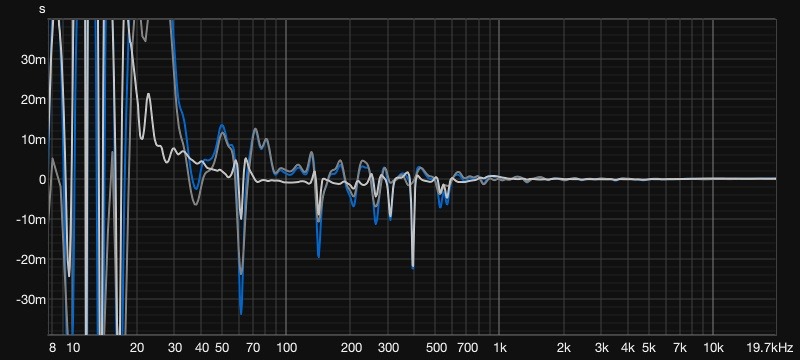

In order to see this for sure, go to the group delay plot, then zoom way in on the vertical axis until you can see 1 millisecond minor divisions (1 ms) on the vertical axis scale, then go over to the controls menu on the upper right above the plot, then select "generate minimum phase" and then "generate" or "generate and close". Your group delay and excess group delay plot (making sure to check the plot box below the graph in order to see this curve) will now be able to show you directly your time/phase alignment of the different ways, sort of like this:
The above excess group delay plot (white line) shows a 3.56 ms delay from high frequency to low frequency (red markup lines). That means I would need to crank in an additional 3-3.5 ms of delay on the higher frequencies than I had when I took this measurement. In your case, the white line probably goes below the 0 (zero) ms line by about 1-2 ms, in which case you'd remove that amount of delay from the higher frequency channel(s), or if you don't have any or enough HF delay to subtract from, then add delay equal to the bottom of the excess group delay horizontal tangent line value to the LF channel.
Now this is all assuming that you're crossing over at about 600 Hz. If not, then something else is occurring.

The transfer function disturbances (amplitude and phase) usually are measured above or below the actual crossover frequency, so that's not a surprise.I'm crossing at 400Hz, so something else may be going on there...
The fact that it's a negative excess group delay spike says that it's likely an internal reflection or a reflection by something nearby--at ~17 inches from the bass bin centerline (i.e., half-wave bounce peak, as opposed to a quarter wave bounce notch).I'm somewhat concerned about the spike at 400Hz; the excess delay below that is likely caused by the passive radiator mounted in the back of the upper enclosure.
Excess group delay spikes are the primary way that you can separate reflections from minimum phase driver/enclosure resonances. You can't EQ out peaks or notches if the excess group delay curve shows non-flat behavior at the frequency of interest--a little tidbit I picked up from D'Appolito's little Testing Loudspeakers paperback, 1999, Audio Amateur Press.

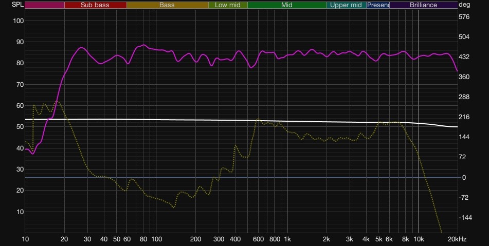

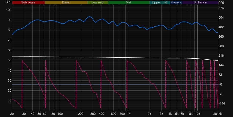

I spent some time yesterday with my setup until the kids got tired of hearing the bwoooooeeeeep from REW.
I definitely still have a phase shift between the drivers, but much less than I had on my old measurements.
and the GD screen.
I was crossing over at 400 and 2000.
Already the kids have all mentioned that it sounds clearer/more focused than before.
