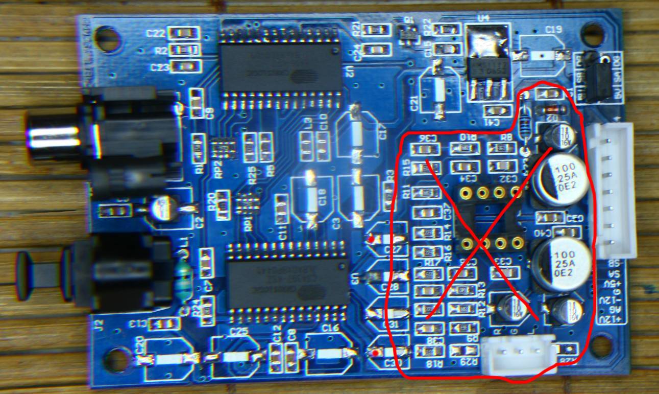

Hi Paul, it's nearly as simple as that. Here's a site where the author has been a little neater in his schematic than Lampizator.
The Lampizator Experience
Essentially, you use a low value resistor (I used 100 ohms, this is marked * on the link) to convert the current output to a voltage: this voltage then controls the current flow through the SRPP.
All I did was pull out the 3 op-amps, stuck a wire into the vacant hole in the op-amp socket that ran to the 100 ohm resistor (one each channel, obviously). The SRPP then works as standard.
The current out DAC is balanced, to be correct I guess you should use the same polarity for both channels. I don't have the schematic to hand, there was some asymmetry in the op-amp wiring, I ended up using socket 2 for the left channel and socket 6 for the right channel. If this is unclear let me know and I'll reply with reference to the schematic.
The wire I used from the op-amp sockets was solid core so it jammed in nice and solid, if all you have is multicore you could solder it. A nice thing about not soldering is that you can reverse it and put back in the op-amps if you liked. Or maybe you could solder onto the bottom of the board, not sure if the op-amp socket pins go through or not.
One (maybe) issue is I gave nowhere to go for the other half of the current from the DAC. Would this make it upset? Should I have given it a path to ground as well? Where is the emoticon for shrugging my shoulders?

all clear except the picture I was looking at has one AD827
I see on the gigaworks picture that there are three op amps.
Pull all three, install the wires to the lampizator into the holes for the opamp closest to the DAC?
I'm at the fact gathering stage, and just about convinced I can do this, so will now order my board.

Hi Paul, that's right, the two op-amps closest to the DAC. You should take a look at the schematic, the output stage is pretty straightforward if you're even a small bit familiar with op-amps. BTW I do not recommend removing the capacitors unless you're delicate of touch, the traces seem to be attached with angel kisses or similar. I don't think I'm particularly hamfisted, but it didn't take me long to despatch the DAC to IC heaven/valhalla/elysian fields.
