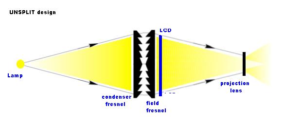

Unsplit design
dear friends
Please clear my doubt regarding the placement of groved side of fresnel in a Unsplit design.Is the drawing i have attached is correct.
with regards
Srinivasan
dear friends
with regards
Srinivasan
Grooves should face each other - rear fresnel grooves face the
front fresnel and the front fresnel grooves face the rear fresnel. So it
appears your drawing is fine. The rear fresnel is usually the shorter
focal length (220mm or so), and the front fresnel should match the
focal length of the triplet lens.
