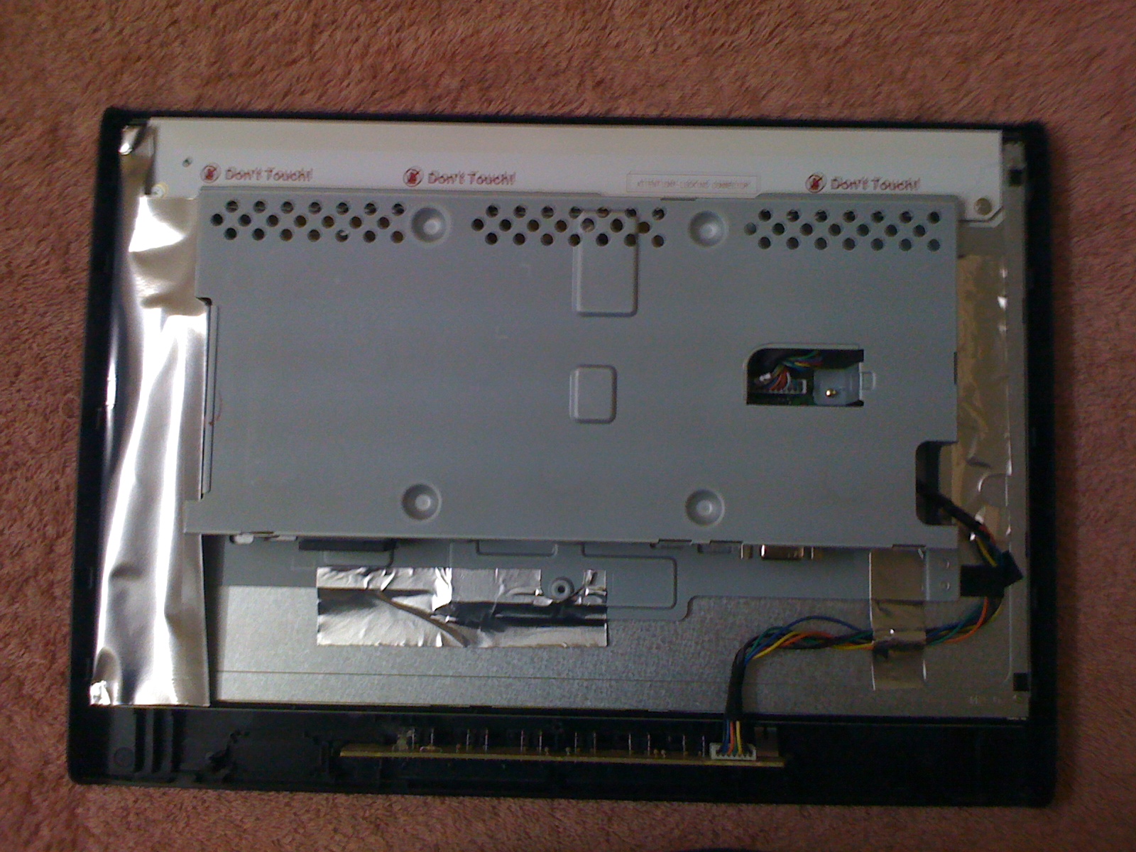

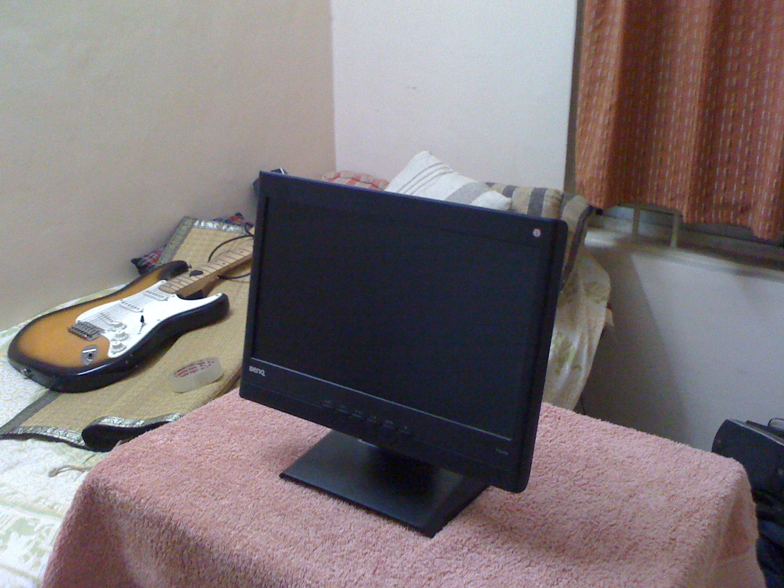

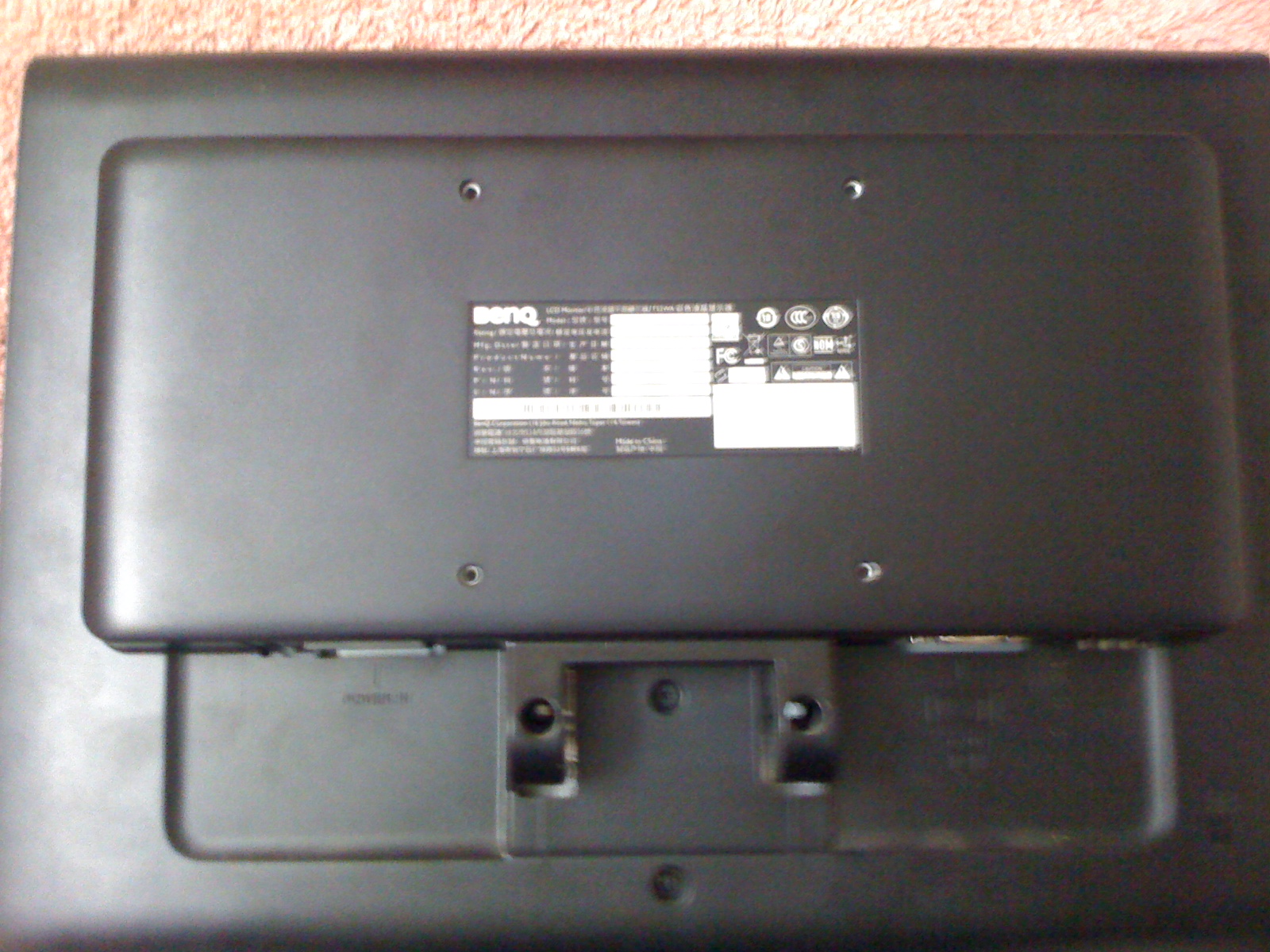

After three years since my first build (using a super 7" lcd) I've started with the second build. You can see the design and the results of the first build in the previous posts of the forum. I plan to keep the same design and use
1. S15 standard lumen lab lens kit.
2. Benq T52WA lcd monitor.
I started stripping the Benq T52WA monitor and here are the few pics.
I'm stuck in one step where we need to remove the 3 screws which attach the FFC and the controler board with the backlight. These screws are flat and extremely small. I tried around all the possible but nothing worked out. I'm a bit cautious while applying too much pressure as it might crack the circuit and also there are chances of the screw head getting spoilt (if thats not what happened already). If anyone has already stripped this before can you just help me out with this problem.
The monitor before stripping:
Back:
The Back casing removed:
Removed the backlight power supply:
The screws which have started creating the problem is circled in red. Any ideas??
