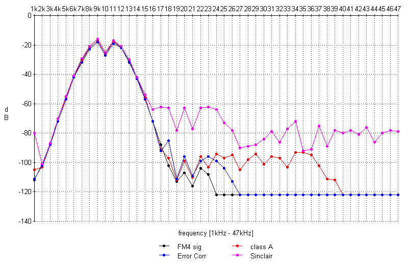

I have added measurements of the Sinclair-Z30 amp to the page
http://web.telecom.cz/macura/fmanalysis/freqdist.html
This is the class B, quasi-complementary amplifier with dif. input stage, VAS + CCS. This amp was my "reference" in the seventies , and it is one of those where you can hear distortion of the pure 1kHz sine (as higher harmonics from the tweeter), though THD is less than 0.5%. Please compare with results of the other two amps. In this case, there is a perfect correlation between measurement and listening tests .

I do not know if this helps, but I have plotted 4 curves into 1 graph for FM signal no. 4. You can see envelope of the original spectrum and spectral envelopes for all of the amps under test. In this image I would like to demonstrate my usually used terms "mess" and "tail". Look what the amp with higher distortion (Sinclair) is doing with the signal. It produces wideband noise (mess) that makes the music nervous and unclear. This mess can also be seen at Sinclair 13+14 kHz IM measurement. Probably you will understand now what I mean when I am speaking about "silence under tones".

the output noise (i.e. without signal) is not very different for all of the amps tested. The "mess" is produced by distortion. In case you test by 1 sine signal you may not realize this fact. But multitone discovers the phenomenon.
I should add that I have shown envelopes of discrete lines (dots). I have also prepared data for comparison excel charts (output harmonic components with signal components subtracted).
Pavel,
Indeed such diagram is more interesting. But I'm interested in difference
between Class A and Error Correction amps. Does it mean the last one
has much more clean spectrum (I mean higher harmonics lower faster)?
Or - what?

Yes - exactly. For these 2 amplifiers tested it is true.
I mean, that very interesting should will be, if you compare this results, but by different output levels. I mean, that if is distortion small, ear or brain stop this perceive like distortion, but if this level of distortion is not constant, we perceive it like " tail " below music.
