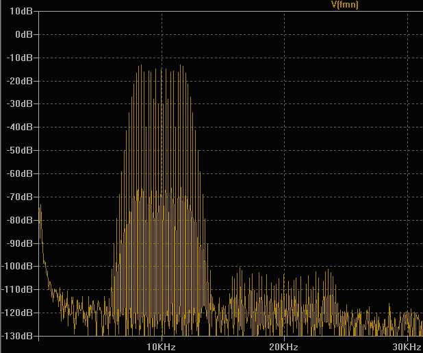

Right. In addition it seems infiniteness of FM spectrum is exagerated. I tried LTSpice simulation, and the spectrum drops to below -140db very fast within audio band.PMA said:wimms,
I went quite thoroughly through your analysis at
http://www.diyaudio.com/forums/showthread.php?postid=512699#post512699
I mostly agree but I have a small comment: the FM signal was generated by sound card at sampling rate of 48kHz, so it was bandwidth limited to 24kHz. Amplifier under test had much broader bandwidth, so it should not bring much linear distortion.
IIRC, the gist of infinite spectrum of FM is related to linear change of frequency, where delta-f and delta-t are approaching zero. To express that, you'd sorta need infinite precision in both time and frequency. The infinite bandwidth is kinda expressing infinite precision.
With PC generated signal we aren't really even close to such precision, so I wonder if what we get is discrete frequency changes after discrete timesteps.
What is your interpretation of your opamp measurement results, in terms of what non-linearities are exposed? To me their spectrums look suspiciously like exact clones, and I'm wondering if that is really exposing any nonlinearities of amps or rather some measurement issues..
I wonder what effect tested opamp propagation delay has on the re-sampled results. The same audio card outputs the test signal and records the delayed result. Could the delay cause changes to measured spectrum? Loopback test has no delay..
Well it should be added that they are not the spectra of opamps itself, but poweramp with opamp as a driving stage (schematic can be seen on the web page). For opamps itself (627, 134), exactly said in the audio buffer circuit, there was almost no difference between test signal spectrum and output of the audio buffer circuit spectrum. For the power amp tested, it seems to me that it is a copy around the 2 x Fc frequency with amplitudes similar to harmonic distortion. The THD of the amp tested at 10kHz is higher to that of 1kHz.
Regarding the mess at the low frequency end, it is a problem of ground loop caused by card-out card-in measurement with amplifier inserted inside the measurement loop. With different signal source (like CD) this mess disappears.

Well, isn't then the ground loop modulating the signal? I tried to mimic your results by LTSpice simulation, by adding noise, 50Hz hum and signal correlated AM.PMA said:Regarding the mess at the low frequency end, it is a problem of ground loop caused by card-out card-in measurement with amplifier inserted inside the measurement loop. With different signal source (like CD) this mess disappears.
Right. And these should be visible with conventional THD means, shouldn't they.goudey said:To get to the question: what distortion mechanisms seem to be present?, it appears that 2nd and third harmonics are present, indicating that the 2nd and 3rd order distortion mechanisms represented in the formula above are present.
wimms said:Well, isn't then the ground loop modulating the signal? I tried to mimic your results by LTSpice simulation, by adding noise, 50Hz hum and signal correlated AM.
Maybe. To be sure, I am planning to build high performance differential testing amplifier to eliminate hum. But the results differ for different opamps in the same amplifier. For AD844 and LT1122 one can see 2nd a 3rd harmonic content, for AD797, OPA134 and OPA627 only 2nd harmonic.

The completely new results obtained by use of differential measuring amplifier and 6 different FM test signals are shown here:
http://web.telecom.cz/macura/fmanalysis/freqdist.html
Mike,
I assume that it is mostly a result of 2nd and 3rd harmonic distortion what we can see. Test signal no. 1 is close to 10kHz sine excitation of the amps. When having a look at the other signals results, one can see that there are copies at 2 x Fc and 3 x Fc of the original spectra.
