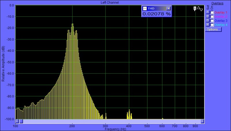

PMA,
have you tried this type of test signal on amlifiers?
amplitude modulated sine burst
(I tried once but with a not so good sound card on a laptop - results in the image. The device tested is a volume control.)

Well, one should test across the entire spectrum of course, say, in 1/3 octave spacings.
I just tried the 100 and 200 Hz AM sine burst that is on Linkwitz's test CD that is designed to test speakers. Nothing precludes producing higher freq. signals for testing amps...
MBK
MBK
MBK said:Well, one should test across the entire spectrum of course, say, in 1/3 octave spacings.
I agree. The reason why I test on higher frequencies is that I have found nothing interesting when testing at low frequencies.

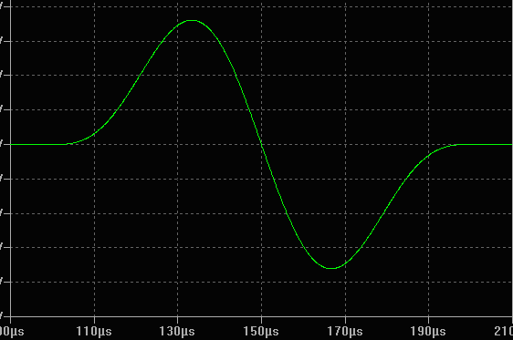

Toneburst
For amp testing, you might want most severe of tonebursts - single wavelet.
Its a carrier AM modulated by raised cosine of carrier. If single wavelet is passed through amp, its practically impulse with limited BW. Wavelet has spectrum of carrier +/- carrier, ie. 0, Carrier and 2*Carrier. Just two components.
It can also be constructed by summing 2 sine generators, then its wavelet train without gaps. 3 concepts converge here: wavelet, AM modulation, and simple harmonic synthesis.
Wavelet with carrier 20kHz is quite a severe signal for amp as it stresses its slew rate capabilities, linearity and ringing stability.
If single wavelet is sent, it is also safe to feed 100% power through the speakers, afaik.
If you construct repeating wavelet train, then you can quite easily make spectrum analysis.
But in terms of spectral content, its just 1st and 2nd harmonics. its most spectrally clean impulse you can think of.

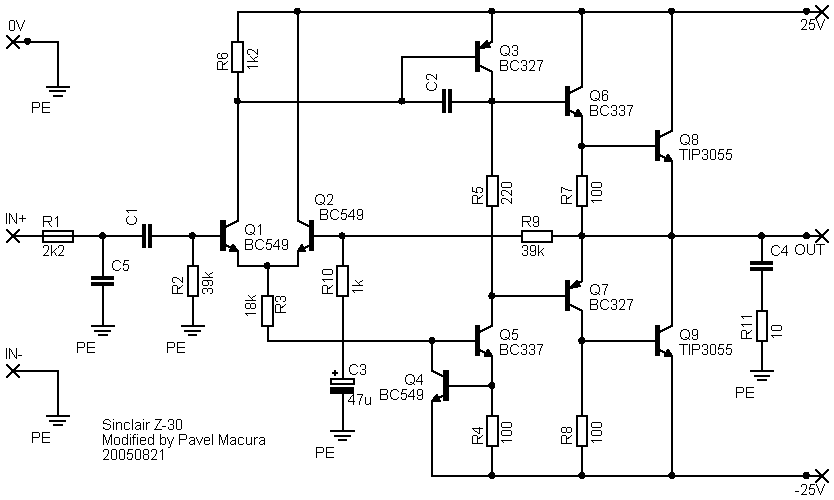

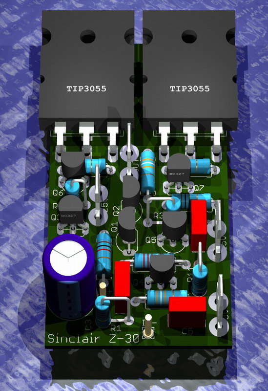

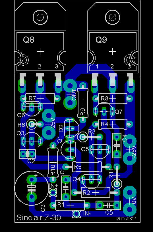

I am just publishing a friend's good art work
Related the circuit quality, i cannot talk too much, as i assemble this one 20 years ago, or maybe more..i do not remember the result.
But Pavel Macura, the name, by itself is a good presentation.
Greg Erskine made the "art work"
regards,
Carlos
regards,
Carlos
