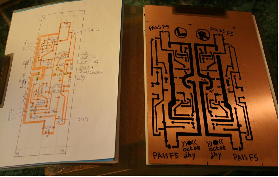

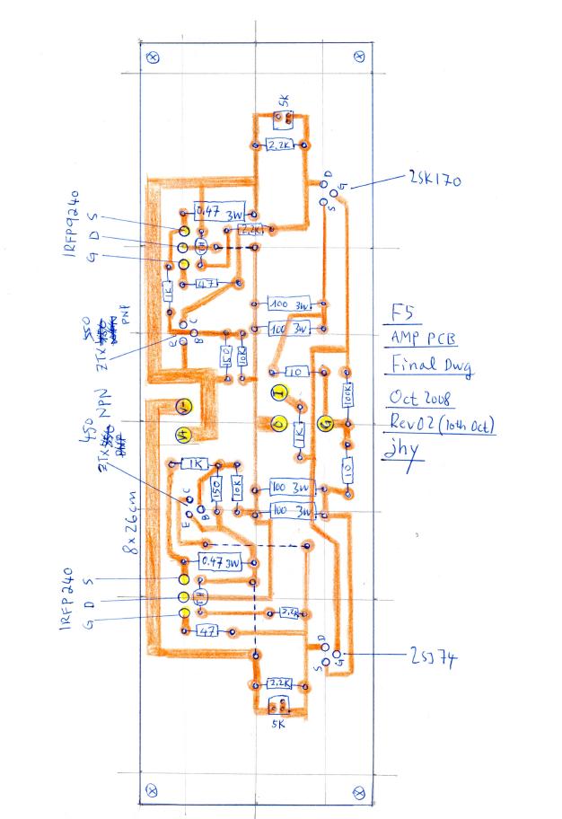

This is amp pcb plan, based on the circuit in the post #3.
Don't look seriously into the thicknesses of the tracks because they will be adjusted in actual building.

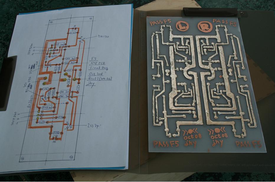

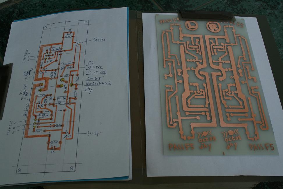

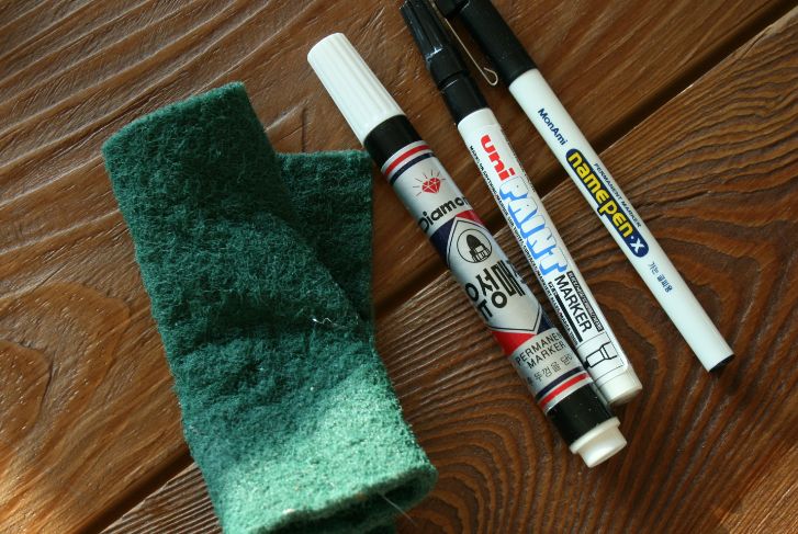

leapcat said:
Hi
I really like you hand drawn layouts and boards! What type of marker do you use and how do you clean them after etching?
Thanks :)
For drawing I use the oil-based marker (permanent marker) which we can easily buy in the stationary shop. For cleaning after etching I use the rough sponge in the kitchen. I rub the finished with the sponge in water.

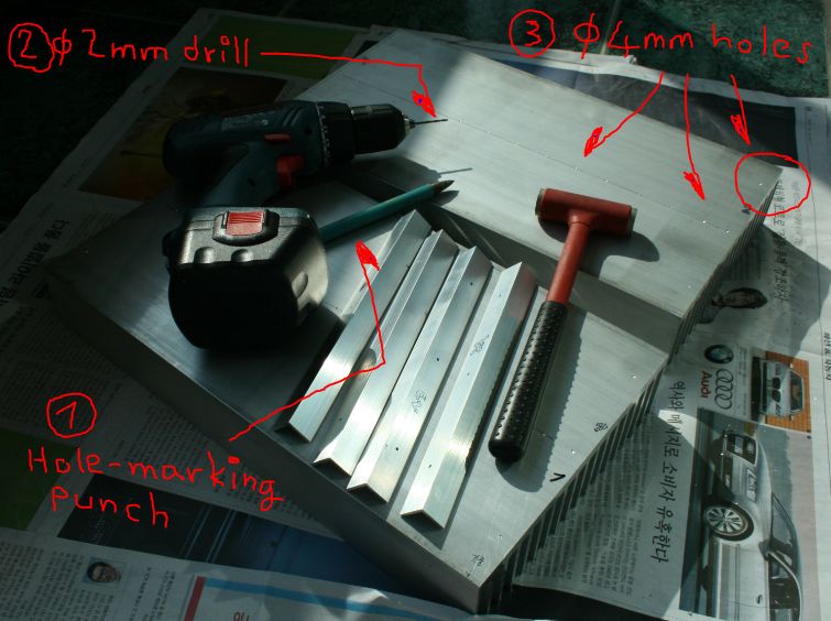

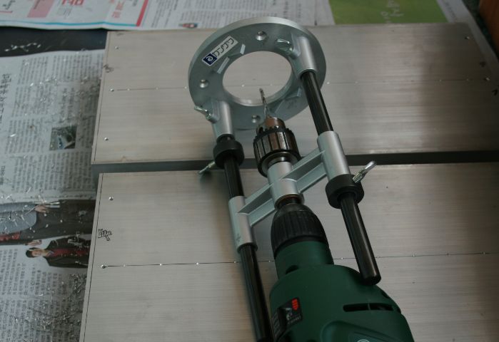

enzedone said:
You didn't have any problems with the drilling of holes?
When I was buying the heatsinks and 2mm-aluminium plates, I asked for the holes too. But, the shop said that they don't have man-power to make any hole. Pity . . .
I decided to make the holes myself.
My normal procedure is:
  1. First, I make hole puch marks to the right hole locations. The aluminium plate or surface is very slippery for the drill ends. So, I put the punch mark for the 2mm-drill end not to slip.
  2. Second, I use 2mm-drill on the punch mark to make the mark bigger.
  3. Third, I use 4mm-drill to make holes for 3mm bolts.
    [/list=1]
    The photo shows marks after finishing 2mm-drilling.
    In order to make the 4mm hols straight, I also use a special tool. I will show it to you later.
