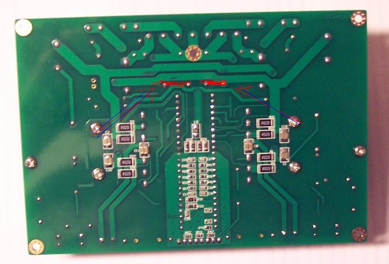

Hello Cristi, I got your reply. I enclose a picture of your board where I draw the two points that should be bridged in order to use the screw connectors once the rectifier bridge has been removed. The two arrows, are not that nice, but you can see the two briged points quite clearly I have drawn them in red.
Also, the + should be on the left side, and - is on the right. Am I right?
The PSU I built uses a center tapped transformer, and I will not remove the big capacitors as per your advice.
Please, just confirm that the drawings in the picture are correct.
Thanks!

just bridge the connection as in the photo, and measure the coresponding pins on the screw connector to connect them correctly.
