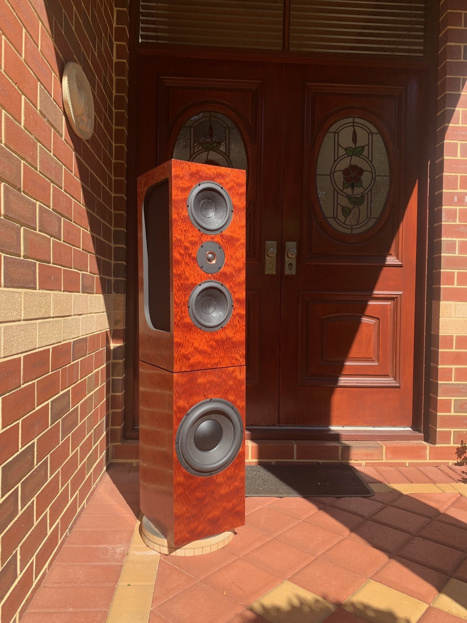

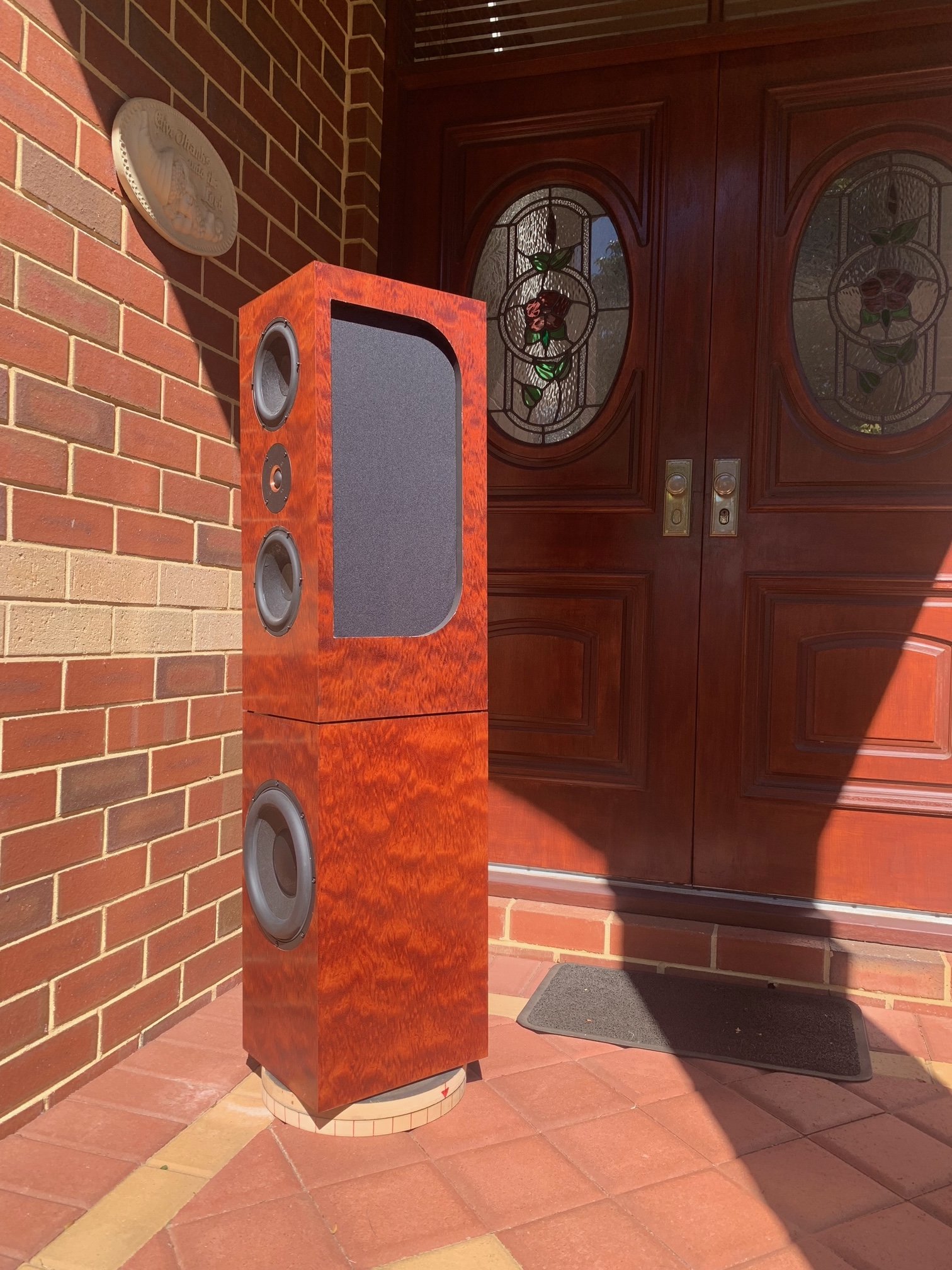

Here’s the last generation NaO-
I once took rear measurements of the NaO’s rear output and it was impressive. The measurements are one another PC somewhere, but essentially the rear output looks almost the same as the front.
Then John released his next generation full dipole 4 way NaO II RS, but life got in the way (work, marriage, kids) so I never managed to build it.
