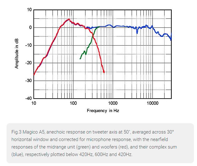

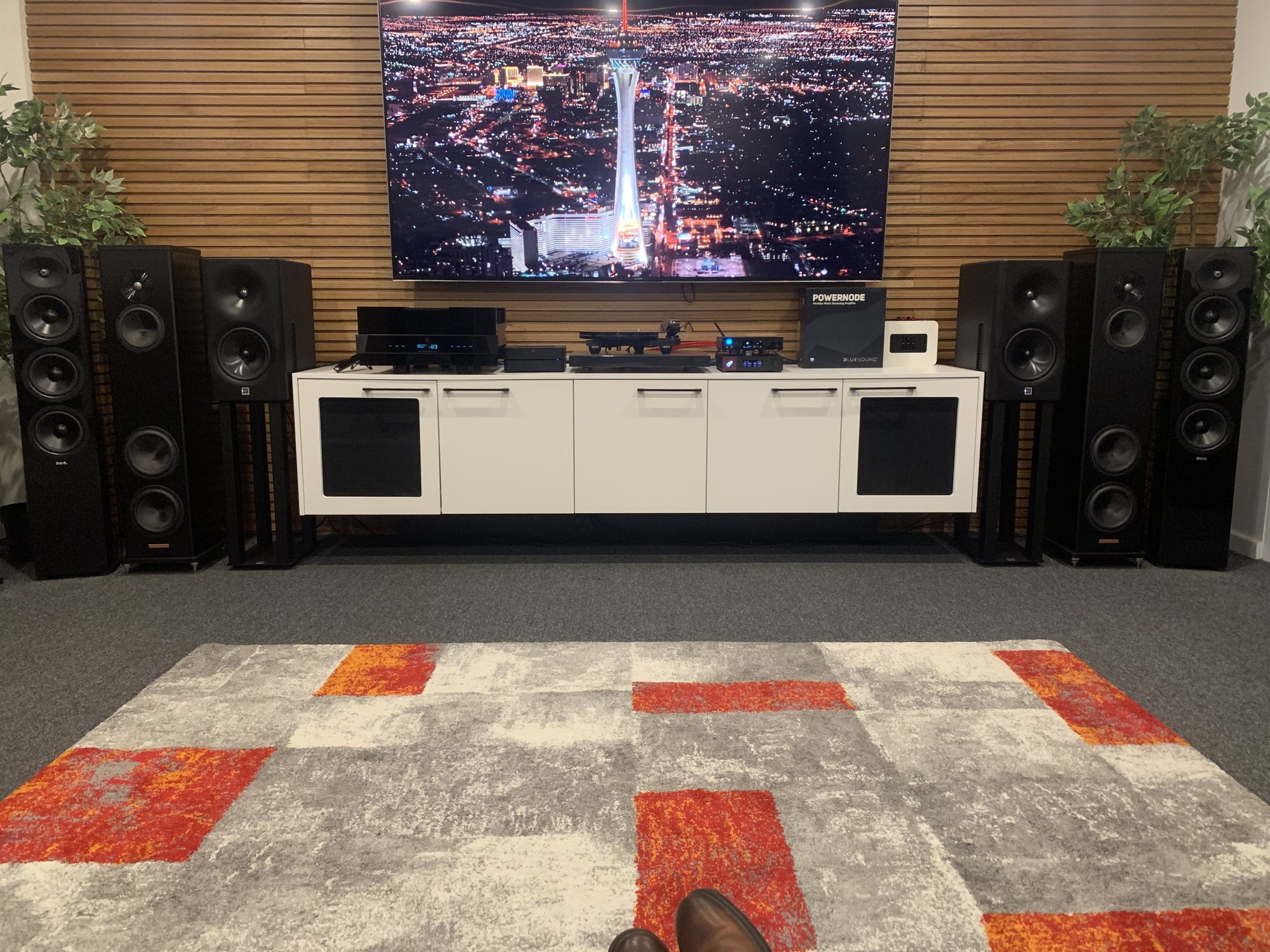

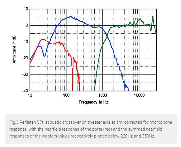

The Note II RS is a truly full-range speaker. I recently auditioned Perlisten s7t, Magico A5, and M2 in the same listening room. The bass quality and quantity from Note II RS blow away all three of them. For the rest of the frequency range. I would say Note II RS sits between the $25k A5 and $65k M2. The 65k M2 does have some magic up its sleeves. The Perlisten, despite great expectation, sits way down at the bottom. It is not really in the same league. The imaging precision/depth and clarify are really something with the M2. Both Note II RS and M2 give you the feeling of sound leaping out of total blackness. M2 has sharping imaging that is more up close, it also feels like having a sharper attack, probably due to the beryllium tweeter. Note II RS images a bit further away, more diffused, likely due to the nature of dipole. Note II RS just sounds so musical and so smooth. Listening to Wallflower on Note II feels like sitting next to a fireplace enjoying a really nice glass of whiskey. Both M2 and Note II RS give each recording a completely unique presentation - a sign of great transparency. Kudos to JohnK for a great design. Consider the cost to make this speaker, it makes it an even bigger bargain.
In terms of multichannel DAC, Okto DAC8 Pro is fantastic for a reasonable cost. Or you can go with proaudio interfaces as al2002 mentioned above.
And the Note II RS was in the same room??? How did you manage this?!I recently auditioned Perlisten s7t, Magico A5, and M2 in the same listening room.
Are you talking about the Bob Dylan tune? Performed by.... Diana Krall, maybe?Listening to Wallflower
No, only s7t, A5 and A2 are in the same room. I do not have that magic But the lack of bass output vs Note II RS is extremely obvious. The s7t was burnt in only at about 100 hours. It was surprisingly weak, missing both the lower and mid bass. Maybe we have a pretty bad null at the listening position, but we tried to move laterally, the impression did not change. Myself and the dealer were both wondering what's going on. I guess it speaks to one major advantage of custom digital crossover. It was based on measurements at my house and my listening position. Normal passive speakers simply could not have that.

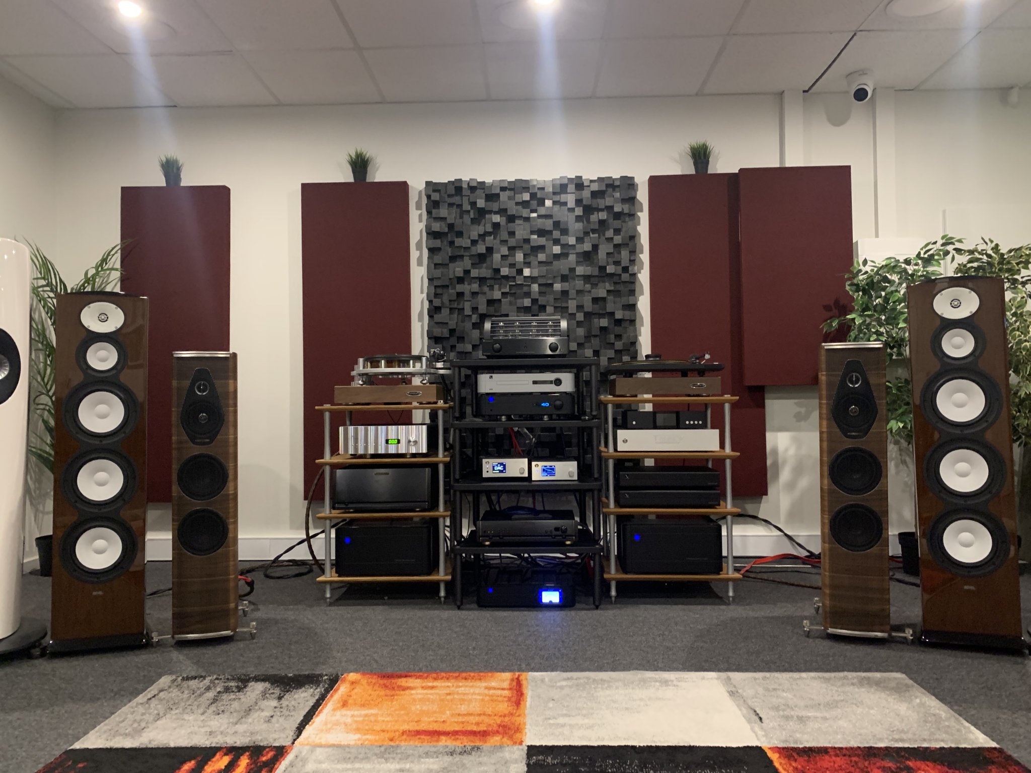

Well I recently listened to the current top of the line Revel speakers- Performa 3 Be F328Be and Dutch & Dutch 8c.

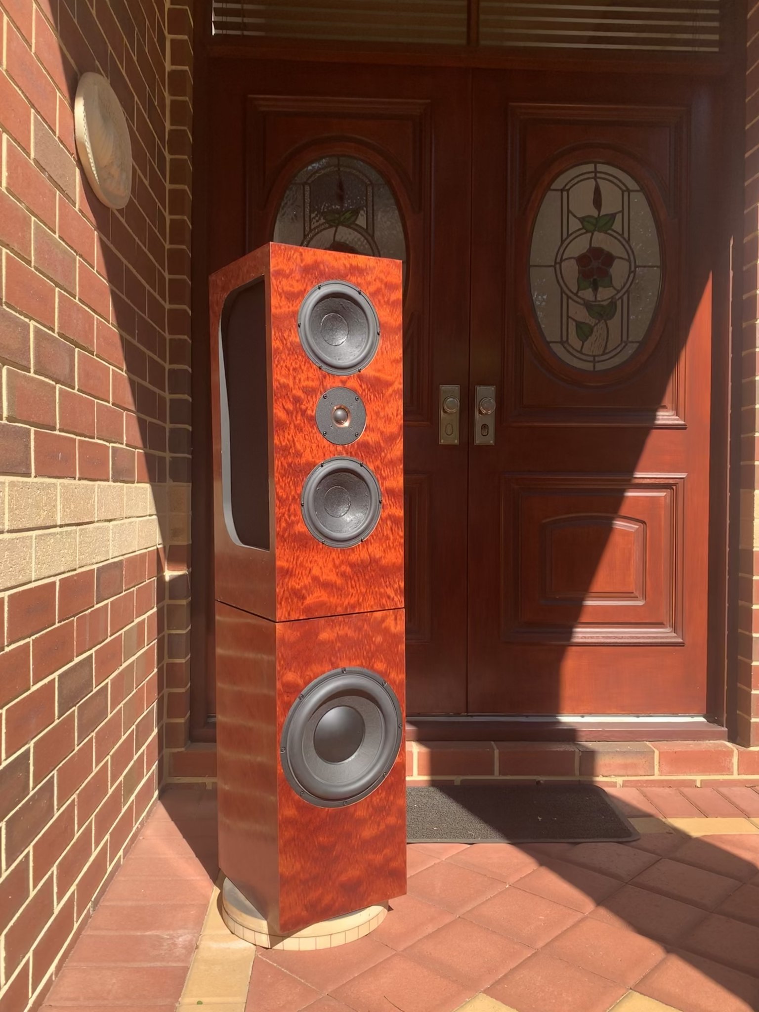

and was inspired to got a move on and finally finish off those NaO speakers.
1 NaO in mono beats the stereo F328Be
or stereo 8c.

Your perception of the bass response from Magico and Perlisten is accurate. Just examine the measurements I obtained these measurements of these speakers from Stereophile, they are self-explanatory.The Note II RS is a truly full-range speaker. I recently auditioned Perlisten s7t, Magico A5, and M2 in the same listening room. The bass quality and quantity from Note II RS blow away all three of them. For the rest of the frequency range. I would say Note II RS sits between the $25k A5 and $65k M2. The 65k M2 does have some magic up its sleeves. The Perlisten, despite great expectation, sits way down at the bottom. It is not really in the same league. The imaging precision/depth and clarify are really something with the M2. Both Note II RS and M2 give you the feeling of sound leaping out of total blackness. M2 has sharping imaging that is more up close, it also feels like having a sharper attack, probably due to the beryllium tweeter. Note II RS images a bit further away, more diffused, likely due to the nature of dipole. Note II RS just sounds so musical and so smooth. Listening to Wallflower on Note II feels like sitting next to a fireplace enjoying a really nice glass of whiskey. Both M2 and Note II RS give each recording a completely unique presentation - a sign of great transparency. Kudos to JohnK for a great design. Consider the cost to make this speaker, it makes it an even bigger bargain.
