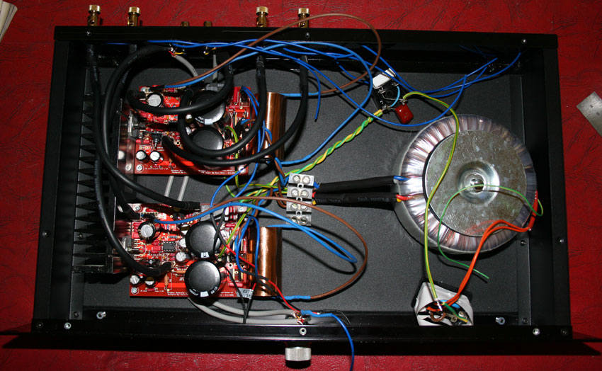

ESP Ground Breaker

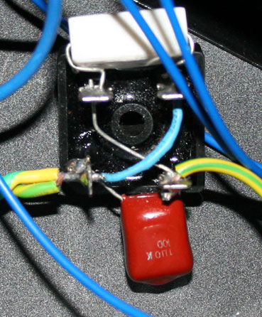

Sorry for the newbie question but does this picture of the ESP ground breaker look correct or do you disregard the AC +- markings on the bridge as it's not being socketed. Amp is sounding great. I replaced heatsink for larger one as LM3886 was getting to 72 deg celsius. Regarding LM placement and heat sink. I ground a 4mm slot in the heat sink from below stand-offs which the board slots into. Just make sure resistor leads don’t touch heat sink.

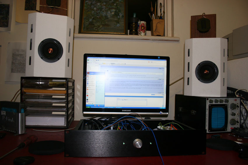

Amp is in 2U rack for use with digital Audio Workstation. Toroid is dual 22v. Volume is ebay 10k 21 step attenuator and seems plenty loud through CSS FR125s 86db & Foster leaf super tweeters.
Thanks to Uriah, Dario for help with transformer and of coarse Mauro.
The Disconnecting Network looks good.
The DC to DC is shorted. OK
The AC to AC is shorted. OK.
The Grn/Y comes in on one side and goes out on the other. OK.
The cap across the diodes carries extremely HF to chassis. OK.
The resistor across the diodes carries tiny current to chassis. OK.
The resistor is too big. 5W is not needed, 125mW to 600mW is sufficient. It carries leakage current from transformer to PE. These can be uA to mA.
Pic2.
I cannot see the permanent Chassis to PE connection!
I cannot see the Disconnecting Network to Chassis connection!
Pic2.
Thanks for reply Andrew. Yes, I still need to finish Chassis ground and tidy up other wiring as you mentioned. I wanted to make sure ESP ground breaker was correct first. Most of the blue wiring is from in/out wire shielding. Is this pointless? It seems very quiet.
