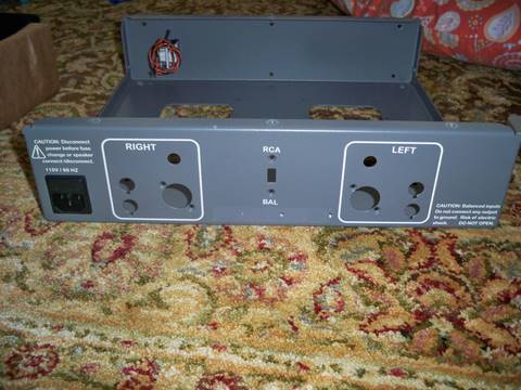

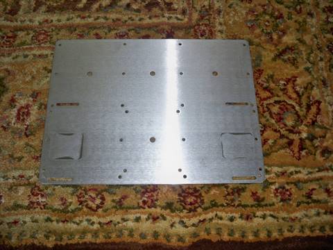

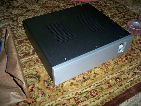

Finally I got what I needed. Remember that Chassis I was talking about a while back? Well, it is a really nice chassis but I wanted it to be perfect for the MyREFC so I got a bottom plate made for it. It perfectly matches the MyREFC boards and the 160VA toroids I have been selling. You can also fit easily a 250VA in the center and if you offset the 300VA about a quarter of an inch it will fit as well. This thing is ready to go. If you guys want them I am asking 165 each plus shipping. I think its safe to say this should remain US or Canada. Elsewhere would be silly for shipping costs, but if you must have one I will try to ship to other countries, just assume shipping will probably be 50+ to countries outside the US.
I only have 10 of these. One for me, one for Sonidos, leaves 8 of them and another half of those have been requested but I need to check and see if those folks are still interested. So 4-8 available.
Dimensions are 14" wide, 12" deep, 3.5" tall.
All screw holes in plate perfectly match the chassis. No drilling needed at all.
I think it will fit a large fllat rate USPS BOX!
Uriah

Troy,
No. This chassis is repurposed for the MyREFC. It originally would have held two ICE amp power modules from B&O. I got a hold of 10 of them for MyREFCs but the base plate of the thing has two holes in it where the modules would have fit. So I had the designer make me a baseplate that would fit over those holes and also fit our boards and toroids. The plate sits up off of the bottom by however high you want it to with standoffs. So directly beneath the chip there is a 1/8" gap if you are shooting for UL standards. So there is a lot of airflow possible as the entire thing sits off of the floor by 1/8" and the air seeps in around the entire gap. Then, those slots you see? A little L bracket is used to hold the heatsink in place. So you bolt the L bracket to the sinks, then bolt the L bracket to the baseplate and you can now slide the sink back and forth for a perfect meeting with the chip. Then tighten the bolts down and bolt the chip to the sink. Pretty nifty :)
Uriah
