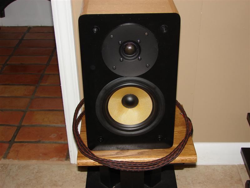

udailey said:Awesome! ......Troy, would be interested in pics of your speakers, especially if they are DIY as well.....
They are SS Revelator tweets, B&W 805 Kevlar mids and the XO's were LEAP designed, tuned and built by Meniscus Audio.
I put them in generic "woodstyle" cabs for now. I have the matching cabs for the woofers. Eventually they will be rebuilt into a single cab active 3-way.

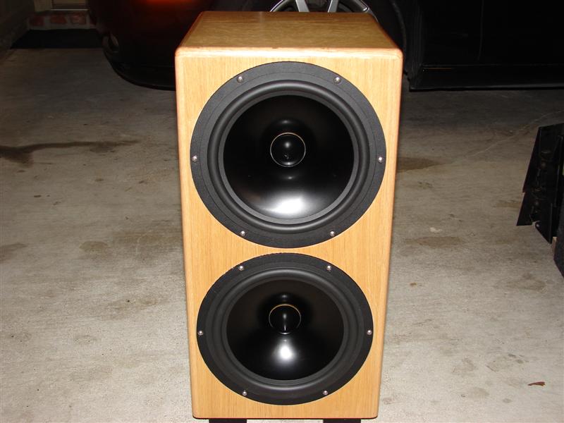

fredlock said:Troy,
Nice woofer! Did you DIY the woofer or you bought it ready made? Are both speakers active or one just passive?
Fred
Woofers are 2 x Parts Express 10" aluminum cone 8 Ohm. Can't comment on the sound yet as they have never been played...
http://www.parts-express.com/pe/showdetl.cfm?Partnumber=295-368
The cabinet is also the "woodstyle" cabinet. It was a company out of Ca that Mr. Gerald bought his cabs from.
EDIT:
2 x 10" is ~ equal to a single 15" woofer. The old system had paper cone 15's in a 1.24 cu ft sealed box and was incredible sounding but had a TERRIBLE waf factor. This will be a "little" thinner box and significant other friendlier.
