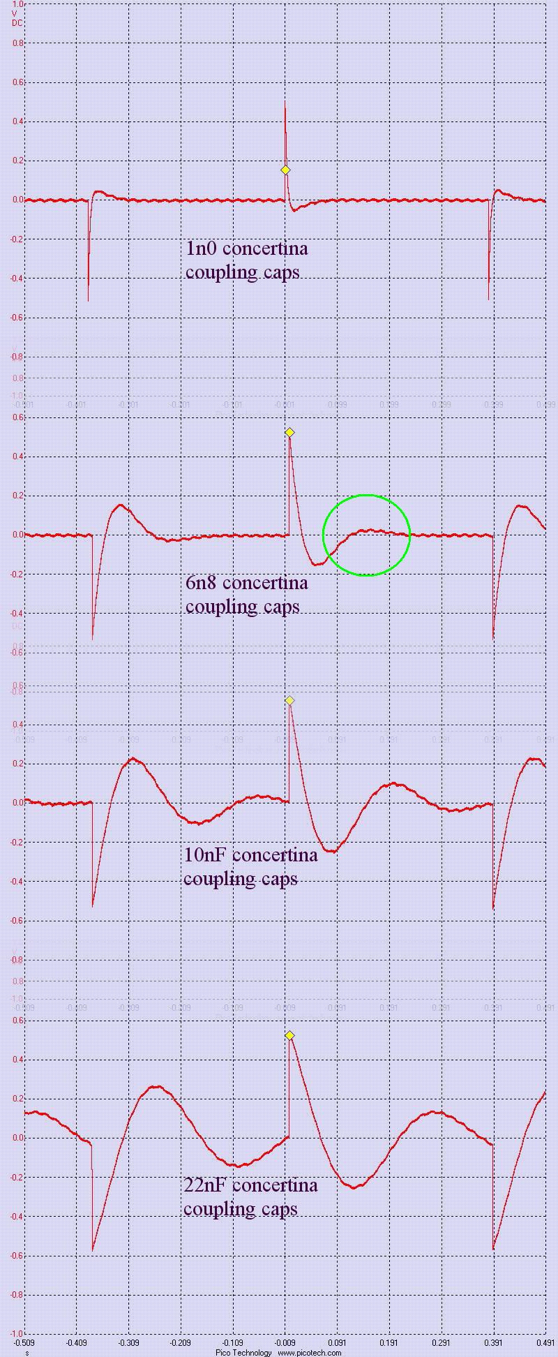

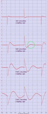

Perhaps a slight diversion but worth an explanation.
Another way to look at it, is to think of a tube amp with a global feedback loop is really a controlled stable phaselocked loop, modulated by a signal. There is a limit to the amount of feedback and the transient response (K=damping) created by the circuit poles R & C's for any output transformer and has a bearing on sound quality.The worst part is all the parameters interact.
The problem:- An optimum squarewave quality at LF implies a high value (or no) coupling capacitance often directly conflicts with the transient response of the circuit and the amount of loop gain available.The math analysis is murderous but the practical test is more revealing. A flip in a book describing a phaselocked loop constants will show that circuit response, phase shift vs damping all interact as they do in the amplifier case. The same principles apply.
A brief pic digression of the transient response of a Williamson amp (output with differing interstage coupling cap values is shown.The 22nF illustrates too high value non settled overshoot before the next cycle and higher values towards LF subsonic oscillation and the 6n8 with green circle shows optimum circuit damping. Further reductions of value, i.e 1n0 value the circuit runs out of loop gain at the LF end and serious degrading occurs.
The contradictory nub...A high value interstage cap will give lowest LF thd figures and perhaps over-good LS damping as the global nfb value remains highest. However, repeated audio tests do show that tube amps which have a higher interstage cap value, sound muddly with higher LF intermodulation whereas an optimum cap offers the correct attack when complex LF instrumentation is replayed. This doesn't correlate with a perfect squarewave, expect tilt and also assumes the amplifier circuit at the LF end offers sufficient loudspeaker damping at the resonant frequency of the box.
This is the reason a largest transformer is best and is one of the most awkward subjects to grasp but get the Q's optimised isn't easy, but and one will have an excellent amplifier that will hit one in performance.
So the catch to throw one out; an amplifier which is slightly overdamped will require a boom box Q=1.4-2.0 to enhance the bass whereas an underdamped amp will sound nicely with a low Q speaker (0.7-1.0) often boasted for classic. The optimum complete LS Q is between 1.0 -1.4
Ones choice.
