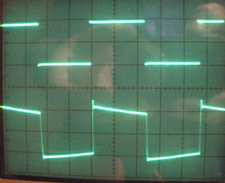

My Wave Isn't Square.
The top trace is the input signal at about 3.8v P-P, 1K hz. The bottom trace is 10v P-P after the coupling cap.
-6 dB NFB has reduced the over shoot and most of the ringing. The issue now is the top and bottom of the wave are not flat. They both increase with time. I understand this represents a emphasized low hz response.
I presume the differance in the angle of the top and bottom is due to nonlinearity.
The output trace (not shown) is an inverted image with the highs over emphasized, decrease with time, and with a bit more angle. The angle increases as volume increases.
The amp is very quiet and clear but it's a bit bright.
How would I correct this type of frequency response?

You are looking at high pass filter behavior, which is typical when looking at square waves. The lower you go in frequency, the more pronounced this will become. The higher in frequency, the less pronounced.
Schematic would help to identify the capacitor that is forming this HPF, but I would say you're fine if you are happy with the bass response of the amp.

You haven't touched on the OPT you are using which is certainly responsible for most of what you are seeing. FWIW that is a fairly good looking SQ wave. No OPT is going to have sufficient HF response to pass a perfect square wave except at relatively low frequencies, (a couple of kHz or so) and that presupposes that the primary inductance is sufficient not to load the tube at the frequency of interest.

Why do you want to 'correct' the response? The negative feedback is doing, presumably, what you want it to do. It corrects the output (precisely, the NFB sampling point) by modifying the input. You are simply seeing the modification. You would see far 'worse' waveforms inside other amps.

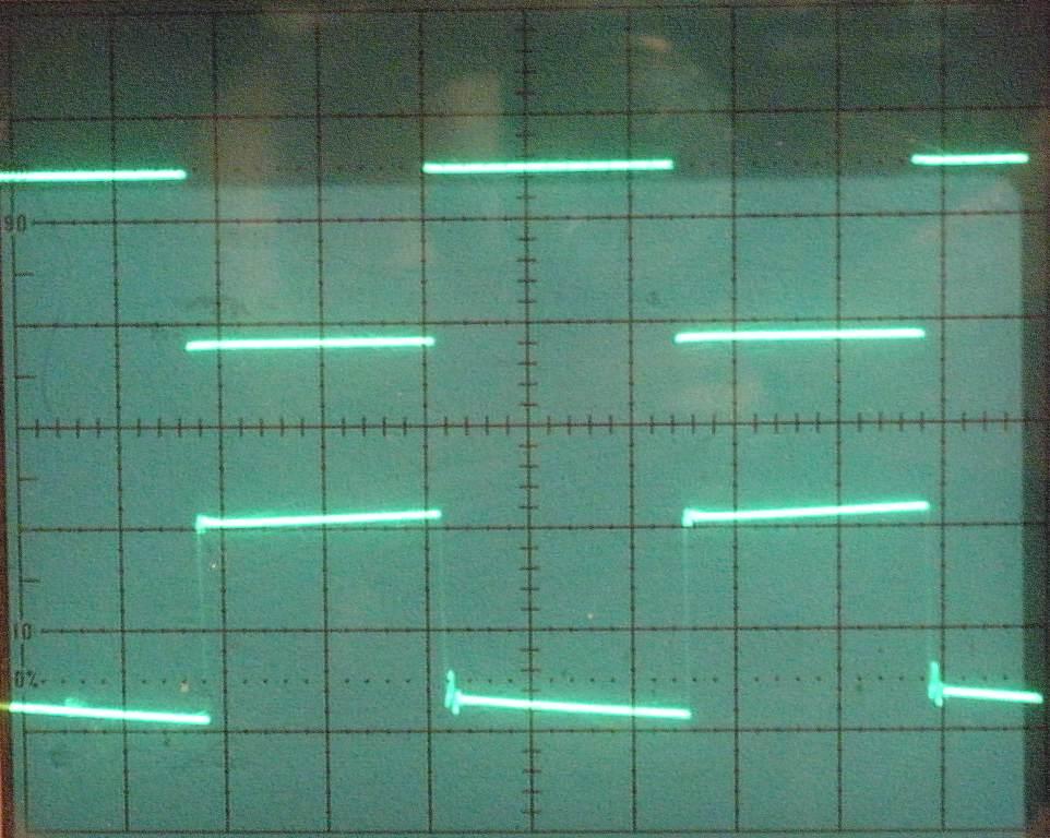

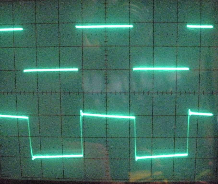

The first photo is input (1K hz, 4V P-P) and output (10V P-P) with -6db NFB. The second no NFB. I still have a little over shoot to work on.
The OPT's are 10w 5K-8 Edcor's (GXSE10-8-5K).
It's good to know I'm in the ball park. It's also good to know there is room for improvement. I will play around a bit more with the NFB. Mullard references NFB in the -20db range for pentodes in their Tube Circuits for Audio Amplifiers book. The sweep is a good idea.
I'm consistant with the listening test. Same source, speakers, tracks, room, volume. You might right, It may just be the new pentodes. I'm used to my old Mullards.

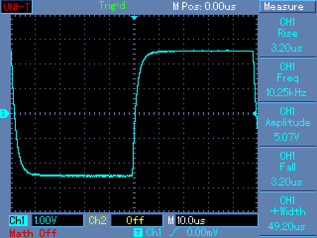

The result shows heavy non-linearity, not only frequency roll-off. This is from ECC82, 'Aikido-like' circuit.
I see evidence of a relatively low slew rate which implies bandwidth limitations, and asymmetry in the rise and fall times which relate to a variance in the ability to sink and source current in a typical resistively loaded amplifier stage. Some of this could be the result of your probe/cable capacitances. I don't really see a "heavy non-linearity" as presented in your waveform, but I guess my standards are lower than yours.. (I've seen much worse actually) :D

The -3dB point for 0u047 and 470k is a little high (7 Hz) but not enough to cause that much bass loss. I'd suspect insufficient primary inductance for use with a pentode.

If you change your coupling capacitor (first post picture) from 0.047uF to 0.47uF it will look more like a square wave.
Closed loop this isn't going to be the case, and that LF corner is at 7.2Hz so no change with a 1kHz square wave. Really not hard to understand that the transformer is the culprit here.
In my waveform you can only see exponential rising and falling edges, both same in shape and time. This is perfectly linear behaviour, same as for R-C passive circuit. The scope has even calculated rise time and fall time of the step response for you. In the waveform presented by the member, there is an overshoot on rising edge and no overshoot on falling edge. This is a prove of dynamic non-linearity of the measured circuit. Thank you for asking, feel free to put further professional question.
I don't see the overshoot on the rising edge perhaps a quirk of my video display system. (or my eyes?) :D
