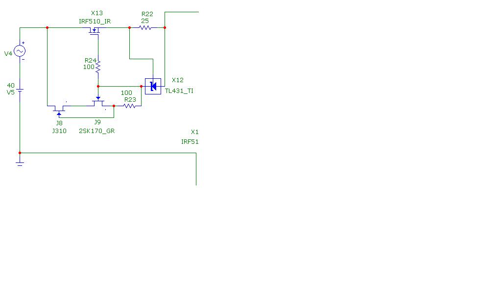

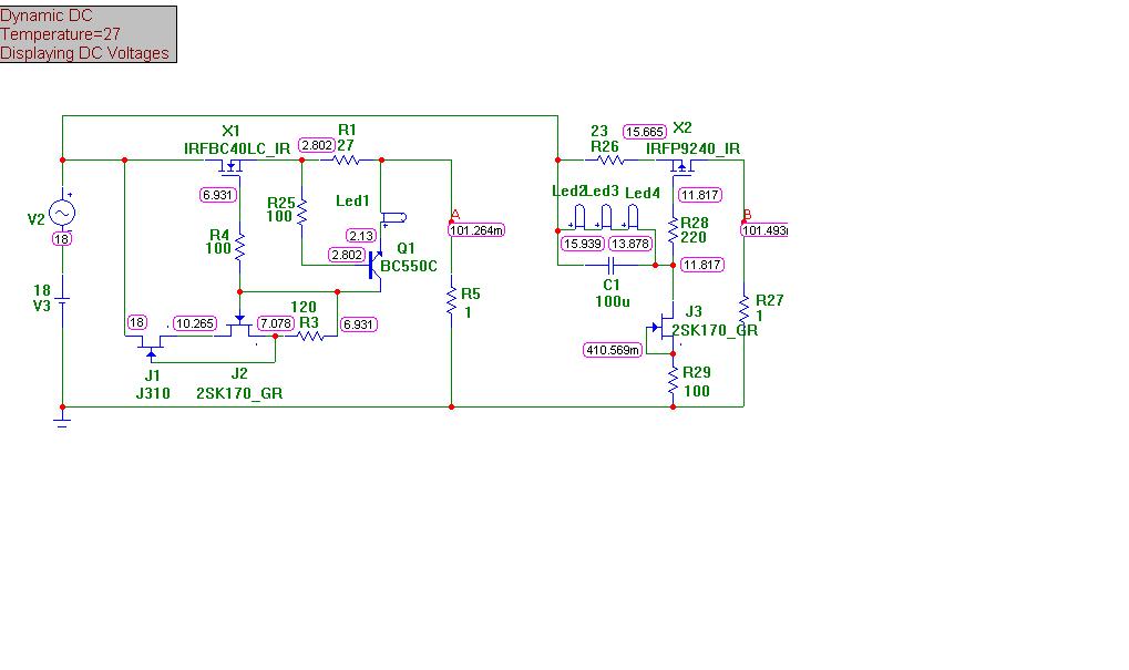

I made a simulation of a constant current source from the schematic reg-v2n-5k, MicroCap is a simulation software. Here are the results. Is anyone besides me simulate the CCS? Why so much performance decrease with increasing frequency? I made a simulation for Salas's V1 CCS and compared with Ikoflexer CCS...

Viktor, what are you trying to achieve? In the regulator the CCS works together with the shunt part; if I were you, I'd compare them with the same shunt circuit. You can then simulate ripple rejection and output impedance.
Thank's Iko!
What is your opinion about changing the 2N5088 and led diodes in CCS with TL431? Simulation shows better PSSR with TL431...
Noise and stability would be my concerns. But you haven't answered what your final target is. I don't really understand why you're paying more attention to the CCS. The CCS that I use or the CCS that Salas uses in his version 1.2 both have high performance and are stable, when used in the shunt regulator. If you want a CCS for some other application it would be better to design it specifically for that app.

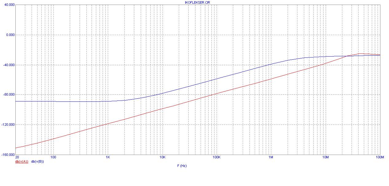

My concern was that I had made a simulation of your and salas CCS, your CCS had a better performance but it not looked like salas simulation in terms of linearity pssr from 20Hz-50kHz, my concern was that with increasing frequency and fell pssr, I thought it should look linear like salas ccs...
I made a simulation of the complete reg, CCS + shunt, it looks fantastic. Will start the next day to drawing board. Otherwise, I plan to have this be a power supply for the preamplifier.Just seems that I have to use some replacement transistors because in my country can not be found 2n5088, J201, mpsh81, only to order them from "mouser." Maybe there are, who knows! I will read this topic to see whether there was a question of a replacement transistor...
I have explored using the TL431 in this regulator and in the end I decided it wasn't worth the trouble, but you should decide for yourself.
Regarding parts replacement, to save you some reading: the J201 can be replaced with a 2SK170 if you change the voltage reference resistor values. You can use a BC550 instead of the 2N5088 without a problem. The mpsh81 is more difficult to replace with something else because it is an RF part and I think it helps to stay fast. A good layout is very important for this regulator as well. If you don't want the headache you can just build the Salas simplistic v1, which is excellent, in my opinion. And don't forget his newer one, has a really good CCS and should be also as fast as this one because it uses the bjt helper on the shunt mosfet, just like this reg.
You can use other mosfets as well; just watch the heat dissipation. Best to choose those with low capacitance.

Ok, thank's for the proposed replacement transistors and suggestions for TL431. What's with 2N3819? Worries me a little bit shunt because in the simulation temperature change of 10 degrees shows that the output voltage falls 1V, for 20 degree 2V under Vout...

Congratulations, Keantoken! from the ripple rejection figures and the output impedance graphs you sent me I understand that you have achieved something special. I have seen no other C-multipliers having such low output impedance. You have giving us a great gift, something I will definitely put into my "schematic" bin, that will be used whenever needed.
One day I may try it before the Iko reg. but I know well the Iko reg has 3 digit dB ripple rejection so nothing is needed in front of it.
