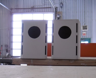

dublin78 said:These Moon Onkens look just like what I am after for my FX120eN drivers. Congratulations.
I will be using a pair of subs, so low end issues are not too important. My main criteria are small size and wall mountable ability. Oh, and getting the best midrange available.
Hi Dublin78,
Here's my take on the situation. First off, looking at the driver specs, the Moon Onkens would work perfectly. The driver specs are pretty close, the main difference being the Vas which influences box size a bit. But I would say that bass extension is not the issue here because you will be using subs.
I spent some time refining the size of the Moon Onkens as they are for an HT application and at least one pair will be wall mounted. I looked carefully at shallow boxes but in the end I decided against them. There are several reasons for this, a) I don't like the aesthetics, b) they restrict the internal port design options for this type of Onken, c) I was concerned about sound reflections of the back of the box if too close to the driver, d) you can get other effects with long thin boxes, they start to look like transmission lines. e) for a shallow box you have to make up the volume in the width and height which I didn't want to do.
I also wanted to move away from the typical 3-slot Onken design, this was very much an aesthetic decision as it's just as easy to make it with 3 slots as 2. Lastly, in the future I may want them on a desk top or a stand. The shape and size were a major driver for aesthetics and this shape/size looks just right by my judgment.
The size of the box will work very nicely for wall mounting if you use a suitable bracket of course.
Yes, you do want the 'holey brace'.
Also, the design is close to some of Planet10 designs, so it's a safe bet that it works !
Feel free to email if you want some of the original design files.
And I have found that the sound depends on the amplifier. I have built my own, it has a tube-type sound from solid state that works wonders with the Fostex drivers !
http://www.diyaudio.com/forums/showthread.php?postid=1848651#post1848651
p.s. Dave and Chris have been building Onkens for a long time, have built more of them than I've had hot dinners; an off the shelf design from them (Planet10) is also a good option if you don't want to strike out on your own. Good luck !

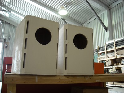

nirvana said:picture 2 on primer only...
mon ami, I think you need to ship those to the left coast for driver break-in and long term evaluation
nice work - how long did they take you to get to this point?

Nirvana,
that's a going to be a nice pair of speakers !
