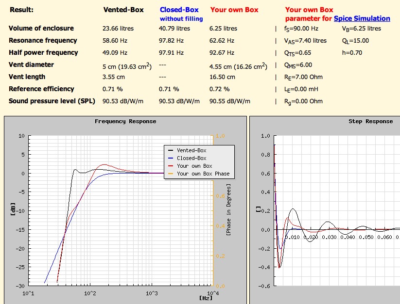

A year on and the Moon Onken's are no longer meeting my needs. The issue is they still sound bass shy and curing the 7kHz peak with a coil & resistor is taking the magic out of it.
I came across this: Fostex FE127E Fullrange Loudspeaker Driver
The author measures the T/S parameters of four FE127E drivers and finds them to deviate a fair bit from the manufacturers spec. I tried loading up these into the on-line BR calculator I used when I designed the enclosure and find that the enclosure is unsuitable for these drivers, if the spec. are correct. See attached - no bass extension.
So I am going to take these drivers out of these boxes. This will have the benefit of generating two new projects. One project will be to find new drivers for the existing boxes, which probably can be tweaked in terms of the port dimensions. A good candidate is already in mind for this. The second project will be to build a new enclosure or two to take advantage of the FE127's that I now have available to be re-purposed, candidates include an OB, a larger volume Fonken, or even a dipole.

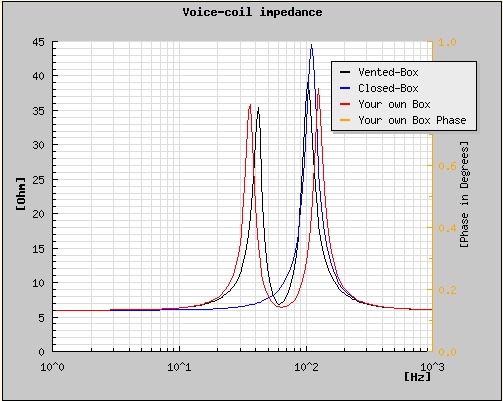

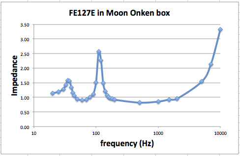

I decided to do a rudimentary impedance measurement of the FE127E in the box to see if it was close what was expected.
The expected result was simulated with an on-line calculator: Loudspeaker enclosure calculating with Thiele Small parameter
I used a sine wave generator playing though my TGM3 amplifier, an 8R resistor in line with the ground wire to the speaker and I measured the rms voltage across it using a DMM.
Simulated impedance peaks: 36 Hz, 110 Hz (see red lines in first attached plot)
Measured impedance peaks: 35 Hz, 110 Hz (measured impedance is on a relative, linear scale)
Seems a reasonable match ?
