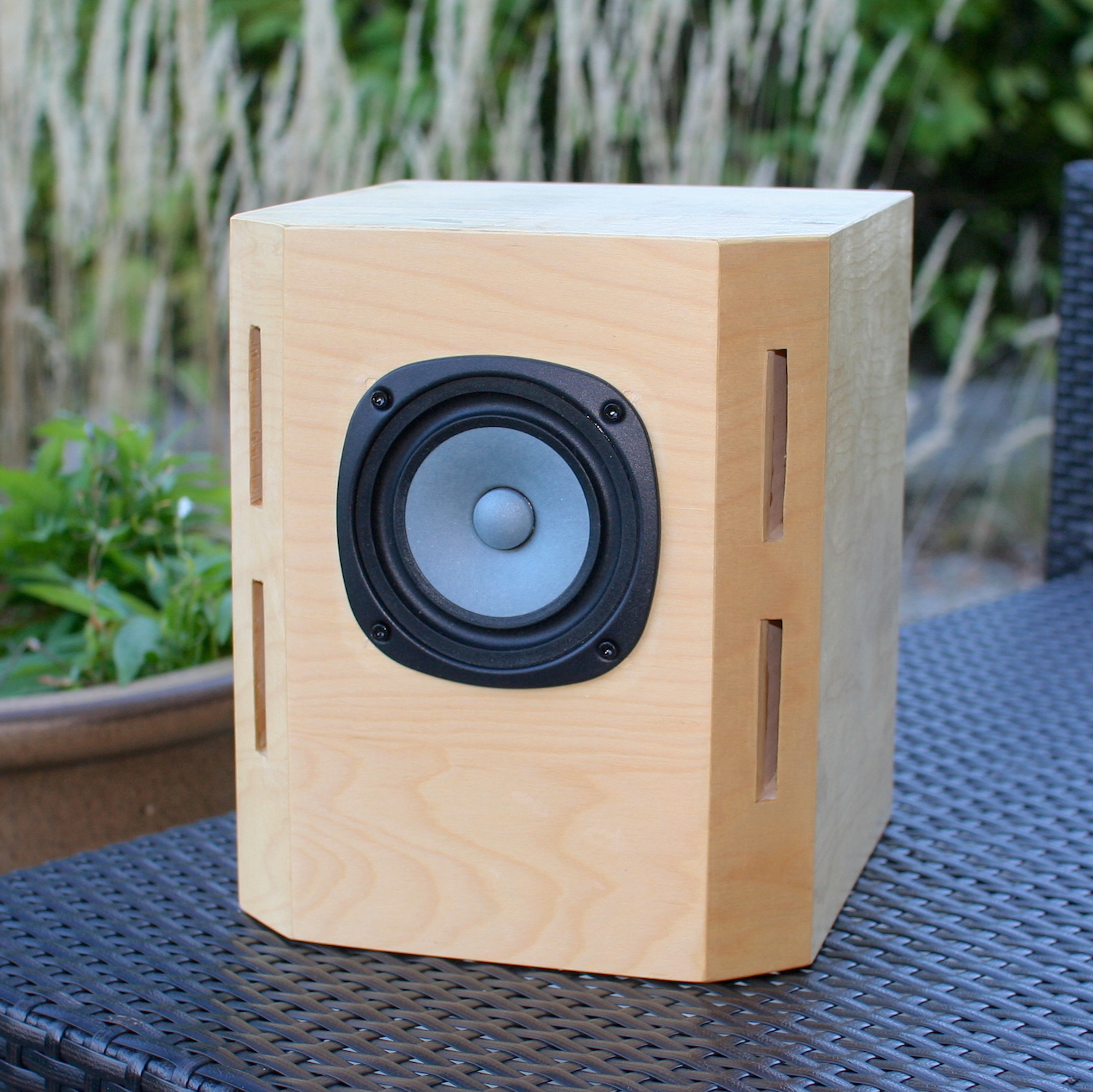

CHN-70
With the very recent launch of the Mark Audio CHN-70 I decided to dust off my Moon Onken enclosures. I sold all the Fostex drivers as I couldn’t live with their specific h.f. response.
The new CHN-70 is slightly smaller, the screw holes of the older Fostex drivers are just visible outside of the new driver but I’m slowly making them disappear with some wood filler. The new drivers have a blue tinged paper. The frame is stamped metal like the Fostex, but it's sturdier and finished in what I believe is called a powder coating.
The key thing is that the driver specs are a fair match to the Moon Onken enclosure, based on a bass-reflex type calculation.
The new driver is still breaking-in at the present time. I've re-lined the box with thicker material to better control any h.f. bouncing back out through the cone too.

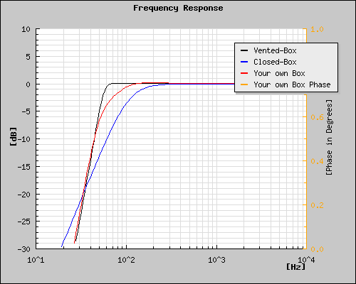

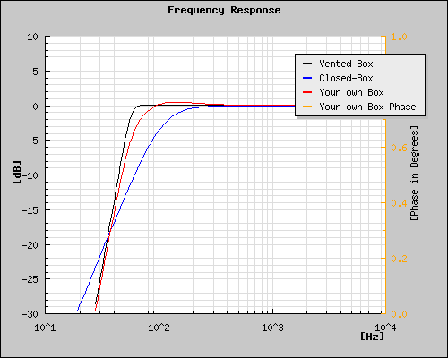

Using the same calculator as at the start of this thread: Loudspeaker enclosure calculating with Thiele Small parameter
I've attached two plots. One of them is the as-built simulation (assuming bass reflex type behaviour) and shows a little peaking (< 0.5dB) in the bass (red trace).
In the past Dave Duglos has recommended pulling this curve down a little. I can readily do that if I reduce the area of the ports by around 20% - that's the 2nd plot.

If you could sum it up succinctly, how does the Fostex sound differ from the MA sound in this particular (and very compact) project?
