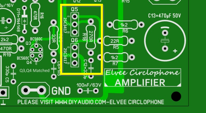

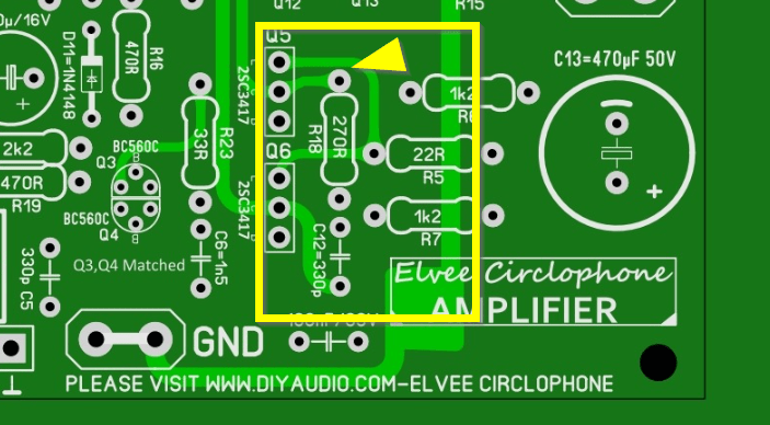

A member here complained that the trace at the junction Q5 collector-anode D8 was too thin!
The conductor path is 1mm wide and therefore completely adequate. Especially as the collector current Q5 is <-20mA at full output! To understand, a track with a width of 1mm can deliver a maximum current of approx. 3 Amps at 20°C ambient temperature.
Actually, the transistors Q5 and Q6 (2SC3417) do not need a heat sink. The power dissipation is approx. <600mW and thus still within the green range of the specification.

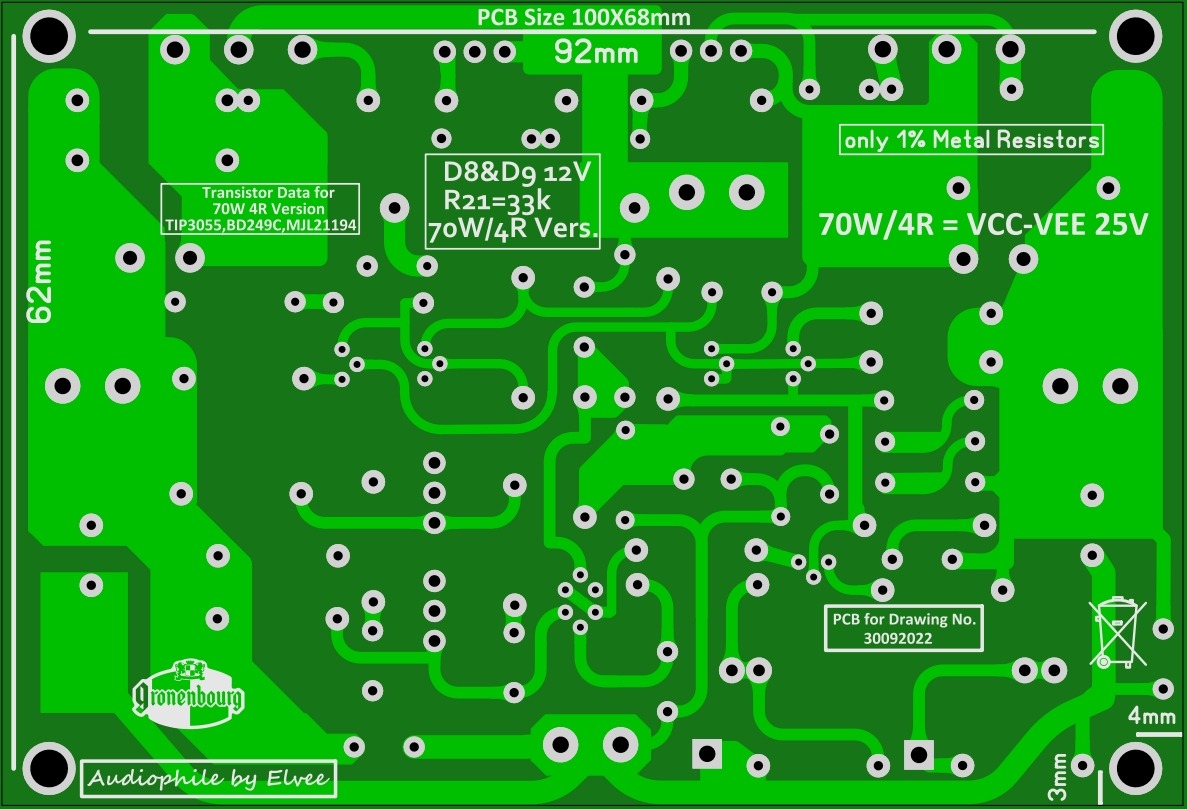

1) First, don’t try and take things out of context - referring to the word complain used by you.
It was a friendly observation period.
2) And understand your point on the Thiel network - I will look into that to better my understanding. Thank you

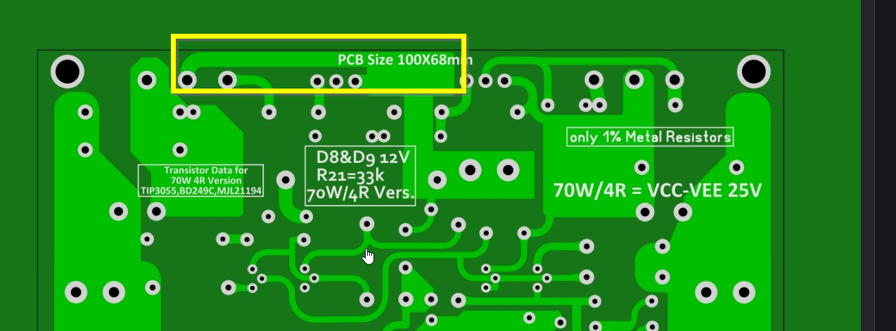

3) The reference of the track is Q10 Collector going to the speaker out terminal ie when the board is seen from the bottom side.
as seen in the below screenshot, Since it looks thinner than the one on the Top layer. - I had put the note via phone so Q10 became Q5 - Apologies.
4) I can't say why but this board seems to have some resemblance with the board by Alex

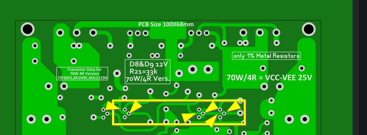

5) There needs to be a little more room maybe let's say 5mm spacing from the body to body for the VAS transistors as they would need some amount of heatsink can be attached.
6) one more change I could see is that not all will have great soldering skills and some time green masking could be a bit open with economical board makers. so could move this center pad tracks to the top layer so it will not pass between the two pads.
7) Maybe we could move the R18 and C12 down a bit and make the Collector track going to R18 Straight and increase the spacing between the track and pad.
9) it appears it does not need to be a dual-layer layout and it can be easily drafted symmetrically even on a single layer.
there seems to be plenty of space on the board for R18, C12, R7, R5, and R6 to be placed symmetrically and also Q5 and Q6 can be placed such that they can have individual U-shaped heatsinks.
Hello Aditya,
First of all, thank you for your message, the track width of collector Q10 is sufficient. With the Circlo Version with 130W / 4R (V+,V- 35VDC)
and the values given in the chart, the load current of collector Q10 is about (Ieff) 4 amps. With a pure sine wave signal of approx. 1kHz. But I will have another look at it.
Q5,Q6 cooling can be solved easily with an aluminium strip with a size of 25*15*2mm. Please isolate the transistors. More is not necessary. The hole spacing is 10mm.
But it is not necessary, I think it should remain within a reasonable financial framework.
I hope I have helped you for the time being.
Thanks OSGO !

Thank you for taking my points in a good spirit, I am learning from you and I am also sharing what I learn and what I do not understand.
In my opinion the output track for Q10 please try and keep it away from the edge of the board for fabrication reasons nothing else.

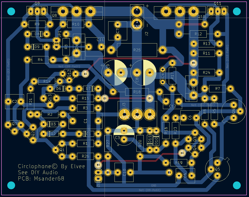

Hello,
Ok, new try. Made mistake in previous post. forgot the Q7 leader to Q8... Thanks to oscargolf how noted this.

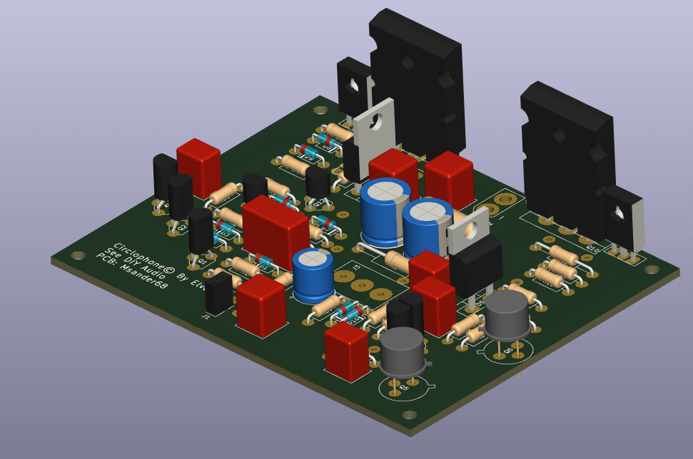

Then I also was not really happy about the placement of the outputs transistors.
See pictures. if someone has some opinion to the layout, please share your thoughts
This will be single side board with 4 jumpers.
I will mill out this board in my PCB mill later on. all tracers is around 1.5 mm
BTW the KiCad 6 files are available
/ Brgds

@Msander68 Your layout looks very good.
