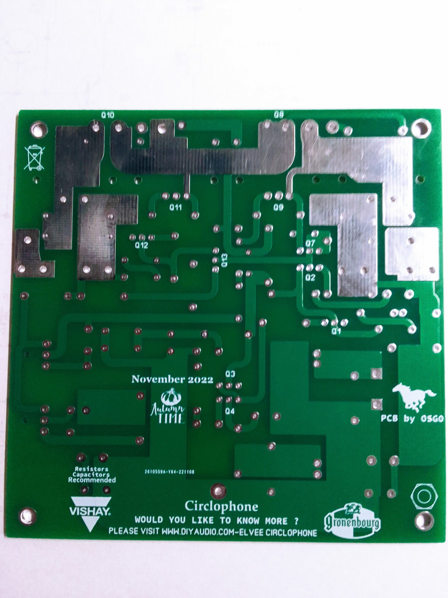

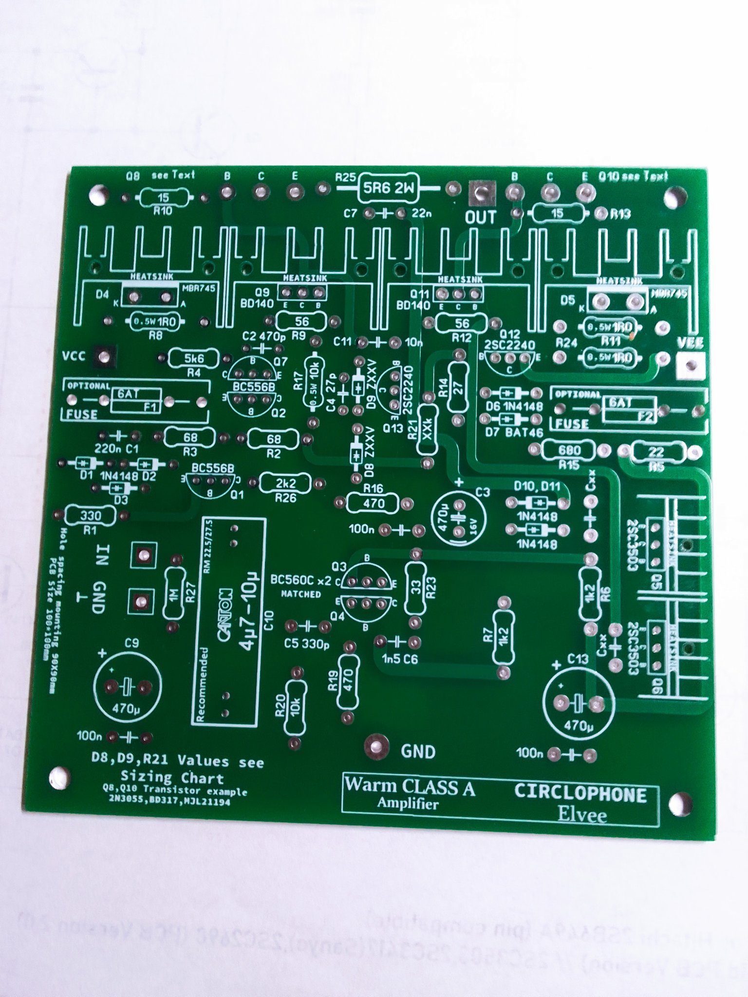

Allen Circlophone-Anhängern ein frohes neues Jahr.
hoffe ihr hattet alle einen guten Start ins neue Jahr.
Hier ist eine neue PCB-Version von mir und Stallion.
Hengst, mein Freund, wollte eine Version mit Sicherungen und im Format 100*100mm.
Er möchte jedoch nicht, dass diese Version im freien Open Source landet.
Bei Interesse schreiben Sie mich direkt an.

Hi Oscar,Allen Circlophone-Anhängern ein frohes neues Jahr.
Danke OSGO
A very Happy New Year, Congratulation on the new board.
Have you tried this board testedin practial. how does it perform.
what is the dc offset you get with this setup along with the Quiesent current?

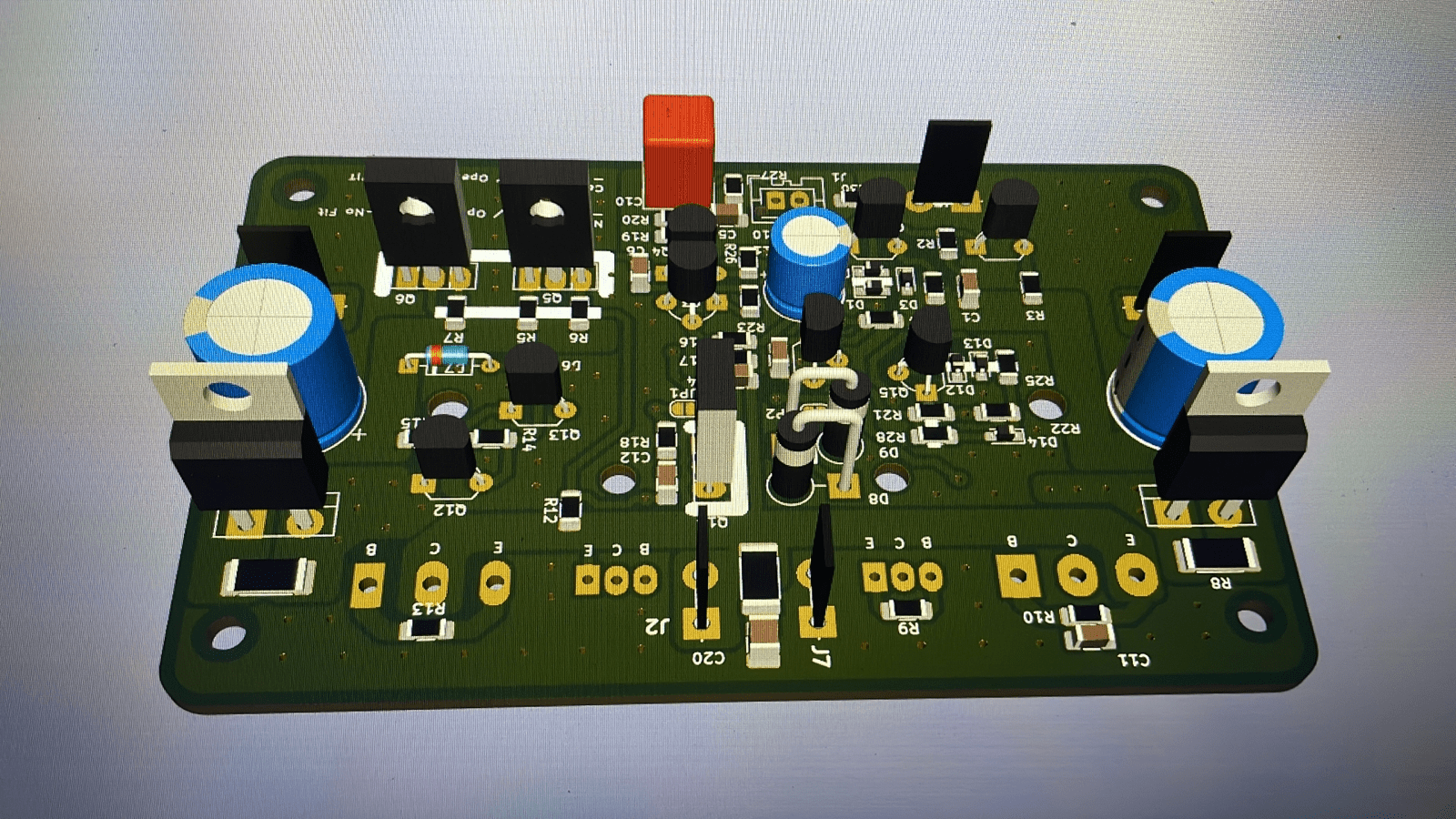

working on my Drafft board layout done in SMD with board size of 100mm x 65mm.
Driver and Output Transistors are accomodated below the board for a monolith assembly on heatsink construction.
all SMD capacitors are COG/NPO type rated at 100Volt

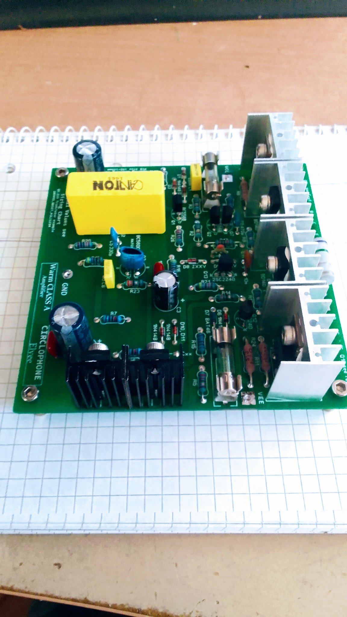

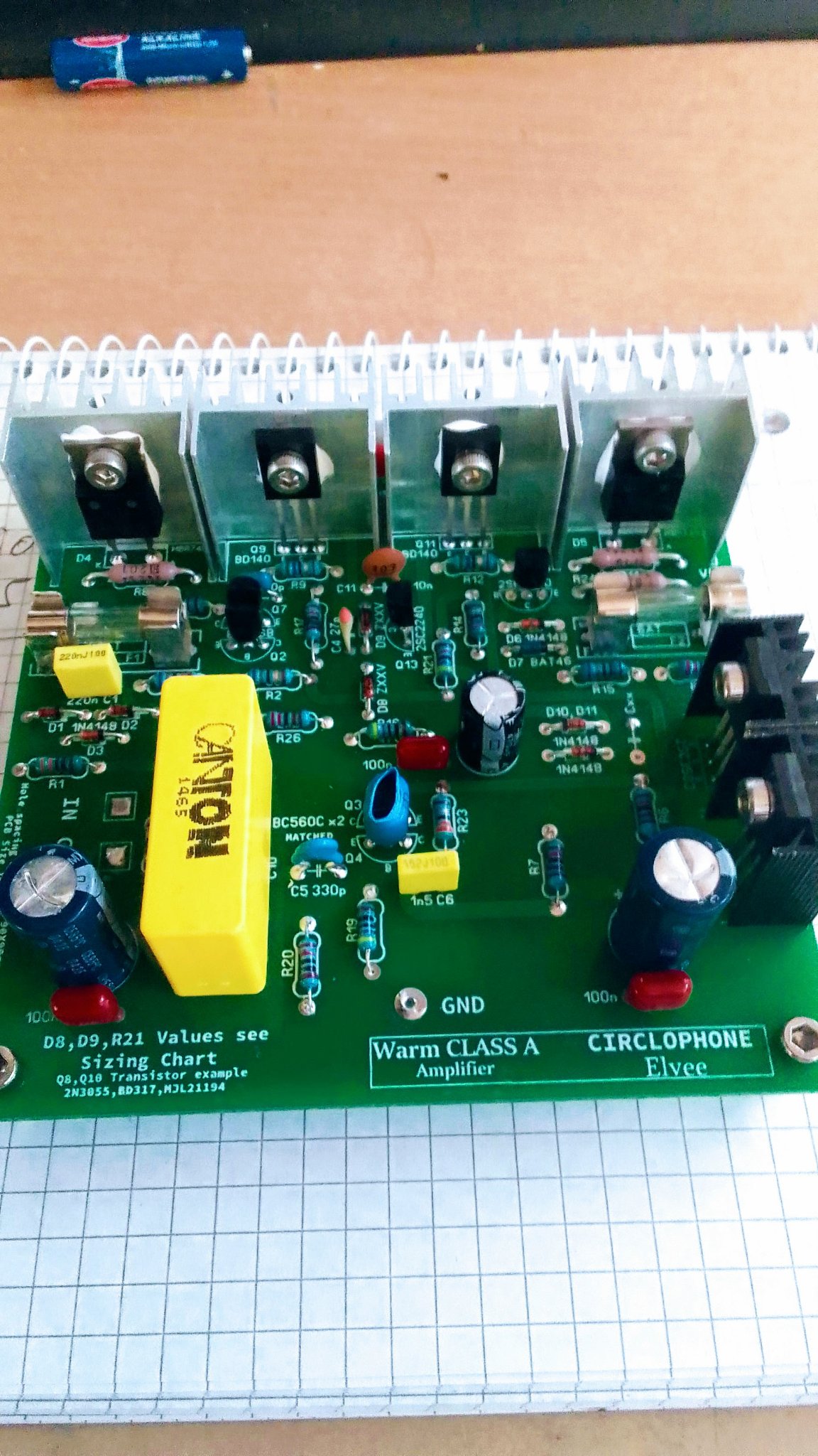

Thank you Oscar,Hello Aditya,
Your board looks very good too. It's just that I'm not so good with SMD. But the board looks good.
Yes of course I have tested it and my DC-OFFSET is
< 2.5 mV.
But I would know how it performs once I get it from the fabricator. Fingers crossed
Your offset is cool 👍
I would like to know if the position of VAS transistors would affect the response in anyways and where should they be placed
