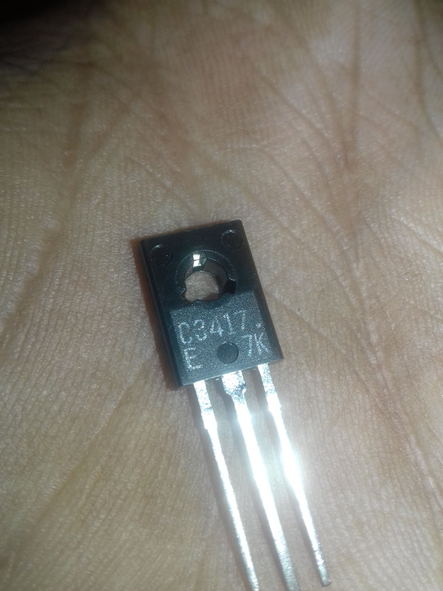

I don't have the 2n3019 transistor. What can I use instead of the most used transistors.
https://www.diyaudio.com/community/threads/my-little-cheap-circlophone-c.189599/post-5952530
TTC004B
Reactions: 1 user

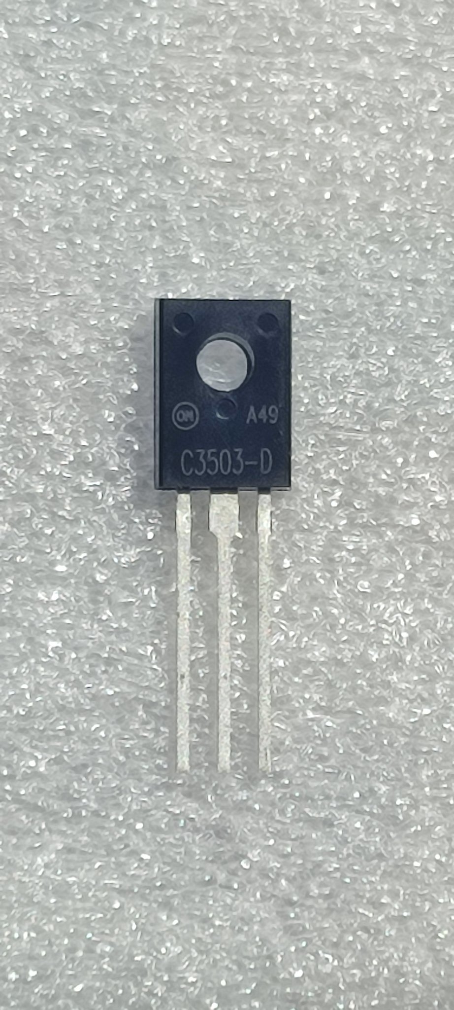

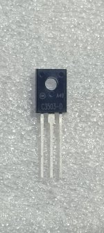

Well Mr minek123 suggestion is excellent. TTC004B is very good substitute for 2n3019 but in case you donot get this transister you may go for KSC3503 which is still under production by ON Semiconductor.
TTC004B is much robust transistor than KSC3503 but in our circuit collector current of VAS is max 15ma.
KSC3503 is a Video Transistor and its performance is excellent. I have tested this in my prototype BJT Circlophone with 2N3055/ 2N3773 output transistors. Picture of Genuine KSC3503 attached.

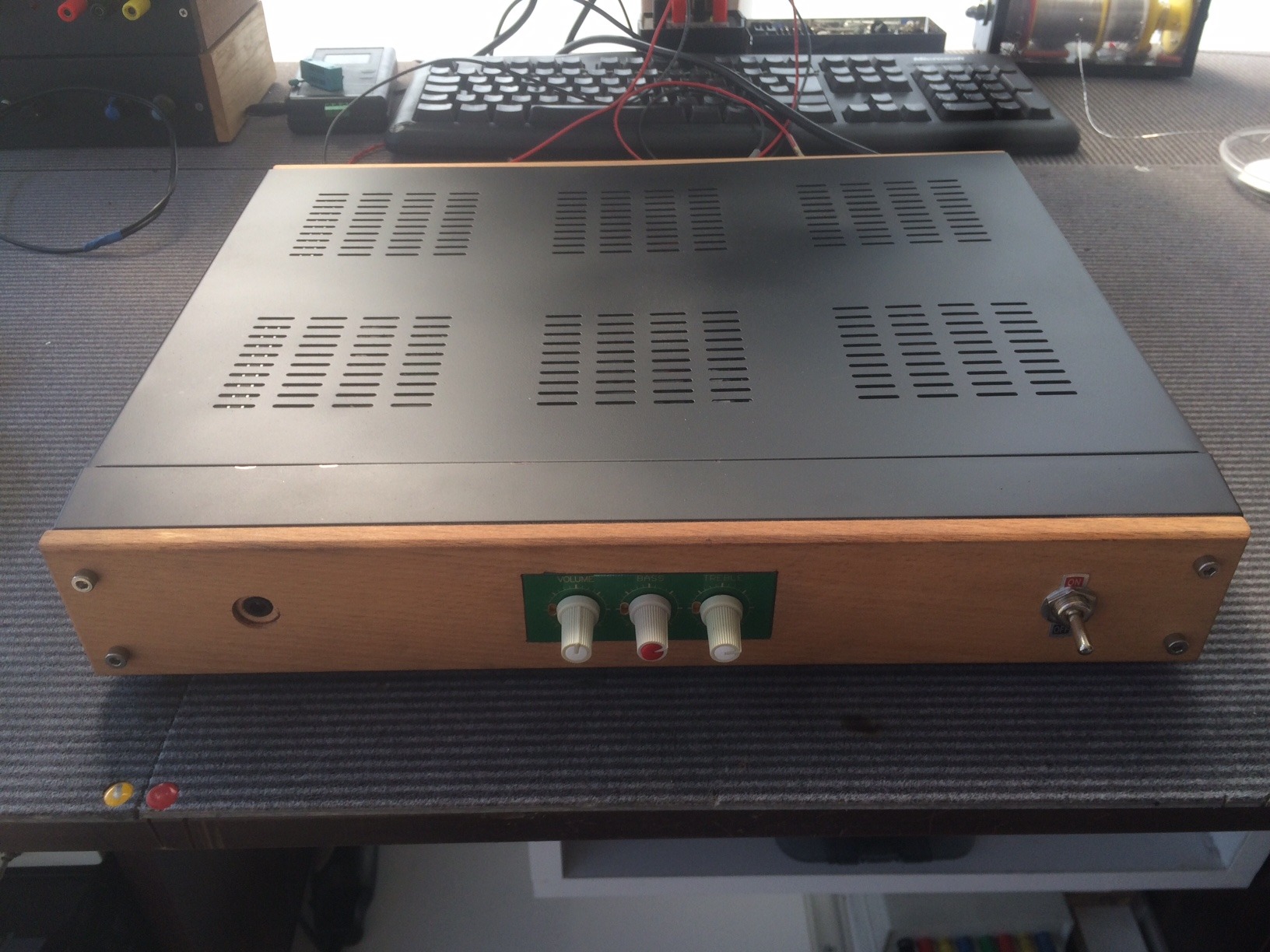

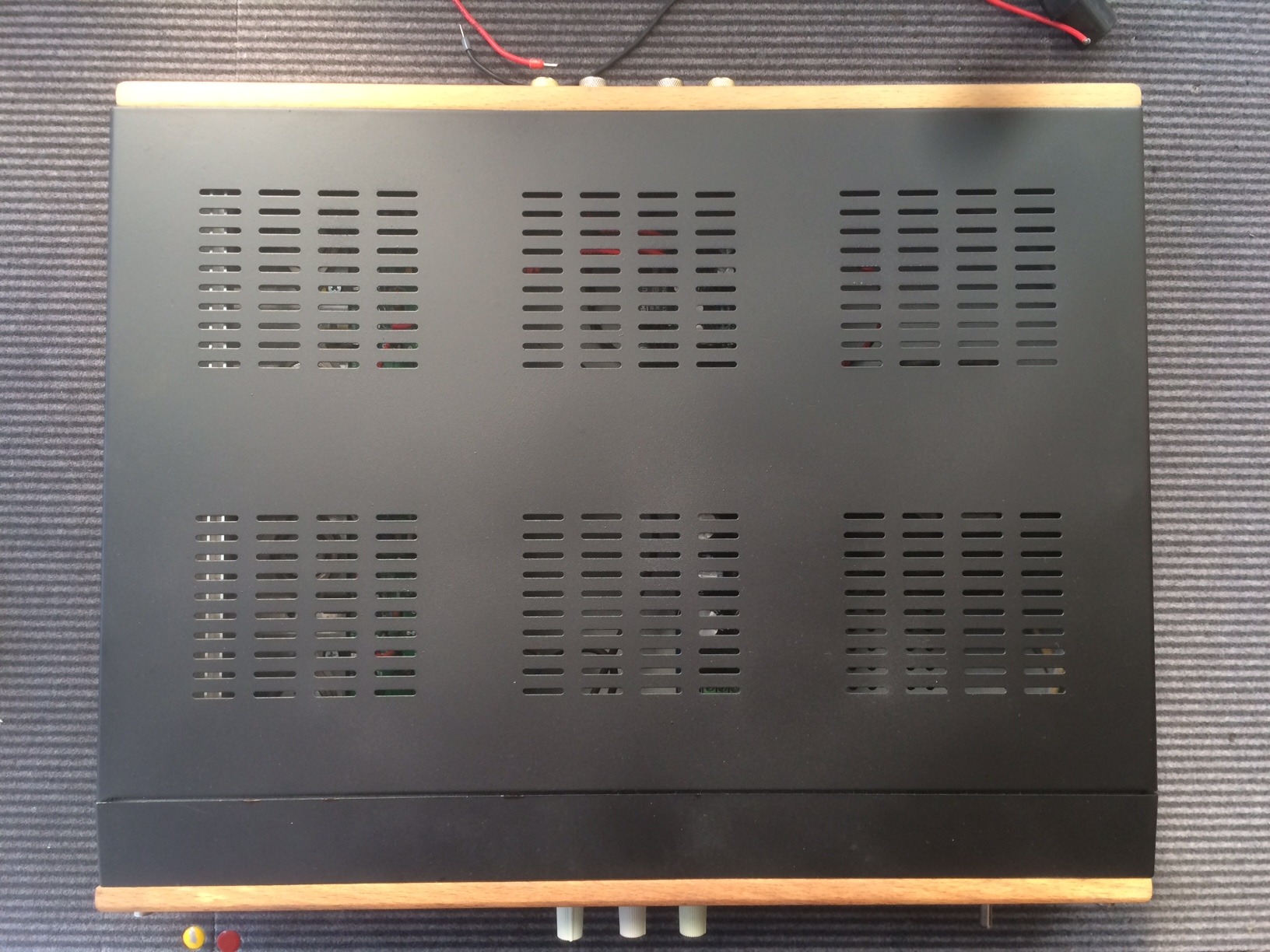

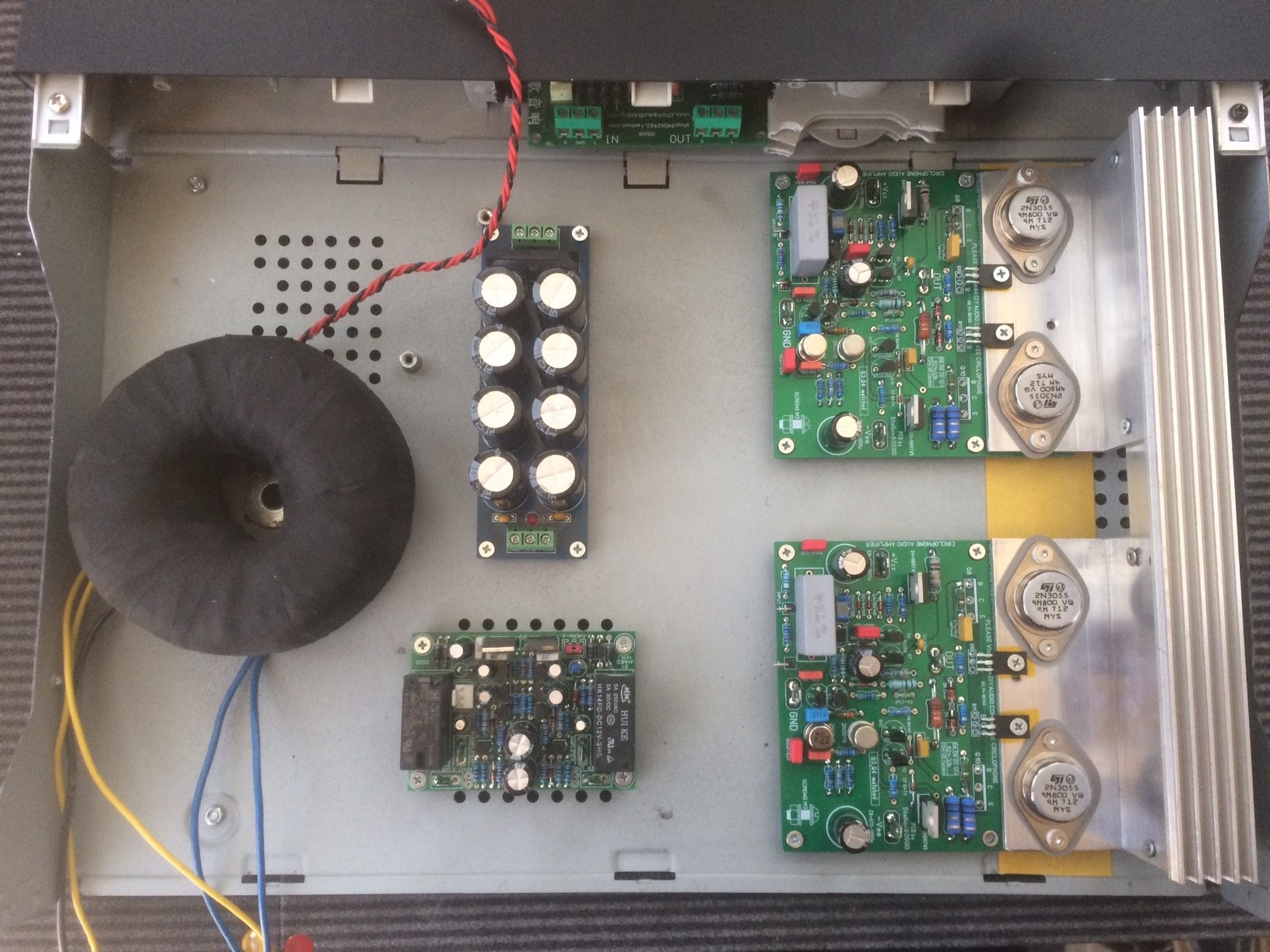

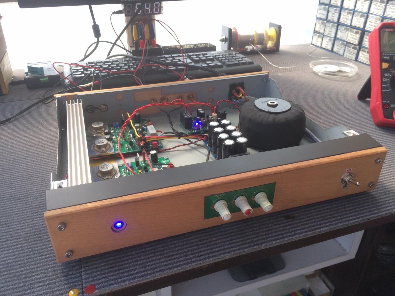

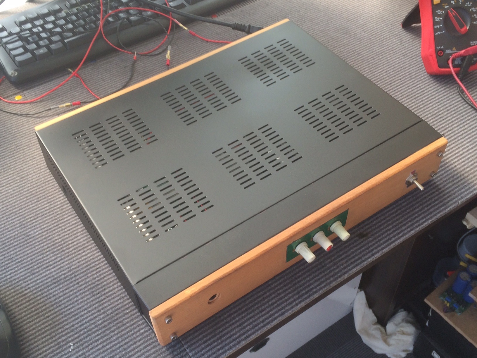

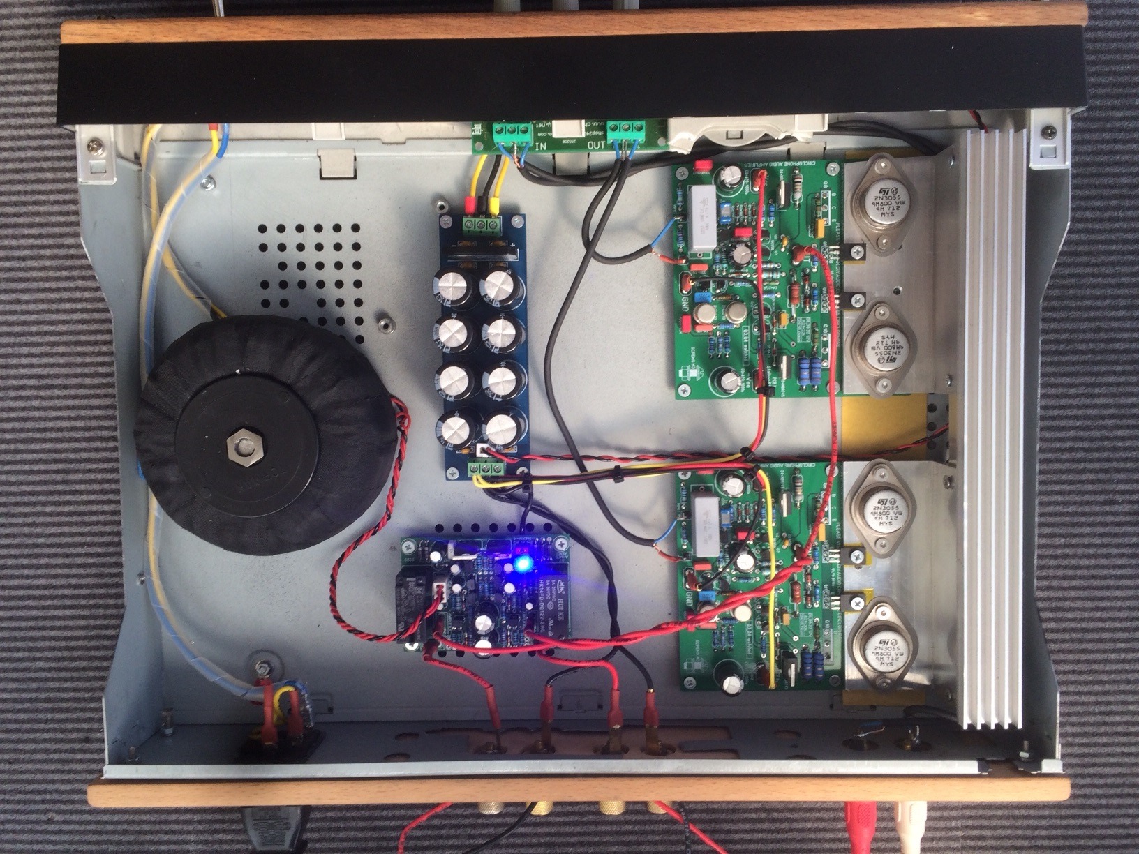

Hello everyone,
Finally finished. Nice work. Beautiful and detailed sound. Thanks to everyone who contributed.
2*25v dc
passive tone control

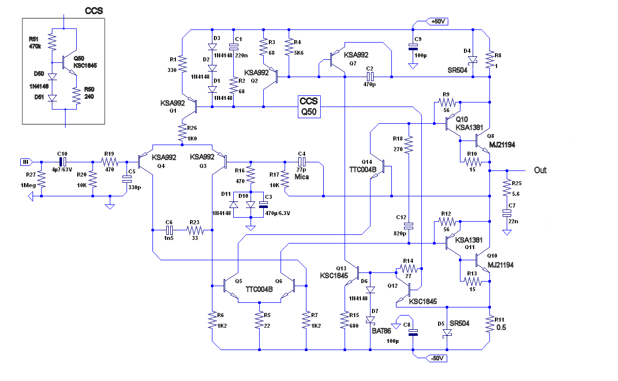

Welcome to Elvee's Circlophone thread. Congratulations for nice and beautiful build. Please share technical performance parameters and the passive Tone Control circuit for the benefit of boarders. It seem you have used 2N3019 in VAS.
The build looks professional in build quality.
Please share your experience of audio quality.
I'm glad you like it. I used 2n2219 as there is no 2n3019. However, they get very hot. I bought the passive tone control board on ebay years ago. Prepaid card. I like the sound quality very much, but the sound gain seems a little low. It may be caused by the tone control circuit. I just finished the circuit. I will write more detailed information in the future.
Have you used 2N2219 or 2N2219A? Vceo of 2N2219A is only 75V and that of 2N2219 is only 60V. This transistor is exposed to full rail voltage in the schematic and in your case 25V+25V=50V which is very high in your case. Vceo of 2N3019 is 80V. I think this transistor is not suitable for the present schematic and may lead to possible failure. You have to use ring heat sinks for this transistor.
It will be better if you request Mr Elvee for his comments on this issue.
