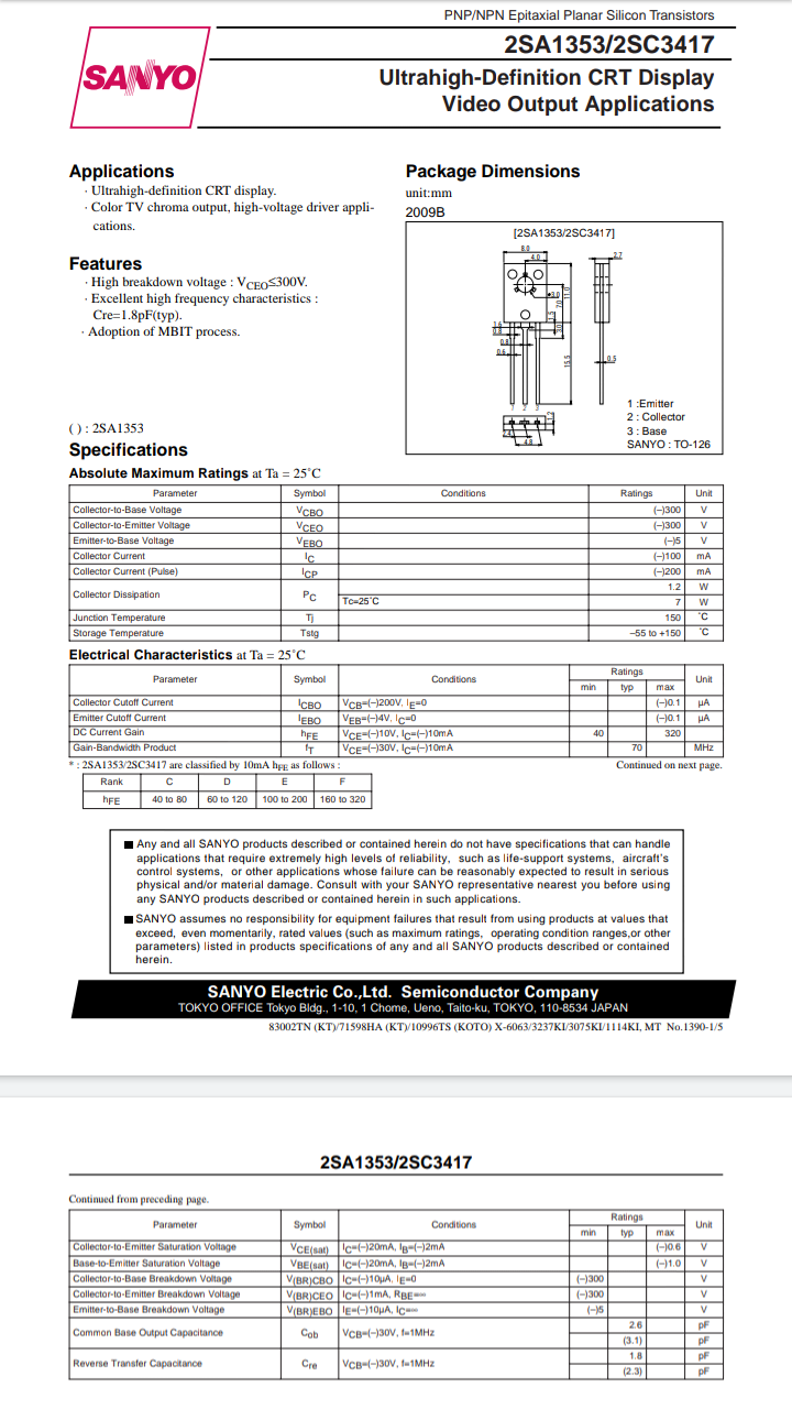

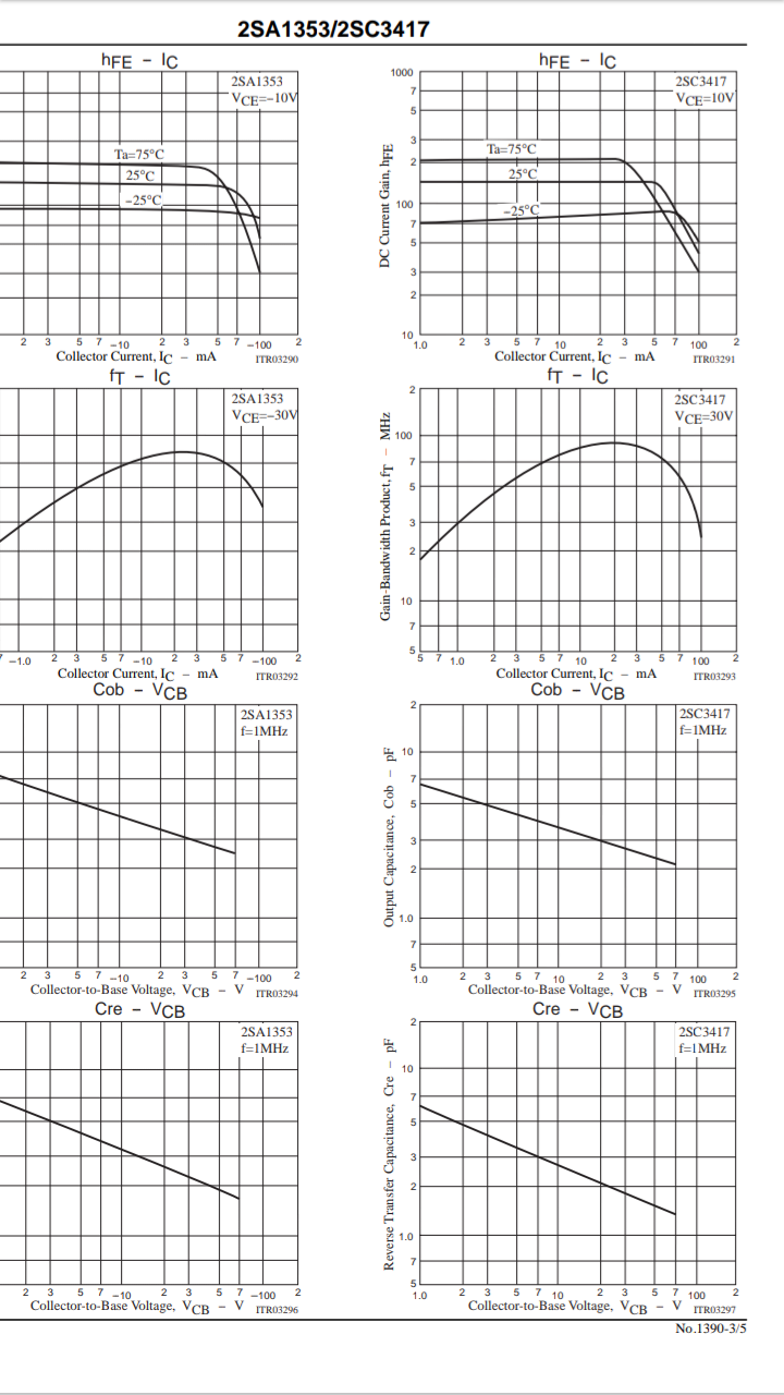

If you don't know Sanyo made some excellent transistors for voltage amplification stage (Primarily for HI-End CRT tvs), like 2sc3955 (Ft-300Mhz typ).
At 20ma the unity gain bandwidth of c3417 is beyond 70Mhz! Cob- 2.6pf typical. Which is very good for VAS. So that part is not only good for me but desirable for many! OTOH the beauty of Circlophone is it doesn't require such hard to find parts & has all the goodies of Class-A.
Anyway we are here to discuss & to help each other. I don't have an EE degree & completely newbie as well. If you don't have anything to contribute then don't pollute this wonderful thread by your gibberish. thank you, have a nice day.
If it wants 10 pF, it will work better and have lower high frequency distortion if your transistor has 2.6 pF and you add 6.8 or 8.2 pF polystyrene, COG or mica in parallel than if your transistor had 10 pF. Lower Cob = better VAS. You just have to get to the right value, somehow.

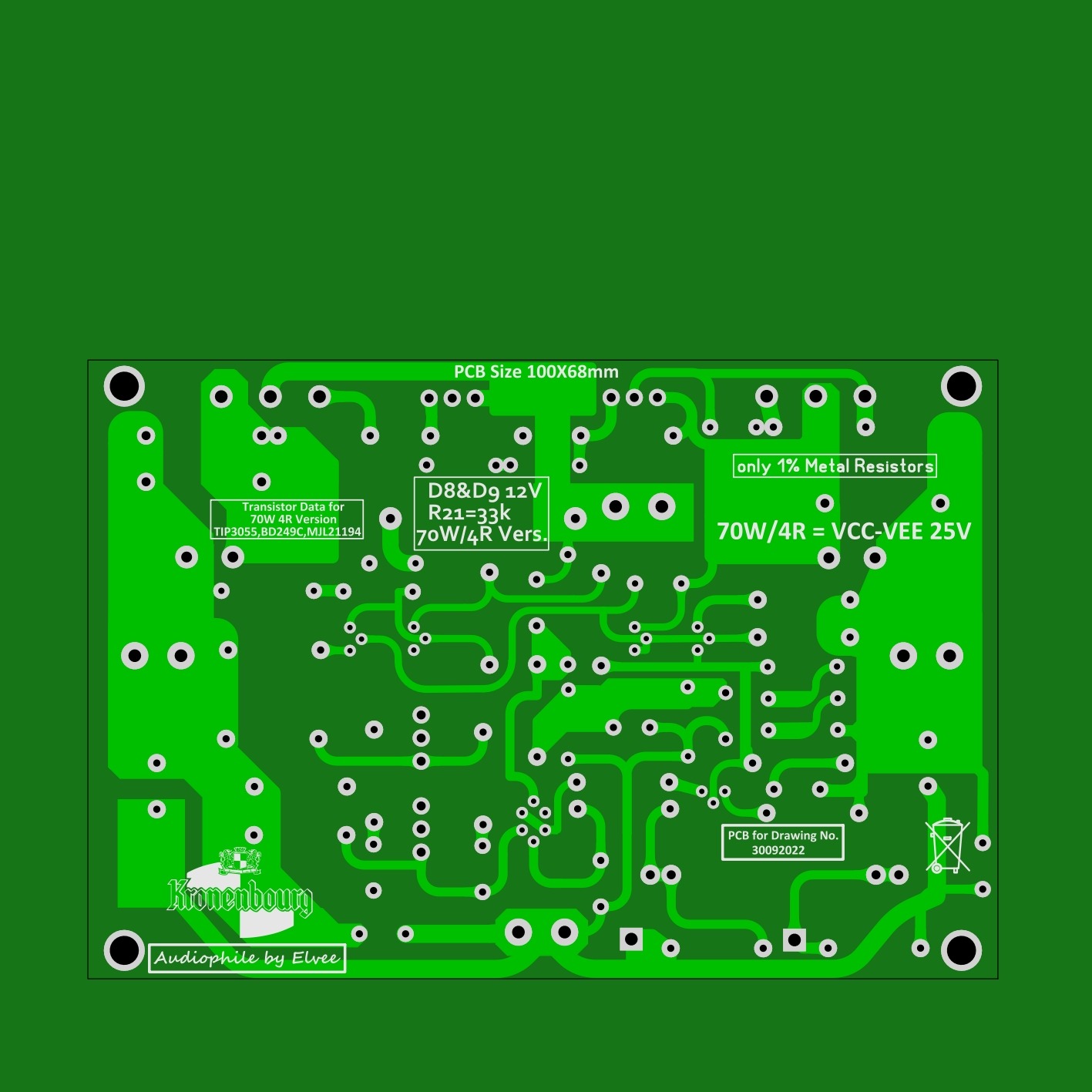

Dear Community, Mr. Elvee,

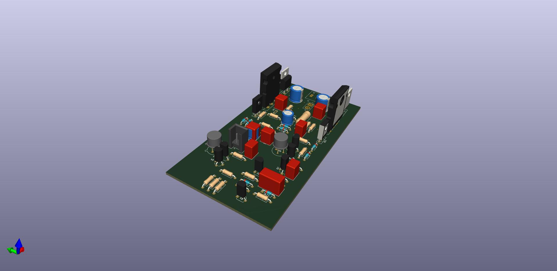

Well, this thread is massive, phhh. Couldn't find any KiCad files available... so I made it myself. Attached another PCB done to death. The PCB is designed for milling. With 0.4mm V-Bit. The 3D file is supposed to have the BJT underneath of the PCB to the heat sink and PCB on top. I like PCB to be more rectangular and not so wide.
BUT I think I made a mistake or not? Well, why not go with the Zenerless Circlophone.
There is several examples, especially Post #579/1905 and in particular 1743 As-Built by minek123
So small question, post 579 containing two examples witch is better or some-same. left example or right example?
Post 1743. Mr. minek123, have replaced the D8 and D9 with Q14. any toughs about this or should i just go with original as post 1.
is there any benefits with CCS and no Zener. the voltage will probably not fluctuate at all. will use active power supply by Tibi in this forum.
BTW, just to mention, I will of course share all KiCad files. but this is just rev A. need to fiddle around somewhat. if you need now-now just PM me. but it is Rev A / Brgds / Mikael

here is a photo. surprisingly nice quality. Although pcb is single sided , they used soldermask on both sides.
PCB power: good quality pcbs but costly.
It would be nice if the input pair Q3 & Q4 were facing each other instead of back to back.
So that we could use the HFE matched pairs fused to each other to main equilibrium.

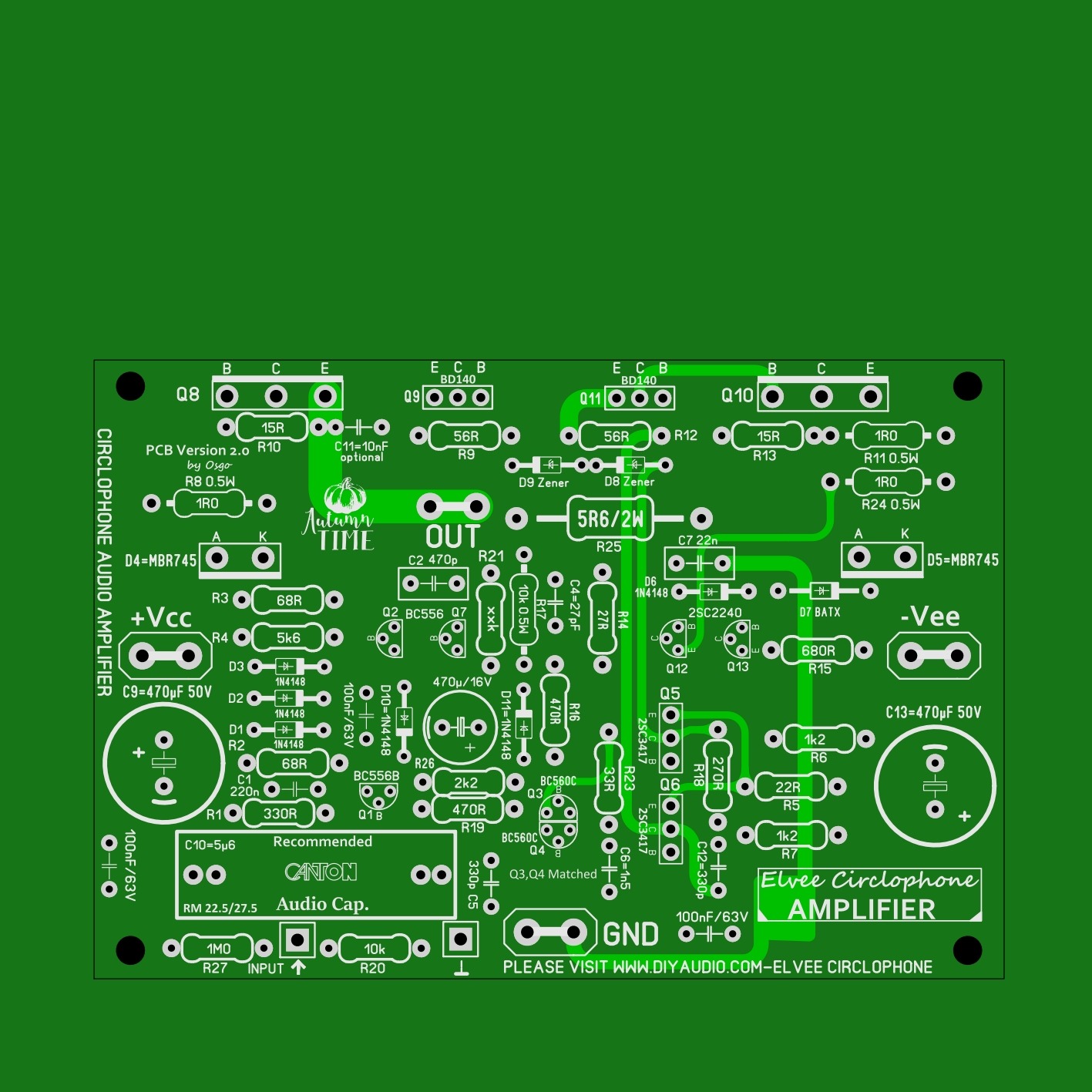

hello @oscargolf , great looking PCB!a new version of Circlophone PCB
let me know if you would like the modified "gronenbourg" logo (similar to elvee's avatar).
I made a vector graphic version of it and can export any file format (SVG, EPS, PDF, DXF ... )
shouldn't be a deal breaker. you may do it like belowIt would be nice if the input pair Q3 & Q4 were facing each other instead of back to back.

I feel the board could be smaller or we could add the below points with the same size board.
also the output track could be artistic like the rest of the of the board. Sorry 😞 I don’t mean to sound a broken record. Nor make enemies.
Just some thoughts from a lazy guy
1) add 20*5mm fuse holder
2) give little more space for heat sinks on2N3019 replacement transistors
3) make space to keep the zobel on board and the inductor vertical mounted to save space.
4) may be also bring the protection board
on it.
5) Q5 Collector track going to the output could be a bit larger and away from the border

Why smaller than 100mm x 68mm?I feel the board could be smaller or we could add the below points with the same size board.
on it.
Sorry my bad - I read 86. ( I am dyslexic).Why smaller than 100mm x 68mm?
Thank you for updating 😊
