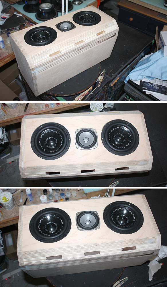

Wish I understood what "FAST" meant.
A 2-way with a low XO -- driver centre-to-centre ideally less than a ¼ wavelength of the XO frequency. Some pictures:
Alpair 7.3 + Alpair 12pw in ML-TL MTM (XO @ 250 Hz):
Alpair 7.3 + sealed SDX7 (XO @ 160 Hz):
Early pictures of a stand mount MTM w FF85wk + SilverFlute W14 (XO ~ 350 Hz):
One we are working on -- we stole the drivers from above, woofers in ML-TL:
The possibilities are enormous. Lots of good small FRs. Lots of good mid basses (and you won't be using them where they are at their worst). And if you have 2 amplifiers line level XOs make things way easier.
dave
