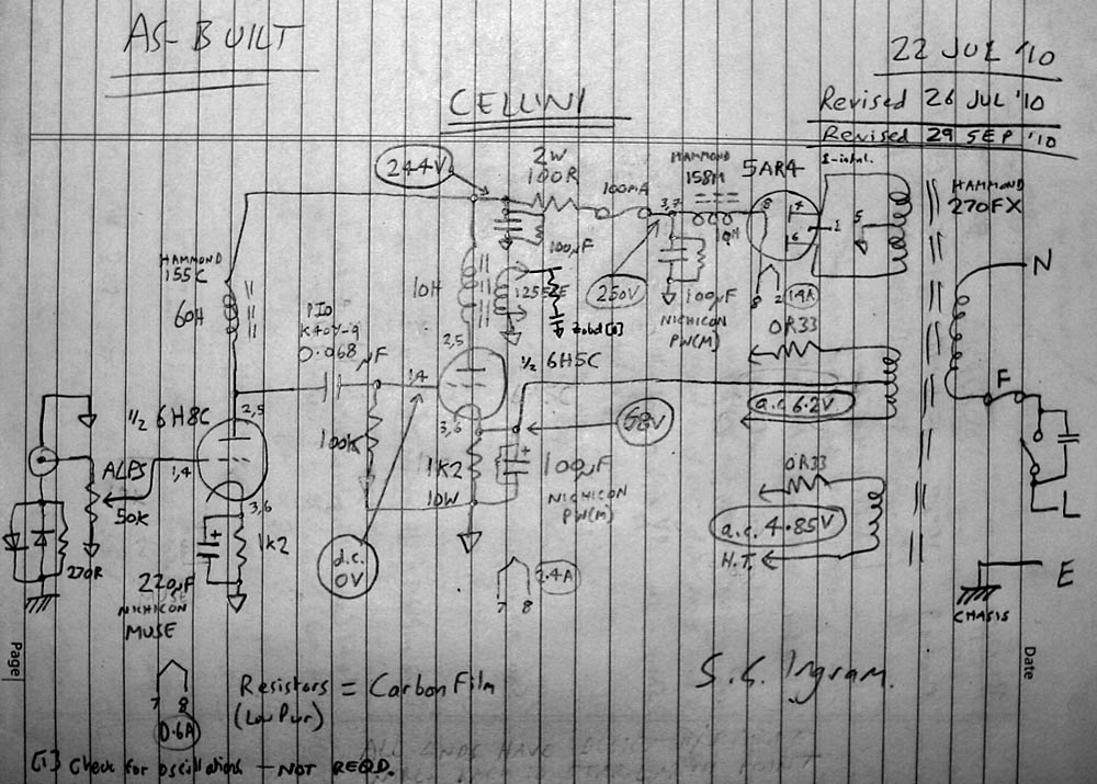

my CELLINI triode amp
I'm sure there's more to tube amps than the first one I've built, but my experience is a vote in support of the 6AS7 driven by a choke loaded 6SN7 (well actually it's the Russian equivalents to these tubes that I'm using).
I'll keep reading and learning, but I've never felt drawn to use the boutique tubes (2A3, 300B) just because they are so hyped but I believe many of these tubes (incl. 6AS7) are related by history ... I now have ten NOS russian 6C4C's should the urge to build again take root :D

Administrator
Joined 2004
Hi Gareth,
That should do the trick. I look at those diodes as a way to limit the dissipation of the resistor. So a lower value might work fine there. I don't think you need to change it now, that circuit is not critical as far as part values are concerned.

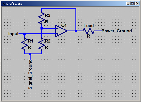

The amp compares two signals:
1: The input voltage to ground voltage.
2: The output voltage to ground voltage.
3: The difference between the first two comparisons.
Separating signal and power grounds totally splits these:
1: Input voltage to signal ground voltage.
2: Output voltage to signal ground voltage.
3: Difference of first two comparisons.
By this we see that power ground is no longer being factored into the comparison, and since power ground is the negative terminal for the speaker, any fluctuations in power ground will be added to the output signal.
For this reason I don't think complete separation of grounds is a good idea.
Am I right?
- keantoken

Hi keantoken,
No, the speaker return is not connected directly to the chassis.
The audio system "ground" (common may be a better term here) and the outside chassis safety ground (that is returned to ground potential) are often coupled by resistance. You only need enough to break any ground loops (reduce the circulating currents between two or more audio components). A total disconnection between grounds shouldn't affect the operation of the amplifier except for possibly radiating noise into the circuits.
Let's revisit your opening statement:
Statement 1. is almost true. The first stage of an amplifier amplifies the difference between it's common reference point (signal common) and the first amplifying device. For instance, in a tube amplifier, the input tube amplifies whatever appears between the grid and cathode of that tube. A solid state amp will amplify whatever appears between the base (gate) and emitter (source) of the first transistor. An op amp amplifies whatever appears between the inverting and non-inverting inputs.
Statement 2. is not true. An amplifier amplifies the difference between whatever appears between it's inverting and non-inverting inputs (just like an op amp). In the first case I was talking about the actual input device, but if you apply the same principles, the feedback signal travels through the opposite device and is presented to the input device through the emitter connection. Still works.
Statement 3. Well, loosely kinda sort of maybe. The feedback signal from the output is divided down by the feedback network. This reduced signal is applied to one input point and the input signal is applied to the other. Since the input device is set up to amplify the difference between these two signals, only this difference is amplified. There is no interim comparisons made at all, just a level reduction (without which the voltage gain would be 1, or 0 dB).
-Chris
The way I see it, every signal has two components, a reference and data wire. A receiving device compares the difference between the reference and data, and variations of both are ignored. When we measure output voltage, we must measure it against a reference, most commonly power ground. If we break signal and power ground, the signal ground becomes the reference for the entire amplifier. So if your source's ground increases by 1V, so will your output voltage, because power ground will not follow the signal ground voltage. Not only this, but power pulled from rails and into the load will force ground up or down, increasing supply-related distortions.
Am I still wrong?
- keantoken
If you do that, how will the power supply supply power to the amp? Are you confusing 'power ground' with 'mains earth'?
Compared to what, power ground or mains earth?
Am I still wrong?
I'm afraid so. Disconnecting signal ground and power ground causes the amp to stop functioning. Disconnecting signal ground and mains earth doesn't change anything to the operation of the amp (unless there are ground loop faults or so)
Here is what I'm imagining.
Whenever I mention breaking signal and power ground, I imagine a perfect world where input bias currents, offsets and DC don't exist. I speak in terms of the two extremes, totally separate power and signal grounds and totally connected grounds, because this simplifies the explanation as well as highlighting the fundamental differences between the two.
It is obviously not practical to separate signal and power grounds entirely.
- keantoken

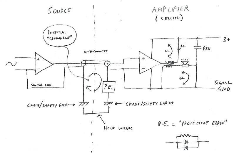

Thanks Keantoken for the good words on the amp. I'd be interested to hear more about your receiver (PM me) as I have one too !
The question about the source is a bang on the money. I don't plan to look at making a better amp than Cellini without considering the whole audio chain because the source maybe the weak link. But broadly speaking, what I gather from reading so far, there are key points in the chain where tube amps are believed to offer a benefit - and these points are where the electronics interface with the real world - transducers (the microphone/pick-up/speaker). It's a topic I'm not very knowledgeable of and probably deserves a separate thread to cover it properly.
In terms of there being a specific flaw in SS amps - I'd suggest this is not the way to think about it. I'd suggest that different amplifiers with their respective topologies, types of active devices, construction details and operating points each have their own pro's and con's and the skill of the designer shines through in how he/she makes all the relevant choices.
I'd be honoured to try out your headphone amp ! - but I don't have any high quality headphones. I may be able to borrow a pair, I'd have to ask around.
In terms of the questions over signal ground / chasis ground - see attached drawing. I try to analyze circuits from two viewpoints - 1) it's all about current flow and current flows in loops, and 2) all active devices are voltage controlled where the control voltage is a potential difference between two control inputs. I've represented an amplifier as a device with two control inputs as you suggest.
In the attached plot we see the 'system' and the reason for the resistor + back to back diodes to form a 'protective earth' (PE). The PE ensures that there is a path for dangerous currents to flow to safety earth in case of a fault whilst presenting a non-zero impedance to a.c. signals flowing through the ground connections due to induction in 'ground loops'. What I see from this is the need to ensure the impedance of the PE is linear or we have the potential to create unwanted noise currents that can produce voltage differences where they are not wanted (i.e. eventually at the input to active devices).
Now it's my turn to ask if I'm wrong or right ? (or have even understood the question!)

Administrator
Joined 2004
Hi keantoken,
In your diagram, you show the speaker return and the signal common totally separated. That will never work, although a tube amp can get close if it has no feedback from the output. Thats because the speaker load can have it's own little unreferenced loop, just it and one winding on a transformer. If you add feedback, you must reference the output winding to common as you are using a signal to allow correction. All signals must have a reference to something, somewhere. Hopefully a nice quiet one without much COMMON MODE NOISE. There's a hint back there that is the root cause of the ground isolation device Gareth made. Can you find it?

Hello Anatech.
In my diagram I excluded the necessary coupling between signal common and speaker return, and indicated in my post that total separation was not practical. However if you go back over my original statements replacing "signal ground" and "power ground" with "signal common" and "speaker return" respectively, does my argument fit?
In my original statements I don't assume a ground fault of, say, 100mA through the protection resistor (assuming no protection diodes), raising signal common 1V. In the case of a direct coupled amplifier, will the output offset not rise 1V?
