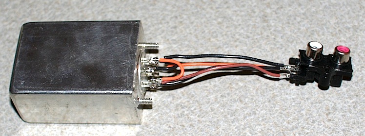

Well it's nearly two years for Cellini and time to review it and perhaps make some adjustments.
I have a pair of Hammond 835 transformers that can be wired to give me a 1:2 voltage ratio. This will give me a bit more gain - the amp has a gain of 1.8 at the present time.
I wired up a transformer this evening (photo on left) to try it out. And it seems to work quite well. The family said the sound was clearly more 'lively' - it is louder and there didn't appear to be much lost in sound quality. The freq. response of the transformer does imply some loss in the extremes.

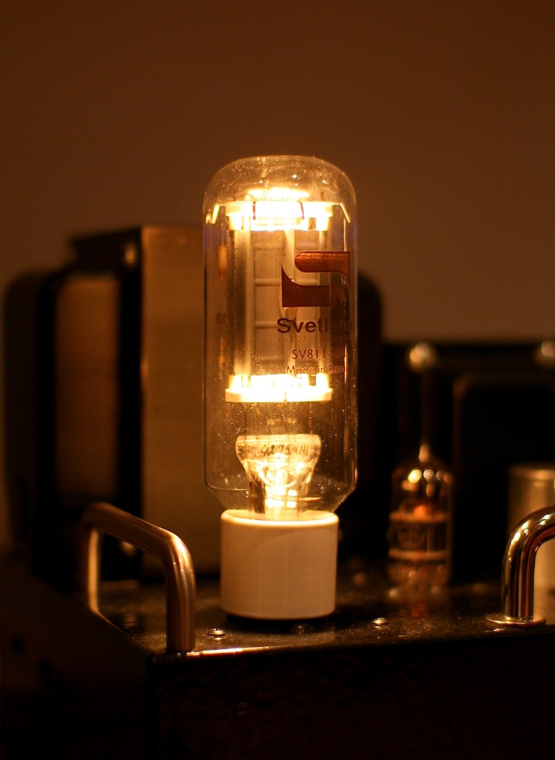

The other photo (on the right) was from a new amp a friend of mine just built and it reminds me why I like tubes :D
