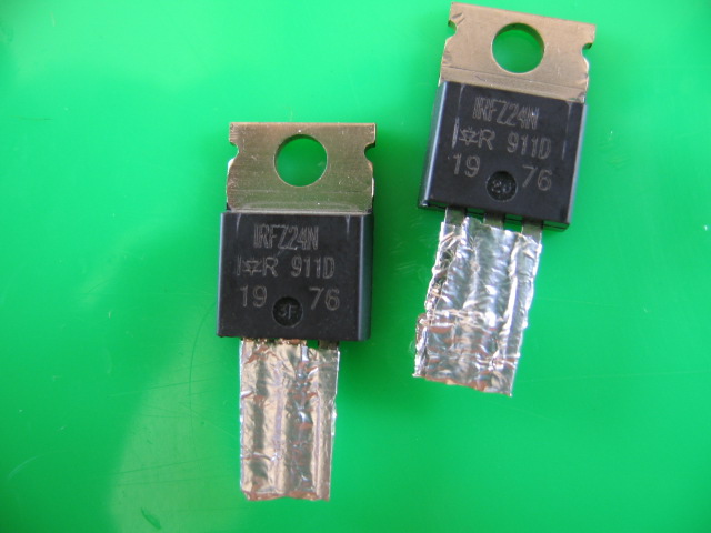

downtown area... had to buy IRFZ24N.... 1st store, got only 2 of them,ran out of stock.... the other store had MANY but was only IRFZ24.. no "N"..... have to wait for another set of IRFZ24N's.... those are the ONLY locally avialable "FASTEST" switchers I could get... but its (Z24N) specs are pretty much close (or better) than PHP18NQ11T (my model mosfet).. only drawback is its Vdss = 55V... thats WHY I lowered supply from
+/-48VDC down to +/-24VDC.... at least THIS diy UCD sounds much better than using IRF540N switchers..
my 1st channel has identical IRFZ24N... the other channel has IRZ24N and IRFZ48N..
power supply : +/-18V (+/-24VDC unloaded) @ 3A

last stock of IRFZ24N(here in tacloban) made by IR... part# is engraved...
