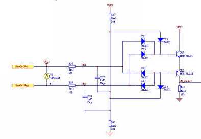

DC protection
heres a -BIT- of the DC protection circuitry found on UCD700 manual.... thanks to HYPEX...

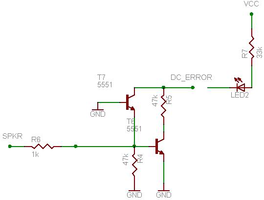

tested by me, although I added 1k(R6) at input because when input is DIRECTLY connected to Vcc or Vee results in: instant DEATH of 2N5551... DC_ERROR pulled to ground when it senses Vcc/Vee.... I added R7/LED2 as visual outputs....
uhmmm might be possibly applicable to OTHER AMPS...
this circuit should be incorporated in the POWER supply board... w/c its DC_error output is referenced(right term?) to Vcc...... MIGHT? be used as photocoupler to trigger shutdown circuit....
I really dont have any idea as to what/how its connected to the power supply(the DC_error output)....
might be an N.C. relay w/c opens up the supply line GOING to the AMP when fault is detected... etc.. etc....at least thats how I probably think it is...
need your inputs mate.. any ideas/suggestions welcome.. no matter how dumb/silly they are

djQUAN said:I don't think the output of the detector has enough drive current to light up an LED.
you can connect the output of the detector to the base of a PNP transistor that will then drive an LED.
try wiring up the said circuit... it can light up the LED.. EVEN with supplies of only +/-25V...
now whats the best way to instantly -cutting- power to the AMP??
a NOrmally Closed relay in between filter cap -AND- amp.... is what im thinknig BEST...
Add fuse to power supply and simply short the speaker output with a Triac. This option will not affect current path with contact and add no lose at all (except fuse lose) to the power amp. If DC is detected, simply short amplifier output to protect load and blow fuse on power supply. DC should never be there, except in case of amplifier faillure. That's the way I protect load on my commercial amplifier.

wow.. what a bold way to STOP DC at speaker..
short OUTPUT of AMP??? more damage done ...
I think I will go for MOSFETS as switches at outputs of DC supply....
nothing to "destroy" in case DC is/was present in speaker output..
btw, I saw PDF datasheet for UCD700 powersupply.. they incorporate relay/s at outputs.....
Im going the "solid state" way... If I succeed...

Normaly, when you got DC at output of an amplifier, damage was already done, ie mosfet are already blow and short. When you short output to ground, you will just blow the power supply fuse and protect a lot much faster the load again damage...

PS it's more important to protect load than minimize damage in amplifier...$$$$!
